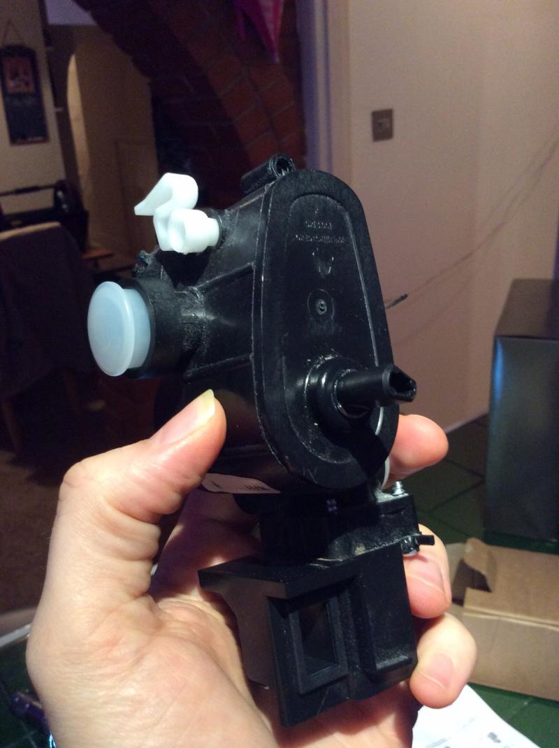

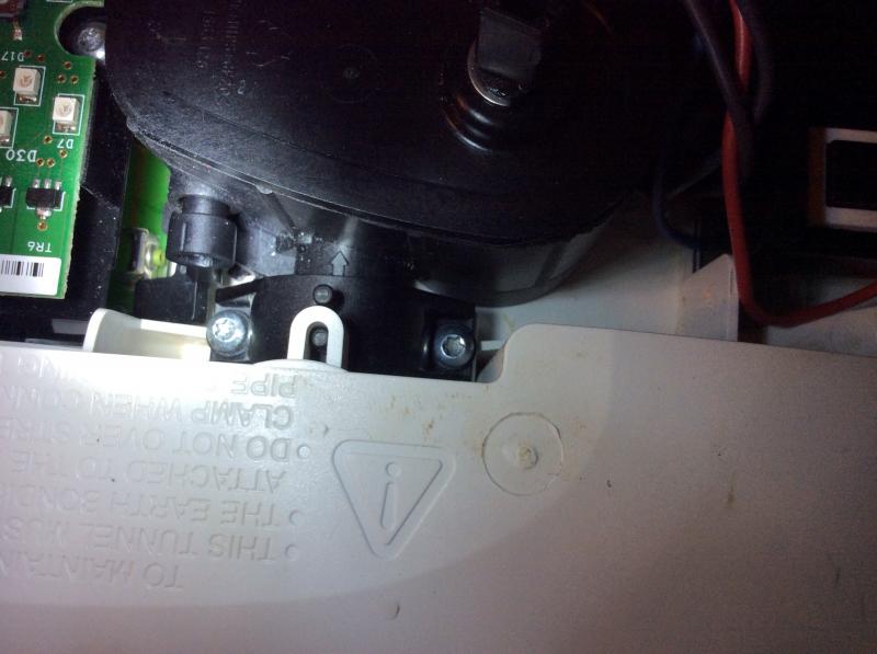

PS I've also noticed a little button on the underside of the pcb, the old flow valve assembly had a little plastic 'horn thing' which sat just under it (and may have pressed it?), the new flow valve is the same in every dimension except this bit, which is offset slightly to the left and will not touch the button on the pcb. Anyone know what this is for? Could this be the problem?
This is the where the bit from new valve unit (nearly) connects with the pcb, sorry no idea how to rotate the image:
This is the old one:

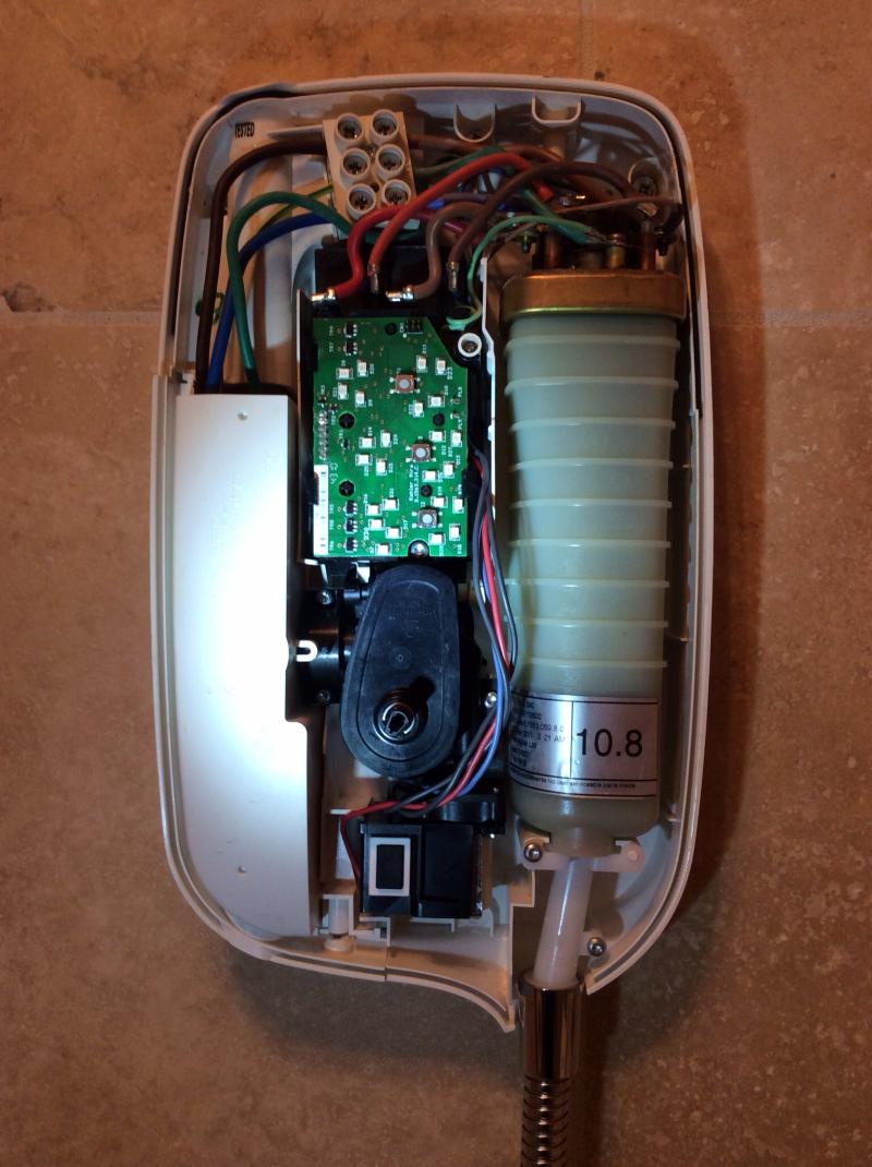

And the whole unit:
