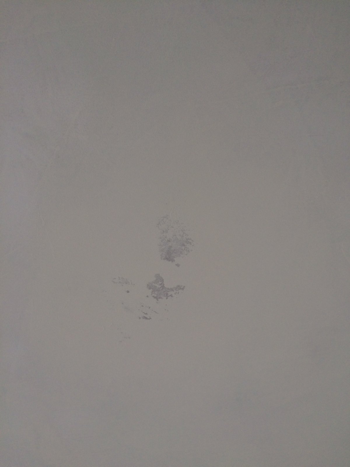

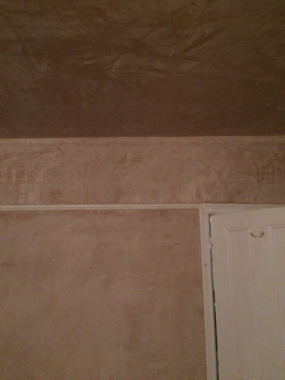

I've had a bedroom plastered (ceiling and Walls). Finish didn't look great, but plasterer came back and said it should be fine when painted.
Done a mist coat on all of it today and there are patches everywhere that wouldn't really take the paint.
When I tried a second mist coat later it took whatever paint with it so abandoned that and found in places the paint just comes off in my hand.
I don't think it a case of it not drying out, but at a loss how to fix it/what the issue is.
Pictures below

I did about 60/40, but where the patches are I can just scrape it off while other places it is fine.
One wall that was just skimmed is almost perfect, but there are a couple of very small patches that won't take any paint vs the mess in the pictures
I only have one picture of pre painted room and it's a bit where the paint has mainly gone on okay - but how wondering if it hadn't dried out fully?

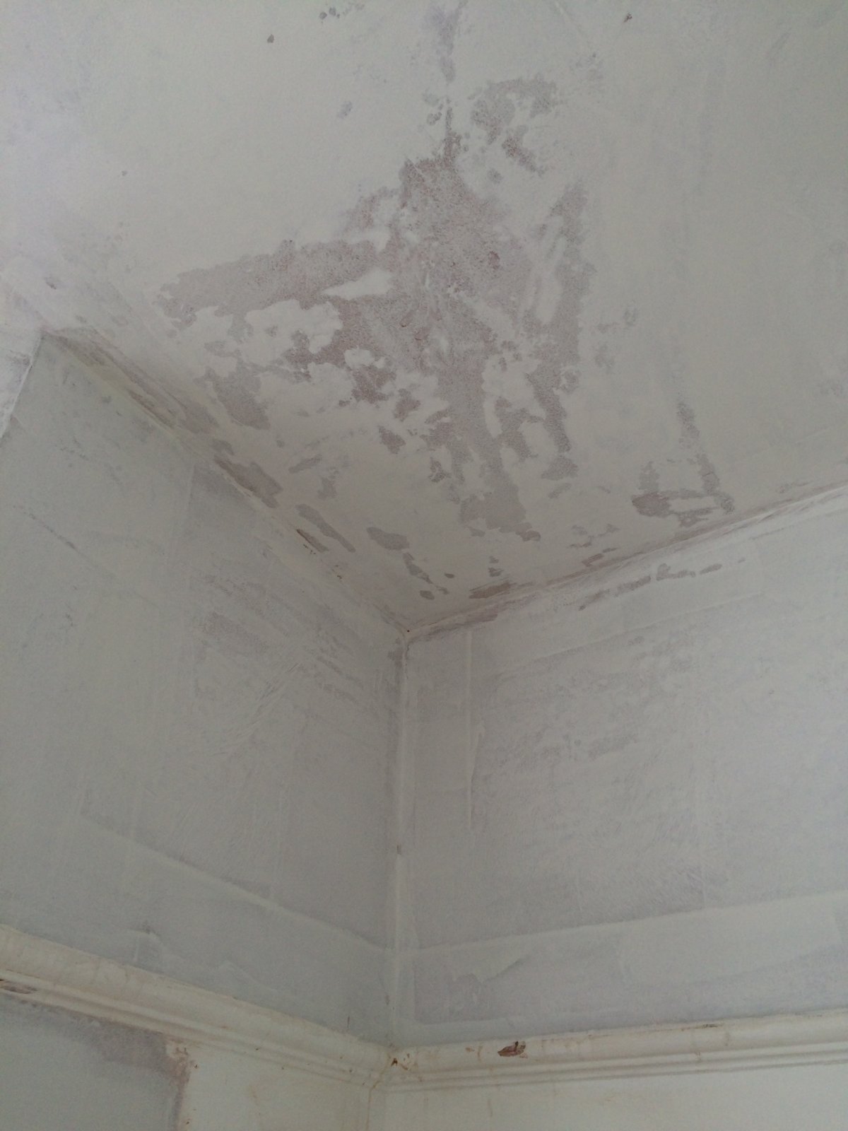

Looks bloody awful this morning. The very thin bit of paint on the patches no longer runs off, but won't take anymore paint

I can't think of anything other than the plaster still being wet.
Other possible causes such as silicone contamination seem unlikely.
BTW, there is no need to water down the paint that much. The small print on the tin probably recommends something closer to 10%.
Could be pva coming through the plaster or it's just been over trowelled making it glass like and impossible for the emulsion to bond. Try sanding it down and coating the bad areas with alkali resisting primer.
I did think about the possibility of over trowelling but it doesn't explain the tiny patches in image number 1.
Pva bleeding through is very likely here, either way, a sand down and some ARP will sort it out, done this countless times over the years for this kind of problem. Seen some painters use thinned oil uc but it's not as affective as the ARP, which is designed for problems with plaster.
