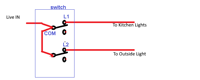

My point was to show you the switch will work properly in the way intended controlling two lights properly, and not in the way you suggested:
3 terminal switch ie 2 way, is to have one or the other lights on
And to provide an internal wiring diagram to show how it works.

My point was to show you how the switch works in the way intended and not in the way you suggested:
Your drawing is incorrect for the original switch and I really have idea what you are talking about, do you?

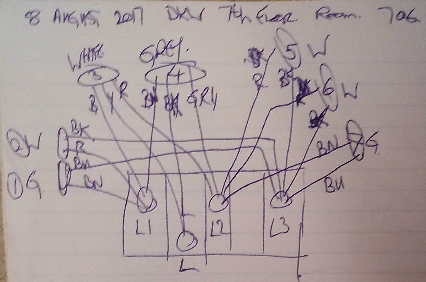

I can't beleive this job was 3 years ago but the resemblence with this 1G 2W switch amd Karens hasto be more than a coincidence:
