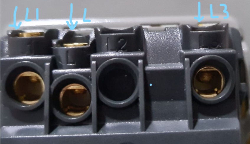

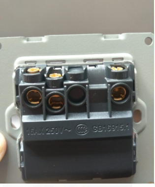

Are you sure? Isn’t it L, L1 L2 ??New one got L, L1 & L3.
Looks like L3 is far right terminal and L2 is blanked off TTcities ?Are you sure? Isn’t it L, L1 L2 ??

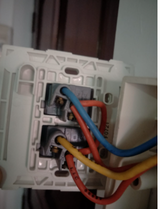

In which case, the red goes in L with the red link wire to the other L. The yellow and blue each go to the L1 terminals
