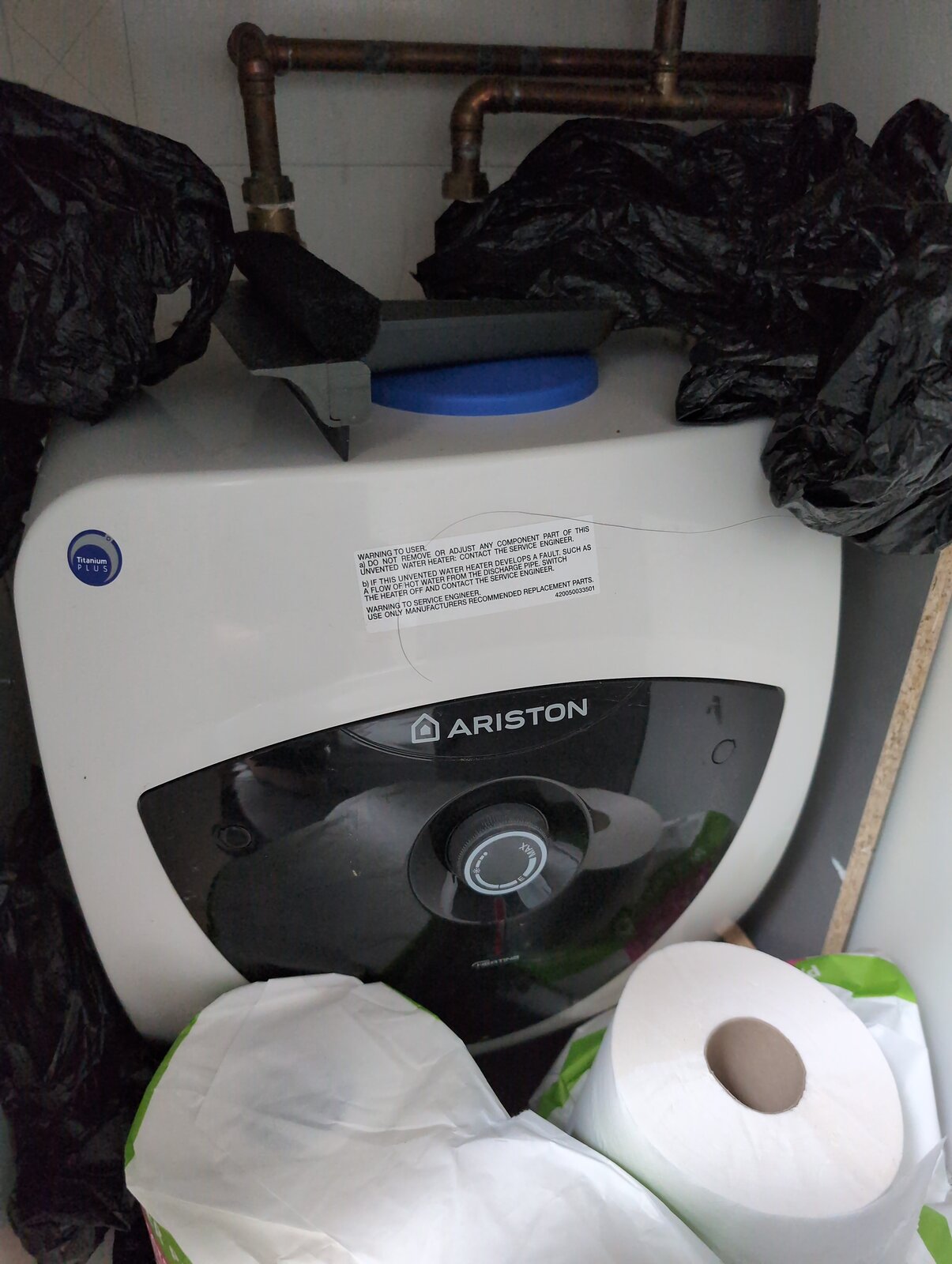

I don't have boiler so the hot water comes from the mini heater. I have attached an image of the heater

Can you start by stating what type of setup you have? Eg combi boiler, traditional type et al. Also, any isolation valves fitted below? If so, Have you tested these to ensure they’re open fully?
Has someone changed the cartridge in that tap lately ?
My money is on the cartridge being faulty or fitted wrong.

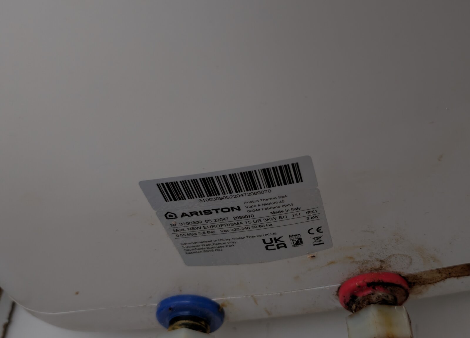

OP has already displayed his Ariston Titanium Plus water heater, but has not stated it's Kw loading yet. The reverse connected mixer does not bode well for the installation.
I don't have a combi boiler. I have a small water heater beside the sink. I attached an image of what I mean to the original post. The isolation valves under the sink are fully in the vertical position ( the one you need a flat head screwdriver to operate)
I have attached a picture of the label

Can you take the plastic bags off of the heater and re-do the pic. There is PTFE tape around the threads of the connections which invariably is a DIY red flag.
