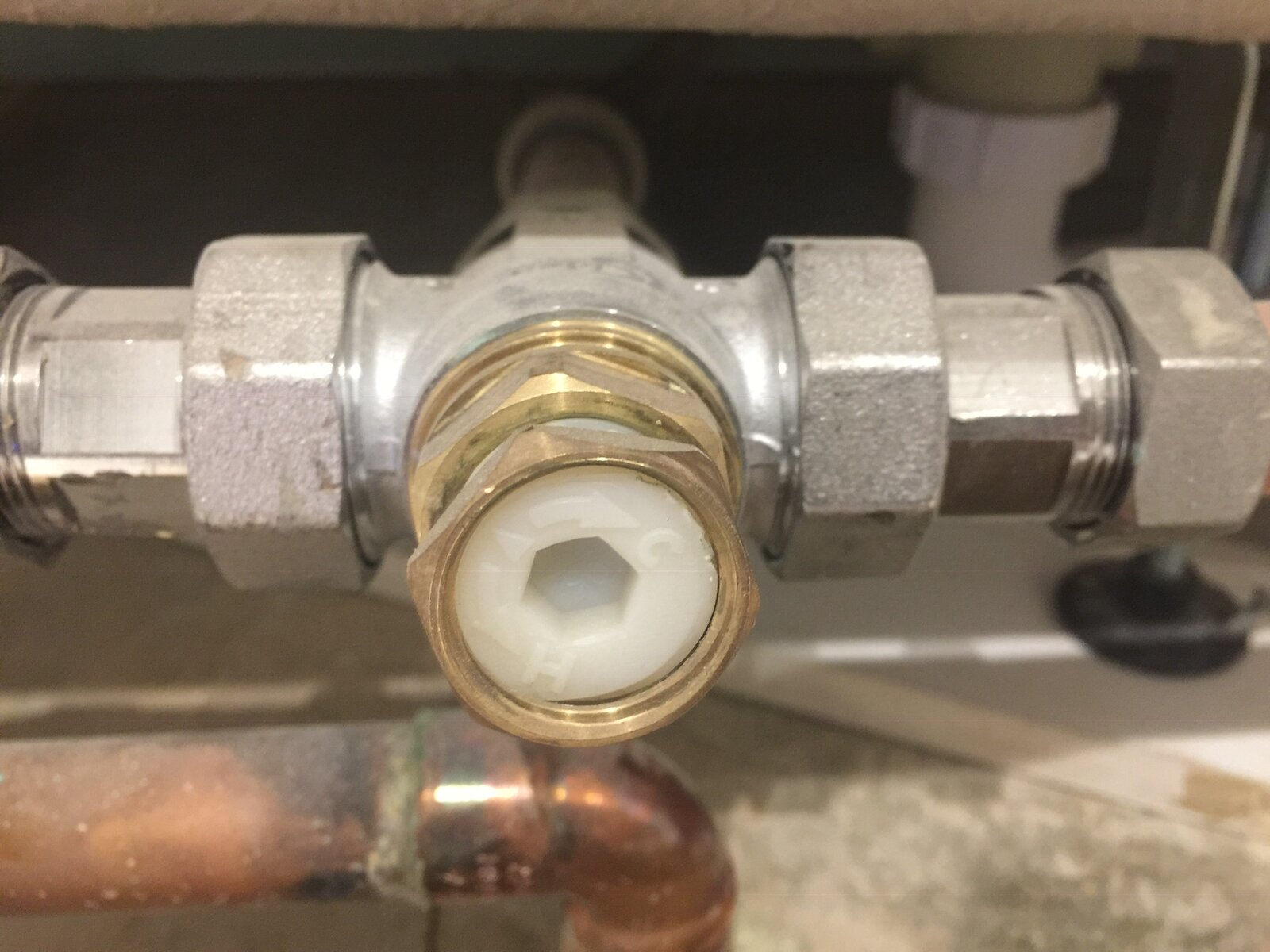

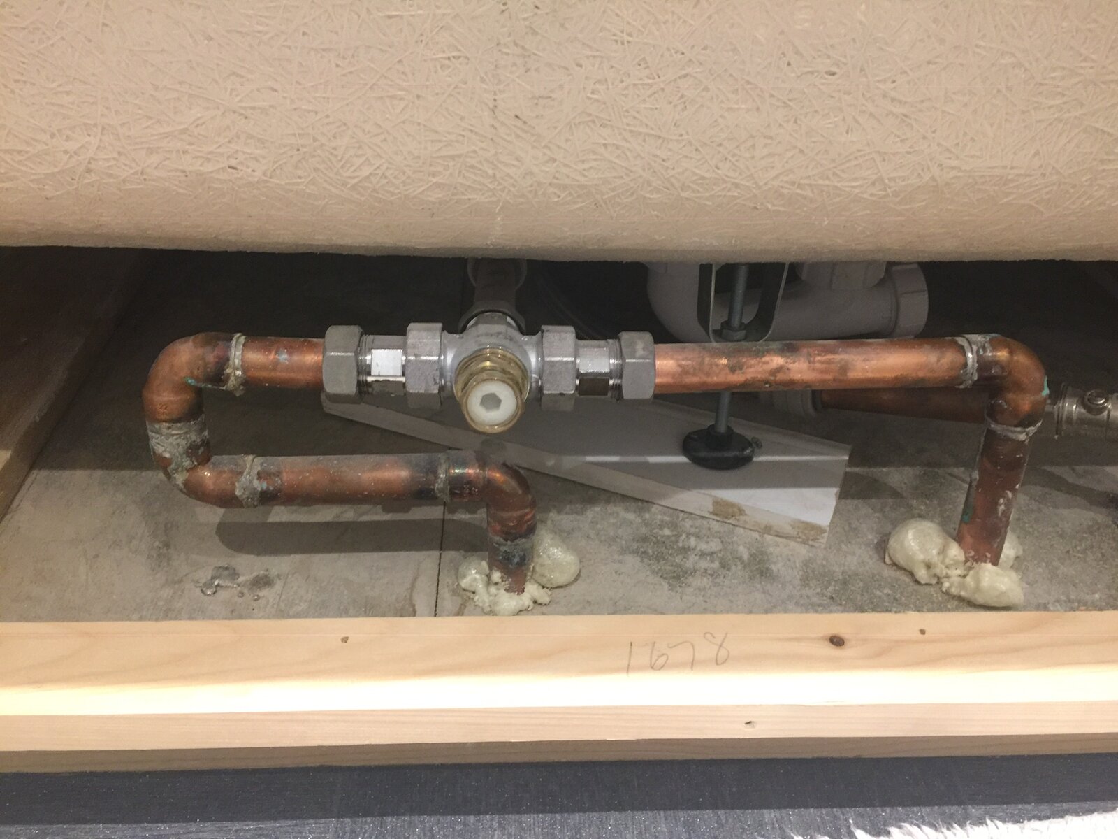

I’m just looking under my bath tub and have noticed there is what I think is an ideal standard brand mixer unit going off to the hot tap on the bath itself. The pipe on the right is the cold feed and on the left is the hot feed. The house has an unvented mains setup with a megaflo water cylinder in the airing cupboard.
Question I have is why is this on the hot tap for the bath - can you not just have a hot feed connected directly to the tap like I have on my sinks in this bathroom and in the en suite? They are all on mixers in the house so maybe it’s regs?

It's to limit the temp of the hot water going to the hot water tap to prevent people burning themselves normally used in commercial premises like pubs, clubs, shops etc
It's also fitted if there is a risk a vulnerable person could hurt themselves
They can be adjusted to make the hot water hotter by popping an allen key in the end and turning it towards H

From around 2010 it's been part of the building regs in England/wales. All new builds or any new bath installs moves/are now required to be fitted with a Thermostatic Mixing Valve - TMV2 ( TMV3 is commercial/NHS spec) - to minimise any scalding risk.

I think it’s just new builds or change of use, eg barn conversion. Don’t think it’s required for a house built prior to 2010 on a like for like. Although op’s looks like a new build - so required.

As part of the TMV2 scheme that was introduced into the regs in 2010 it is considered as best practice now to perform a risk assessment when a new bath/bidet/basin is being installed and the supply pipework is being exposed and there's ample opportunity to install.
Of course as a lot of the similar 'retrofitting like for like' stuff, it is advisory and not a legal requirement.
