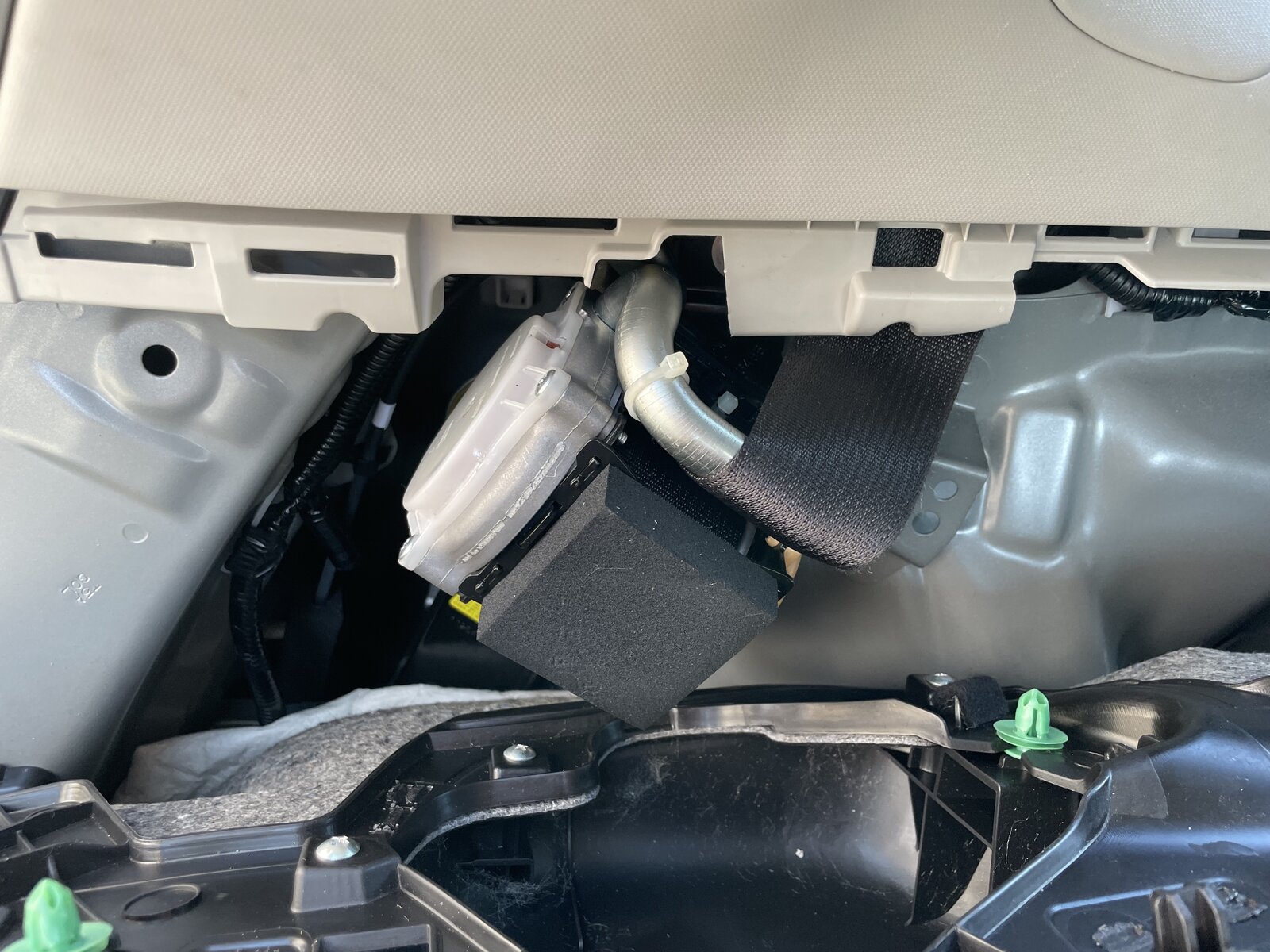

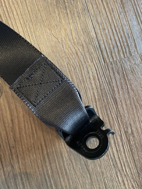

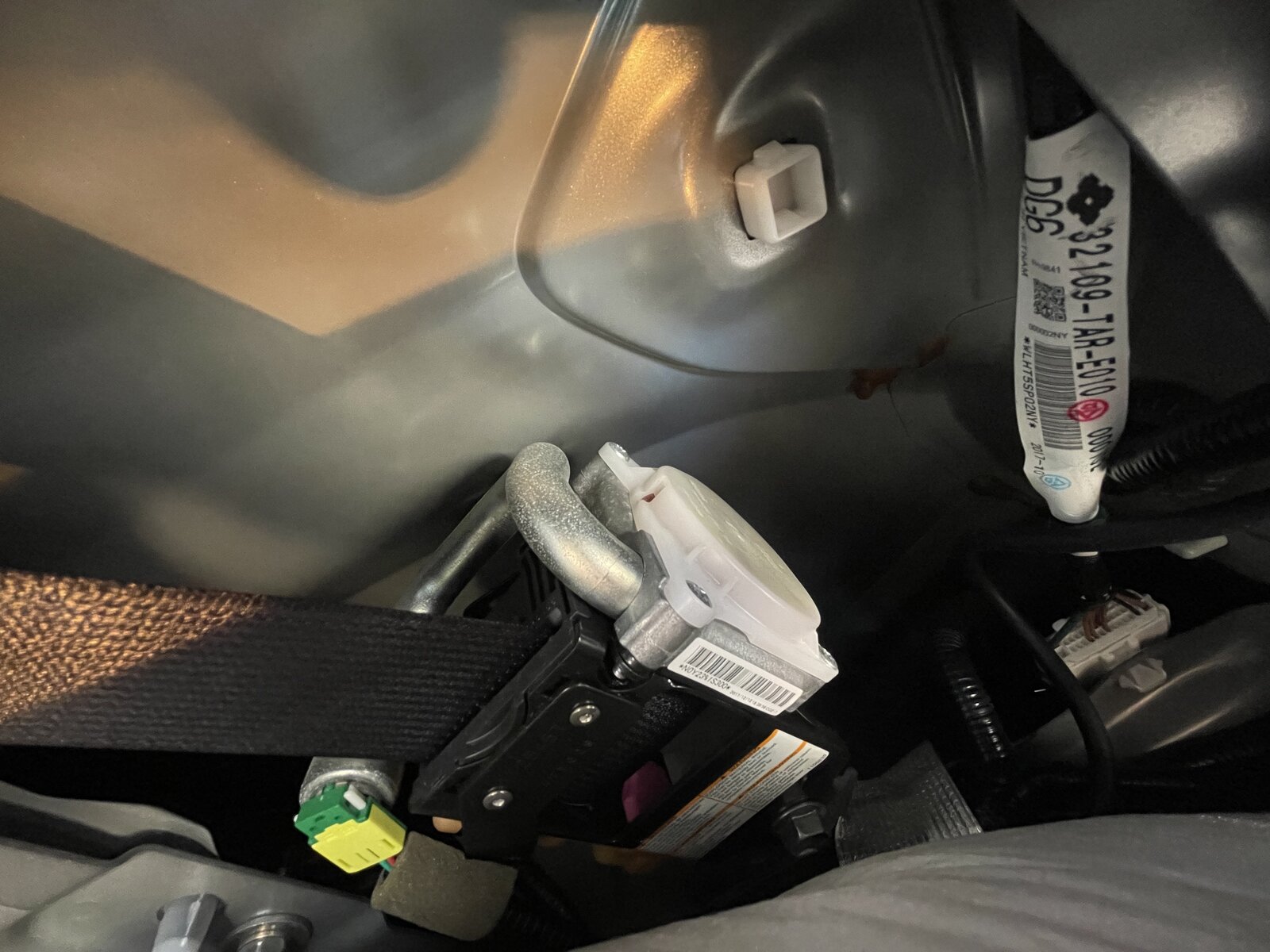

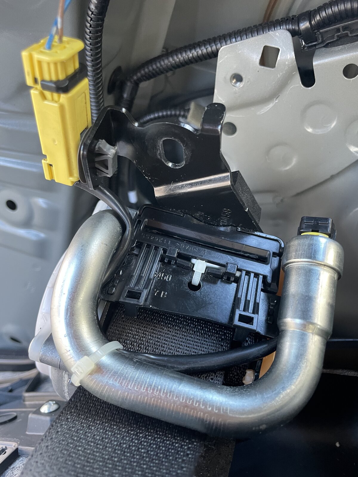

Modified seatbelt. Can it be put back?
I came to the same conclusion in my earlier post, and posted side by side pictures saying why not
EBay item 276935375019 appears to be more like yours, but it has a damaged belt
Perhaps find someone breaking a jazz that looks like yours and ask them for a price on the required rear belt
Yes, it is definitely not the part and I asked the seller for more pictures but they said they won't provide. And yes, that other eBay part is definitely it (identical and I even zoomed into the part number stamped and it's the same) but, as you say, it's already cut so not really a solution.
I presume you've tried and discounted a specialist like this? I don't know then, just a 30 second Google search.
I will give these and the other guys that were mentioned a call now. Been fruitlessly contacting breakers and either they don't have it (they seem to sell the complete set plus airbag as a package) or the only quote I've gotten is £180. If no alternative that will have to do, but want to check all options first

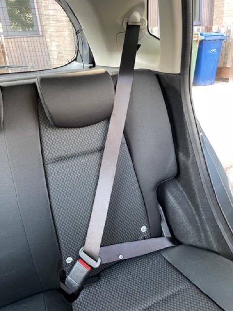

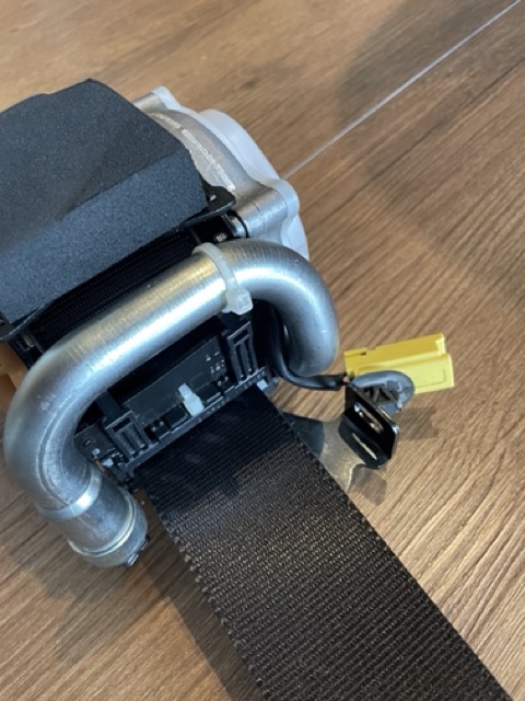

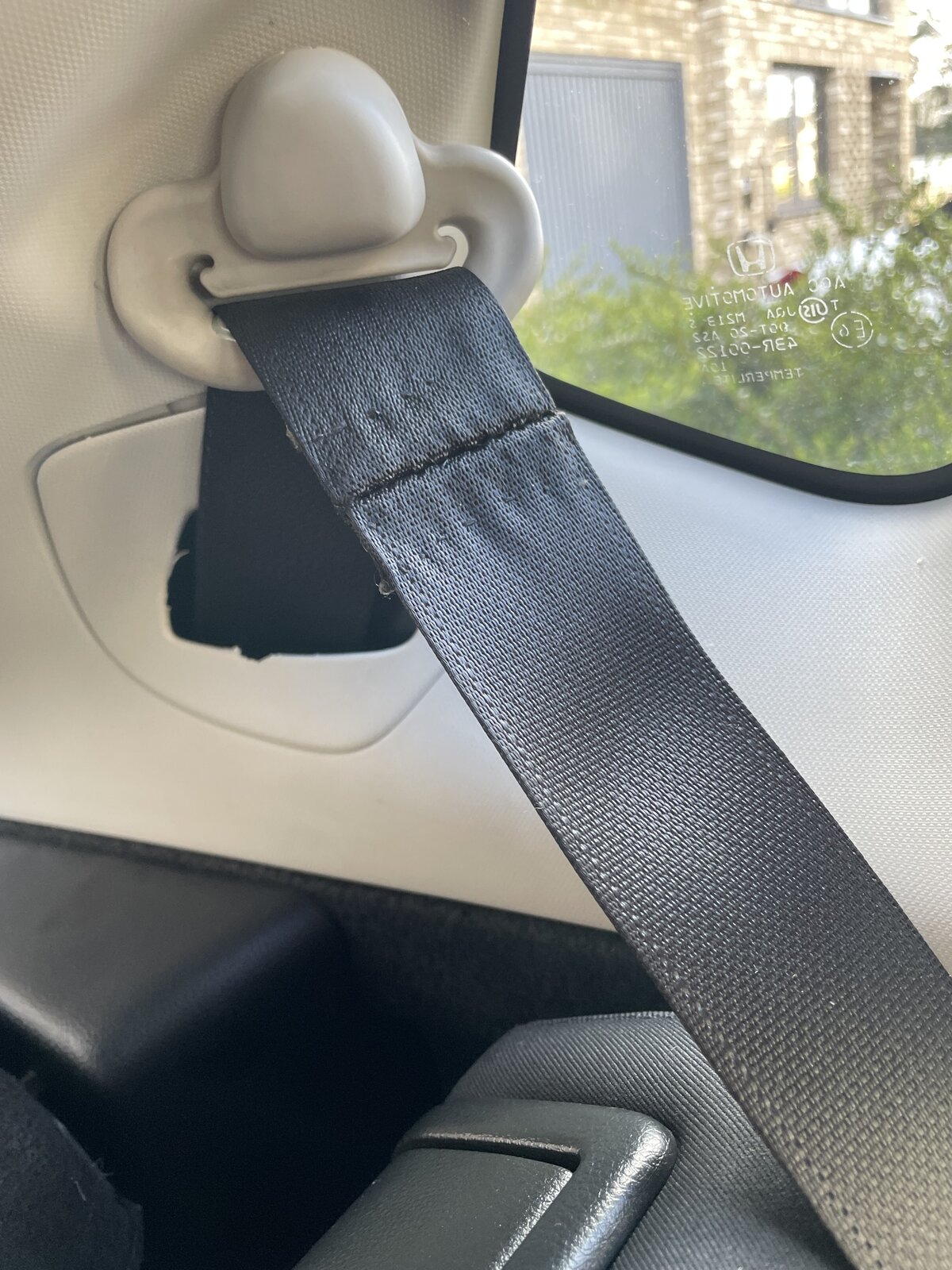

Thought that I would post about the end of this story as there was a fair bit of discussion and it might be useful for anyone who might be in the same situation and stumbles upon this thread.
I tried contacting all available breakers to no avail. Only got a couple of quotes for £180 and everyone else seemed to indicate that they sold the whole airbag system (i.e. airbags and all seat belts) as a single kit.
I therefore decided to give these guys that @cdbe recommended (Airbag Team). They charged £60 to replace the strap/fabric plus £10 to ship the item back. I was going to be away for a couple of weeks around Easter so sent it to them just before I left, asking them to ship it back only when I came back. Seatbelt arrived yesterday (the date I told them I wanted it back) and it looks very good - pretty much like new (see pictures below).
Very happy to have sorted this out, but also that I managed to salvage the original seatbelt, which other than that horrific fix was working just fine. As always thanks a lot for everyone's help and advice here. very helpful and, as always, learned a lot :)
