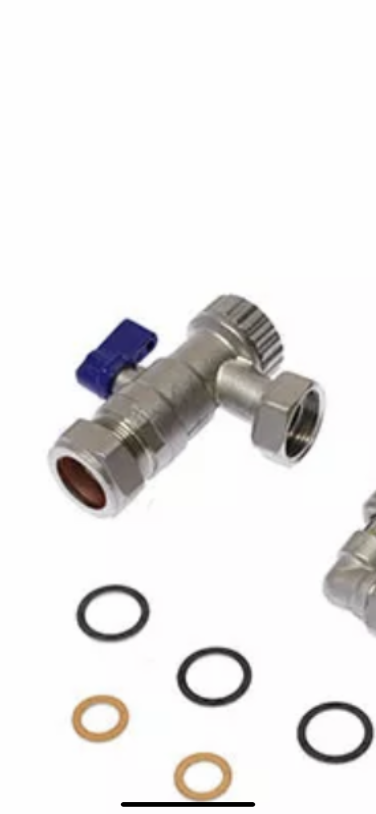

Do you have x2 thermostats on the walls? Do you have TRVs on all downstairs rads and have these been checked?
Hi
It only has the thermostat on the boiler, all trv's etc on all rads checked and working, the hot to cold happened straight away it was not gradual
Keith
And all lockshield valves are open?
I assume they are I think the heating engineer would know that bit ?
If the main hot water pipe sends hot water to the rads and then returns, would the return pipe be hot or cold if it is hot how does it miss the downstairs rads?
Keith
Keith
It might have been overlooked by the heating engineer. Flow pipe should be hotter than return pipe. It would miss downstairs on the principal that if the flow is open but return is closed, then there is nowhere for the water to be flowed to.
