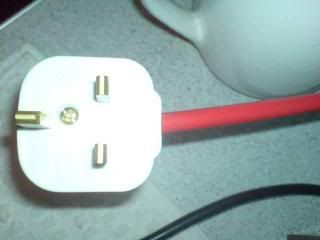

A modern take on a 1960's nightmare.
That's FP200 terminated into that plugtop...

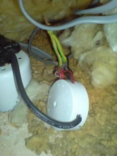

This is a DNO's scrappy attempt to feed the next-door house from it's neighbour... I wouldn't like my neighbour to have access to my earth connection...

I wonder what will happen to the neighbours supply, if one of those service fuses were to operate? - seems a very shoddy way to run a DNO feeder! :lol: :lol: :lol:
looking at it i reckon the end terminal with two cables is the neutral and probablly has a solid link fitted. The two houses then seem to have seperate fuses for thier lives.
Yeah, I thought it was shoddy.
The earth connection to next door is on a brass terminal block, not sweated, so could come loose. The fuse for next door is in this house - what if it goes open circuit? Plus there is an identical fuse next door...not good discrimination.
Also, there is a cold-poured joint under the lounge floor of this house where that split-con joins up with the paper-insulated cable feeding next door....
What a bull's-up!
