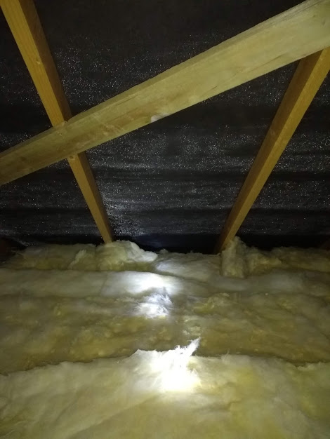

Mould growing on things in new loft
That amount of moisture must be coming from your
house somewhere! Are you sure that is a breathable membrane?
No idea about the membrane. I assume it is, how can iI find out?
Going to be a bit tricky now, I would move a few roof
tiles and find out what the specification is from the
writing on the membrane.

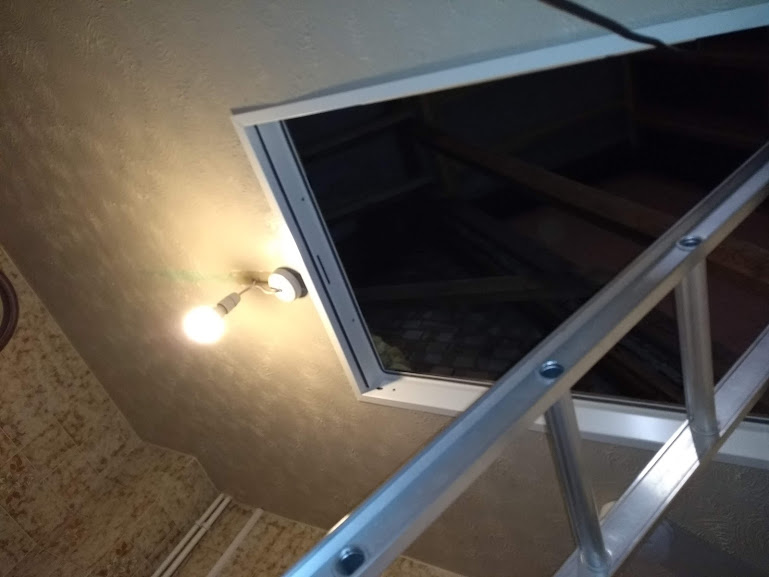

Shouldn't be anywhere near that temperature in the loft, if the humidity is that level and it's that warm there's definitely warm air leaking from your living space. The felt will be very cold as it's not the insulated layer, and even breathable will get wet in extreme situations.
I'd suggest looking for air leaks. If it's mainly closer to the existing loft and the loft spaces are open to each other, especially if the insulation is better in the new area you need to check all ceilings and even air leakage through stud walls into the ceiling void. Any pipe work or cable holes would be a suspect.
It did reach 13.25 degrees today, and the hatch was probably open for about half an hour before that pic. And that was right next to the extractor which was warm. The new loft is def much colder than old.
Ill sese up that extractor gap next and see if that helps.

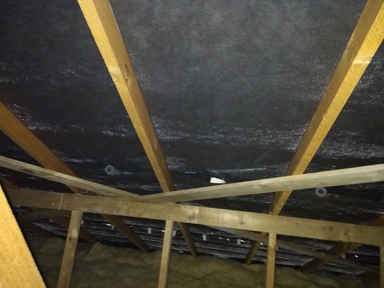

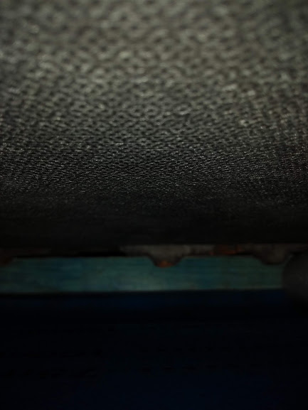

It is cold up there. I put the insulation back as that made no difference. Most roof felt is wet to touch. I did some Googling and discovered Felt Lap Vents - it seems I am not alone in this problem.

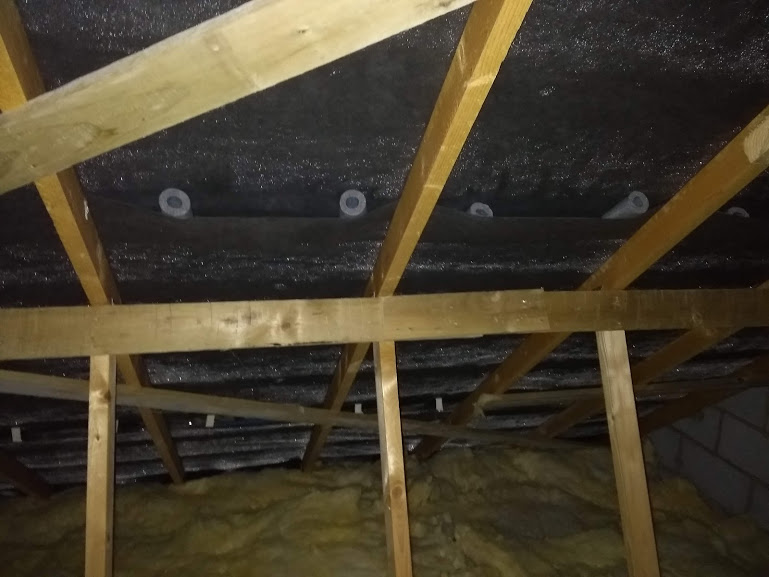

Inspired by that, I put in some makeshift vents using a combination of pipe insulation and offcuts of insulation board cut into wedges. Aim was to make tiles visible in each section to increase ventilation.
There are 2 types of felt membrane in the loft, one is grey and the other black. The grey seems drier. Maybe the black is not breathable.

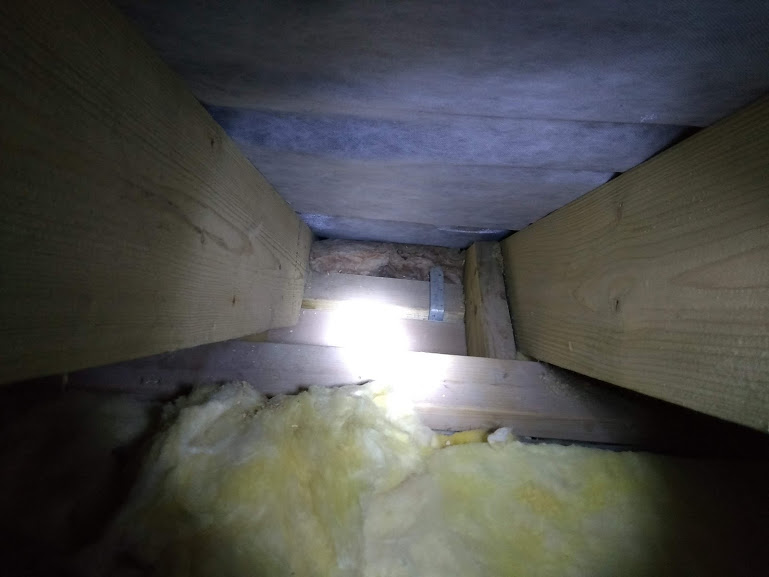

Also, no signs of ventilation in the eaves - no vents on the underside of the soffits. The soffits are plastic, so surprised vents not in there as standard. Should I get out my drill and put some vents in? Found these soffit vents.
Right, vent's have possibly made a difference. Added more vents (about 40 now) and got 2 fans blowing up there to try to encourage the air to move.

Eaves are packed with insulation, but there are no vents in the soffits so it makes no difference until some vents put in. I'll get vents put in asap.

More photos.
Daylight!
Blocked insulation in eaves

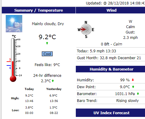

Loft and outside weather update

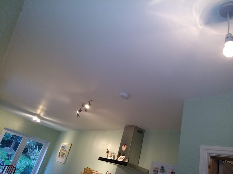

you don't have downlighters/spots?
wet-felt-jpg.155360
also known as "holes in the ceiling so warm damp air can rise into the loft?"
No, none. Too expensive and a PITA to change the bulbs!
the kitchen and hallway ceilings.

Why are you doing these modifications to improve ventilation to the roof space yourself ? In answer to your question, yes ,ventilation of the roof space is covered under Building Regulations and the Building Control Officer should ensure it has been carried out by the builder;so you should discuss what has been done with the builder and BCO. Ventilation is required at the eaves, with rafter trays to prevent insulation obstructing the airflow, if the roofing membrane is not breathable .(I think it is also a good idea to fit an air brick in the gable wall.) If it doesn't comply with Building Regs on ventilation the builder should rectify it, you shouldn't need to do any remedial work yourself. Ventilation at the eaves can be by an over fascia type of vent if there is no soffit.
