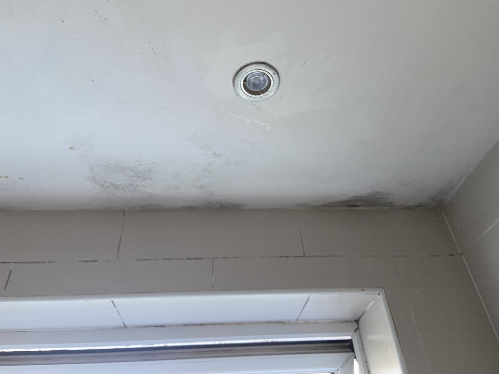

Hi
Edge of bathroom ceiling constantly showing black/mould stains. Have painted over several times but these always quickly return.
I’d previously understood it could be poor insulation at the edge of loft resulting in colder surface at that point.
It’s a conundrum, as deliberately left a few inches between insulation and eaves. Also looks to be adequate height at that point. (Also no staining at edge of adjacent bedroom)
Have extractor fan in bathroom.
Any wisdom would be appreciated.

Your bathroom is damp. Do you have steamy showers?
What sort of extractor do you have, and when do you use it?
The wall is probably cold. Is it a cavity wall?
Show us the eaves and insulation. You can get eaves vents that keep the channel open and allow insulation up to them.

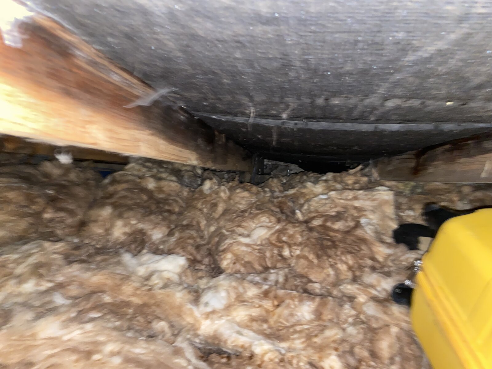

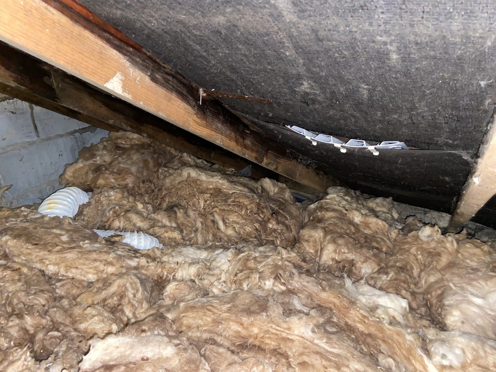

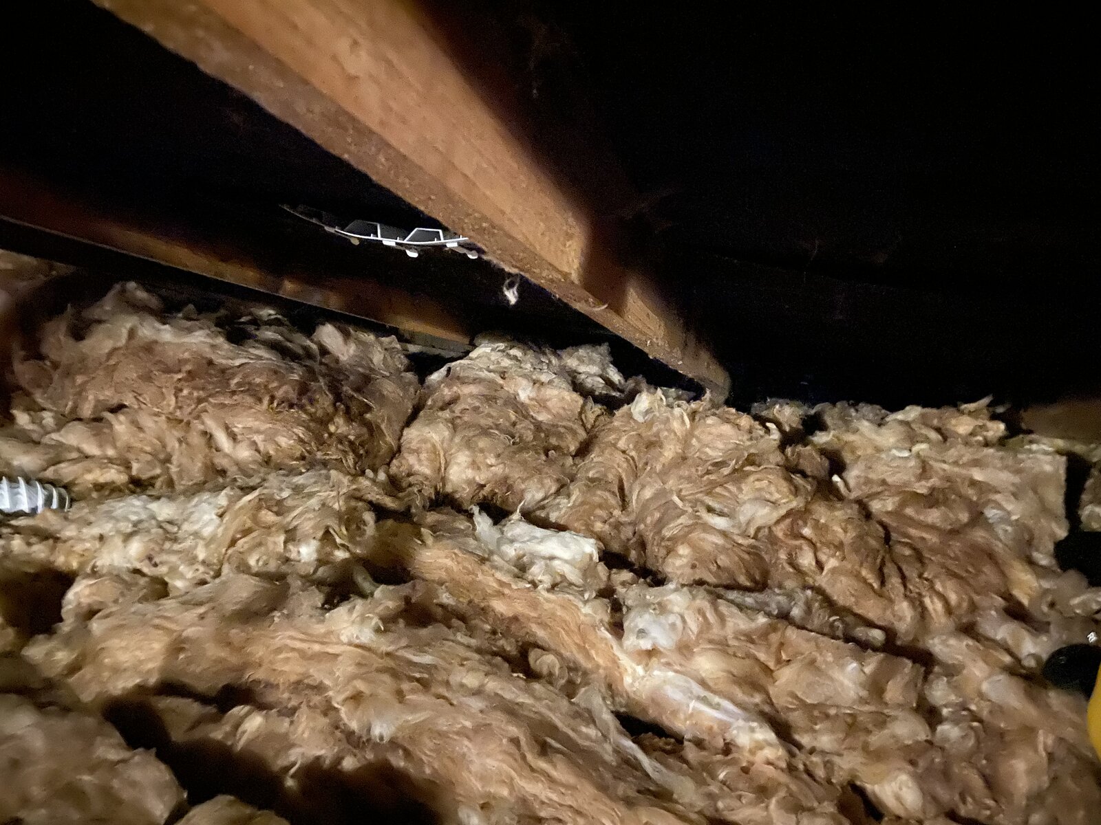

4. Photos attached. Bit of a conundrum. Need to leave ventilation gap but that risks colder edge of ceiling.

Show us your extractor. And the duct. When do you use it, and for how long? I think you need better extraction.
Example of eaves vents. They keep an air channel open and you can insulate right up to them. If you buy a new roll you can relay it better.
