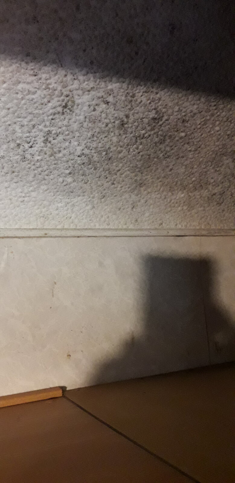

My upstairs bedroom's ceiling slopes slight around the edges because it goes up by about 12 inches to the loft space. As a result, the sloping part is not insulated properly like the flat part of the ceiling.
It gets cold and condensation forms resulting in mould growth on these sloping ceilings.
What is the best way to solve this problem?

Insulate the sloping bits by adding as much thickness of PIR insulation BENEATH and across the rafters. You'll need some loooong screws. (y)
Foam. Foam sticking kingspan on.
Insulation is what you need to raise dew point. Anything you can do.

Probably one of the most overlooked (as well as bay windows) as far as adequate insulation/venting detail, is concerned.
ensure there is adequate ventilation - especially at night because us humans exhale a lot of moisture, as as you have found it tends to settle on the coldest surfaces

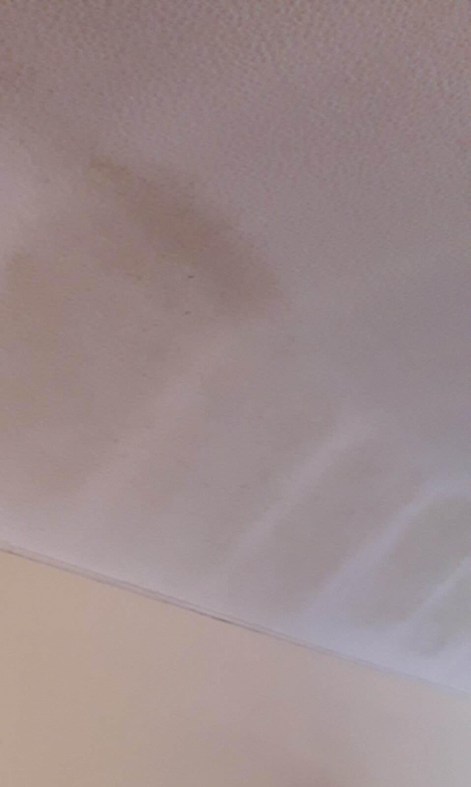

The house was built in the 1950s. Attached are photos showing the mould.

You have classic 'shadowing' whereby the rafters are visible due to the cold bridging etc. That ceiling rake is crying out for insulation ACROSS and BENEATH those rafters.

Yes, that is what I thought. Would pouring down Vermiculite be much easier? Are there any problems associated with this? I know that it may be more expensive than insulating wool or foam but much quicker to do.
No, as stated in the post you quoted, the staining from the rafters will remain. You need insulation below or below and between.

If you are reasonably useful with diy / tools you can do it yourself. The rafters are already showing themselves which is a big bonus! With a pencil mark the ceiling top and botton of each rafter , making sure you allow for the thickness of the insulated plasterboard, by which I mean when you offer up the new plasterboard will you still be able to see your marks! All that is required after that is screwing up some new insulating plasterboard over the original uninsulated sloping ceiling using your marks as guides to locate the old afters. I would strongly recommend you remove the wallpaper first and use spray some anti mould on the are before fitting the new materials.
