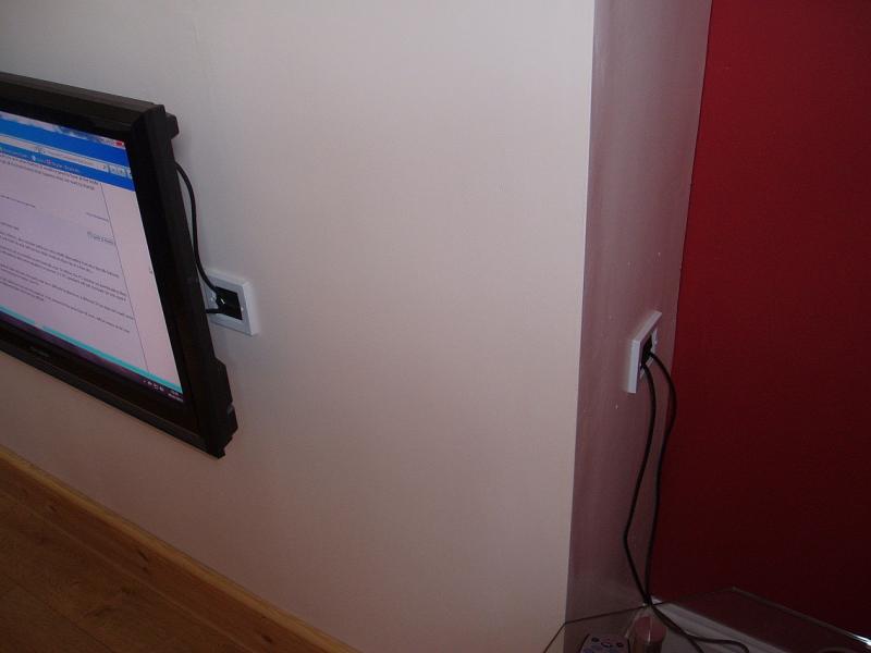

Hi, I posted some time ago about the method I had used to mount a TV on a chimney breast which had been dotted and dabbed:
http://www.diynot.com/forums/viewtopic.php?t=250025
I must add that the installation has now been up some time and I wouldn't hesitate to use this method again, or recommend it to others!

After spending a lot of time thinking about what to do, I finally decided to use 12 X 100mm screws with plugs and washers.
The bracket is rock solid and the tv looks great.
