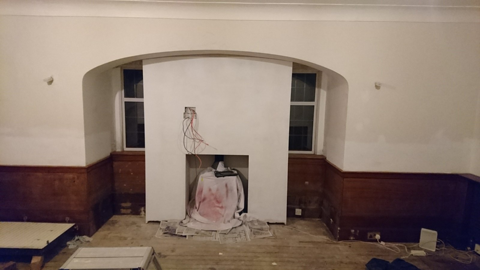

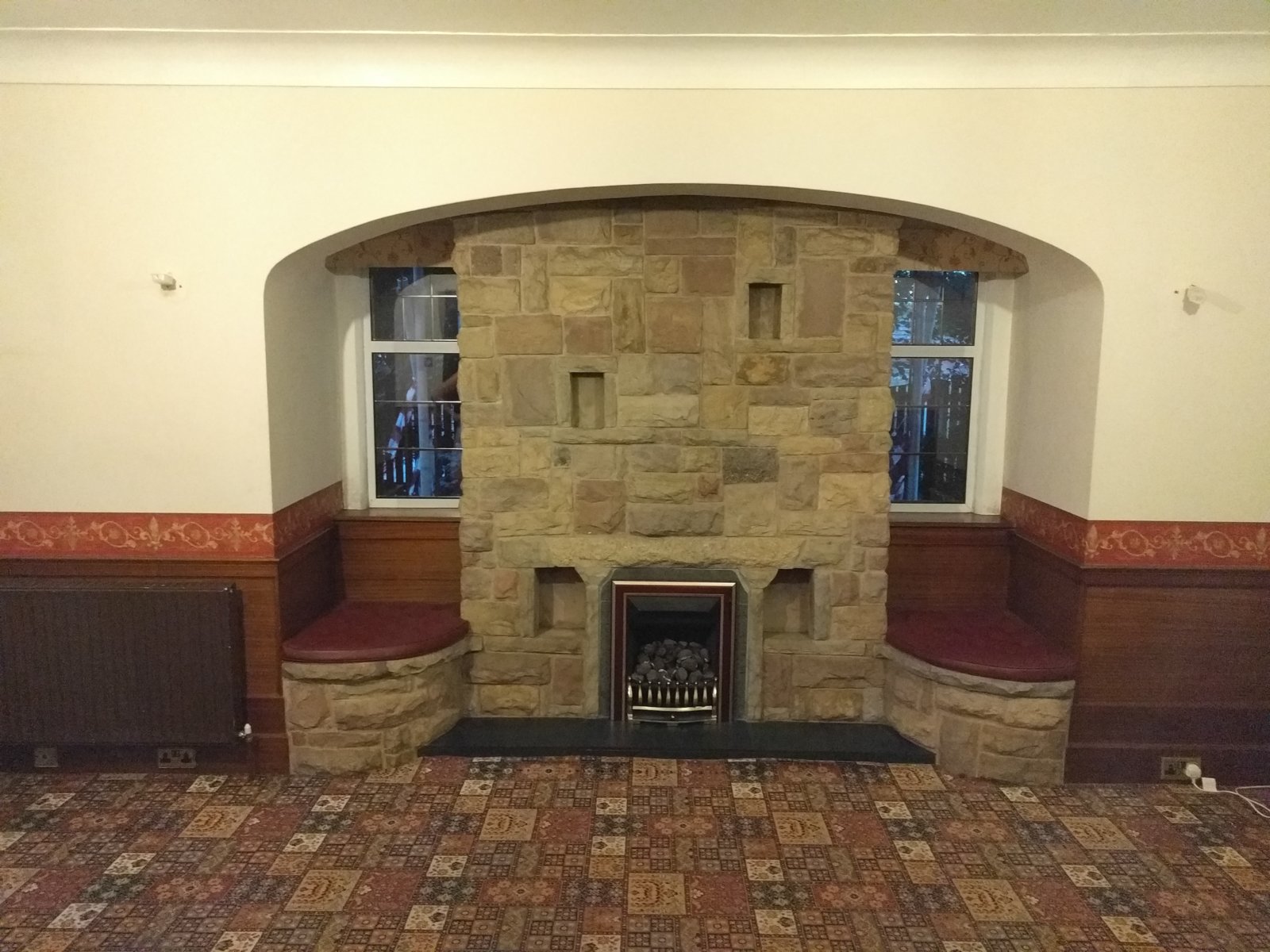

Hi folks,
Last year I had some work done on my chimney breast to convert it from the old stone work, to a new flat and painted one (pics below). I now want to mount my 55" TV on there but i'm conscious of the weight of it and don't want to just fix into the plasterboard. (should have thought about that in advance... doh!!!)
Because of the undulations of the stonework, the plasterboard is set about 50mm off the stonework in most places leaving a cavity of that depth between the plasterboard and the stone work behind.
I'm now lost as to how to mount the TV - should I get some very long fixings (100mm or 110mm) to go through the plasterboard, bridge the cavity, (both approx 65mm combined) and fix into the stone work behind...
Or should I cut away the plasterboard and adhesive and perhaps put a wood panel closer to the old stone work (for a flat surface) and then mount the TV on that?
By tapping the wall, can you tell where the adhesive dots are?
I would fix through the dots only, with M8 coach screws and Fischer S 10 plugs. These plugs are 50mm long, your board plus gap you say is 65mm, so you'd want 120mm coach screws. I know that doesn't actually add up, but 115mm screws are unavailable, and the bracket plus a washer will be a few millimetres anyway.

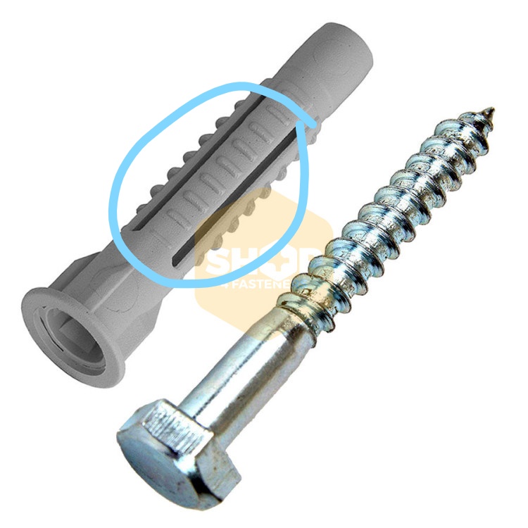

Would the fixing be any better if I got longer plugs to suit the length of the screw? i.e. 120mm plug and 120mm screw?
Something like this:
No, look at that plug, it does it's expansion along the middle portion...
That will pretty much only be in the adhesive. It would probably hold just fine, some adhesives seem to set as hard as concrete!! But, it's the brick you are aiming for. Go for frame fixings then if you would prefer it to be 'sleeved' all the way. See how the expansion happens at the tip, nicely/securely in the brick...
