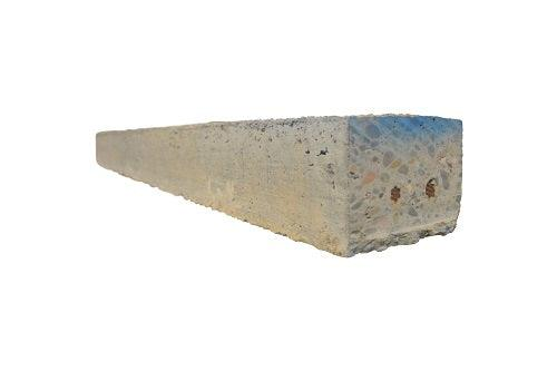

Thanks for this. I don't expect to not affect the decor at all, but cutting massive big holes in the ceiling is probably out of the question.
We'll be using M6 x 75 concrete bolts into the brickwork, and the steel pole and brackets are coming from a specialist metal supplier based on their recommendations
The lintel is cast conrete, reinforced with steel like this:
Yes, it's a supporting brick wall and the wall does indeed continue up to the second floor of the house, supporting the second storey brick wall
