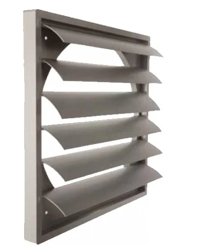

Similar to that video, I have a vent like this for my kitchen extractor.
How do I make this rat/mice proof?

I had a slug problem years ago, I used aluminium car body repair mesh, just cut it to size and silicone it in place.
It needs to be a tin mesh, otherwise it will restrict the airflow - better, might be to prevent them getting access completely to the vent, via some sort of over-hang. See Ivor's post #6 where he suggested L shaped alloy extrusions. They would need to poke out from the wall, far enough to prevent climbing round them, and placed all the way around the vent.
