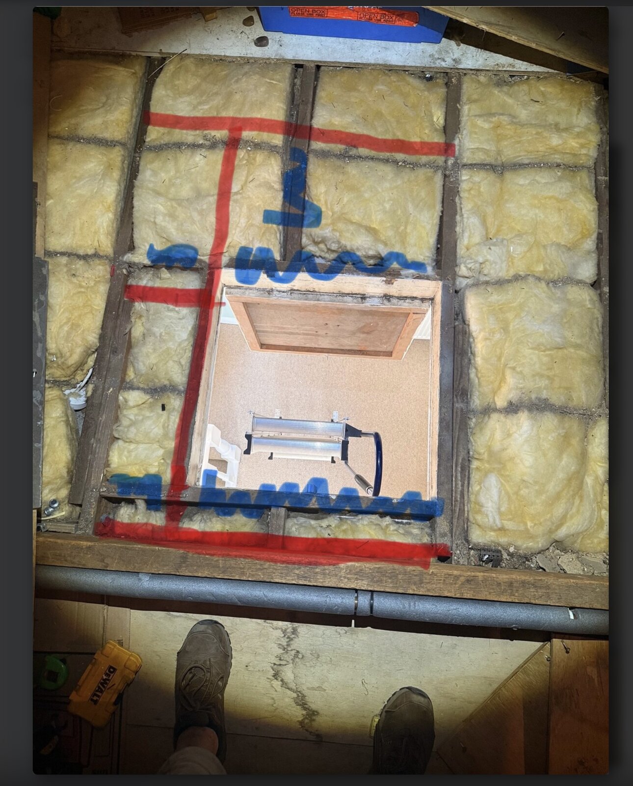

I didn’t move my loft hatch but I recently enlarged it to allow for a new hatch with attached steps. This pic may help you. The blue lines are the existing joists that I removed and the red lines are the new joists that were added.

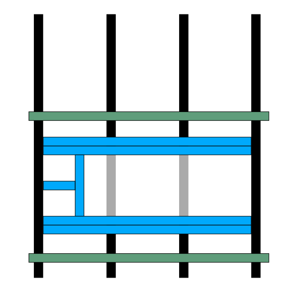

My thinking of potential cuts and new supports/noggins are like this...
But I've seen other things saying you need to double up on joists all the way around so would that mean the noggin joist either end of the loft hatch (far left and right in this) need a joist that spans the roof?
@Scally-Ho If the angles of the wall / ceilings / roof / hatch etc don't allow for a full length joist should I just put a joist from the outside wall (left in original photos) to above the bedroom walls, so essentially across the landing?
