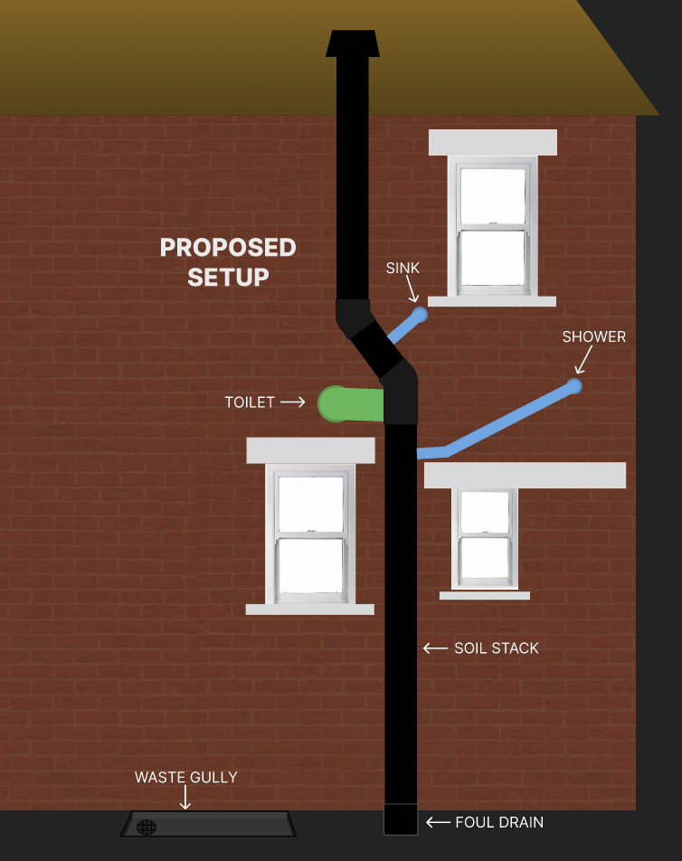

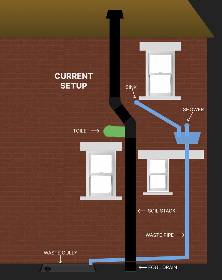

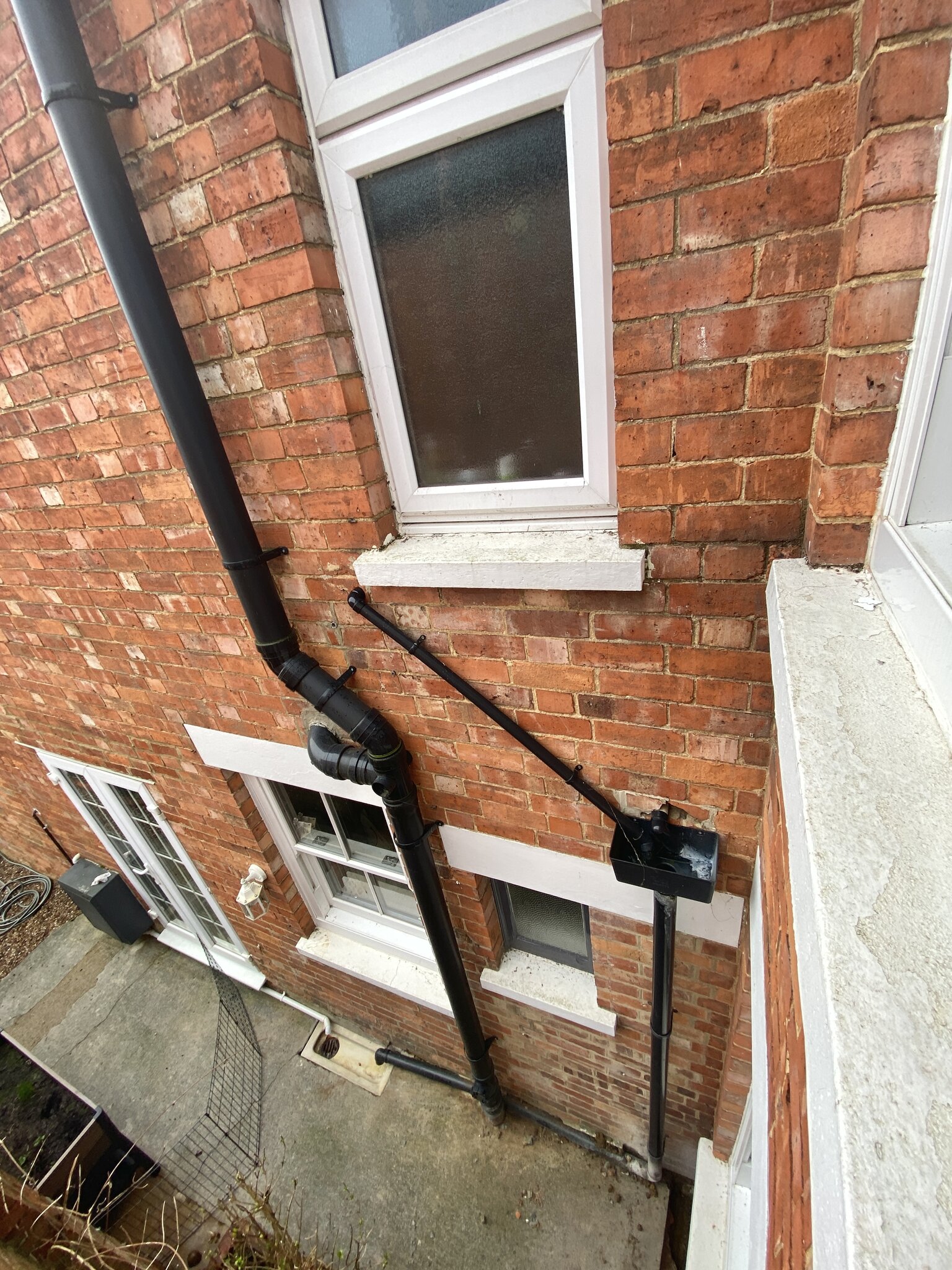

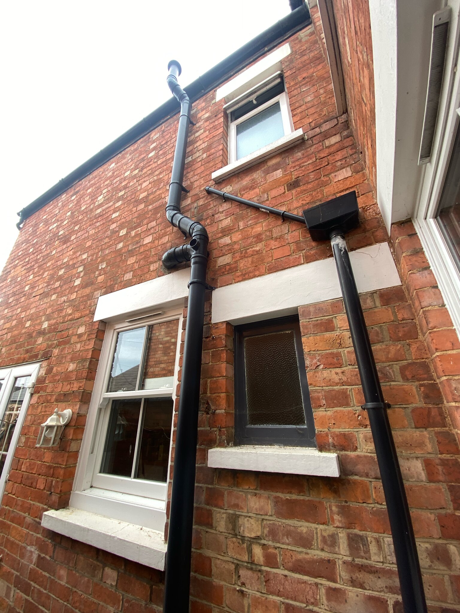

I want to move my bathroom sink and shower waste pipes to the soil stack.
I'm assuming this is fine, but just want to make sure I'm not missing anything important. Also not totally sure what fittings I should be looking for given the angles at play.
Thanks for any advice!
It's fine, straight in with the sink and a 45 degree bend on the shower.
