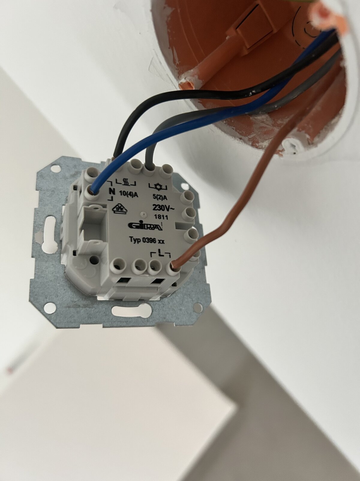

Hi all, I would like to change from the gira thermostat to meross MTS200. Does anyone know how to wire it. I don'z know what "NO" and "NC" means. Thanks a lot for your help
NO means normally open and NC normally closed. So will be the top 2 wires looking at that
also on the gira one the black cable indicates heating and the grey one indicates cooling.
