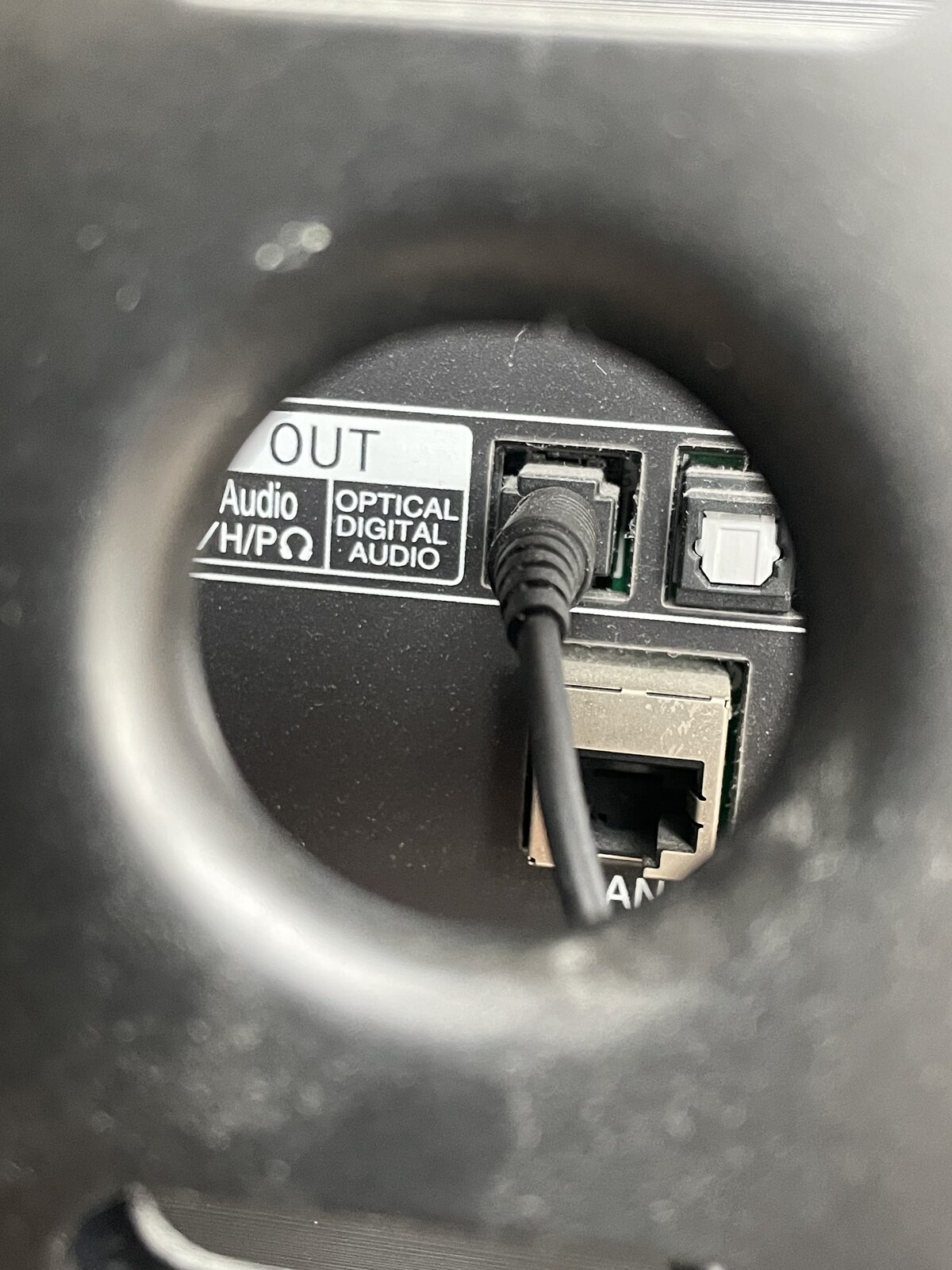

I don’t know if you can see what I am trying to show ….
It looks like the place to the right, of the plugged in wired headphones, which appears to be blanked off, is the one we need to use. Have I got this right? Can it be opened with some handy deft fiddling work?
In the hope that this is the port (?) to use and that it can be made available, is the optical converter you mention a transmitter? I have been trying to find what I think I may need and it’s not crystal clear.

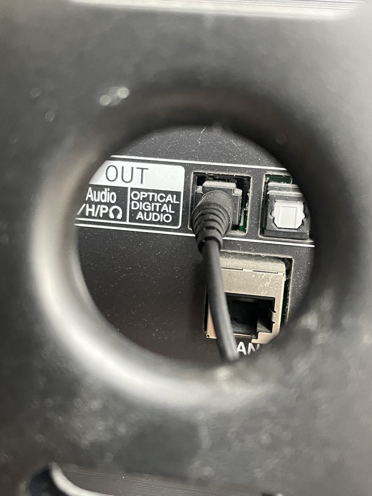

That's just a little cat flap type lid to stop dust getting in and blocking the light emitter. When you push in the plug the flap folds back and up, just like a cat flap. You can take a pen or similar and move the flap to test it. This is hinged at the top (did I mention cat flaps before? :LOL: ) so push close to the bottom edge.

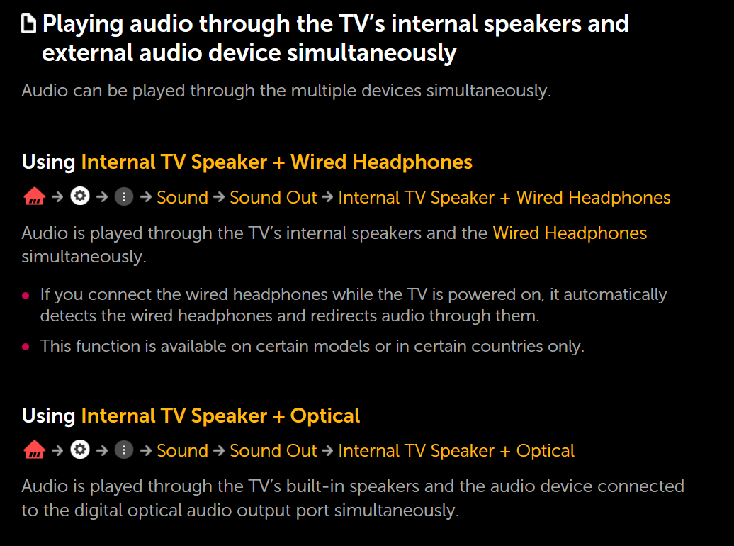

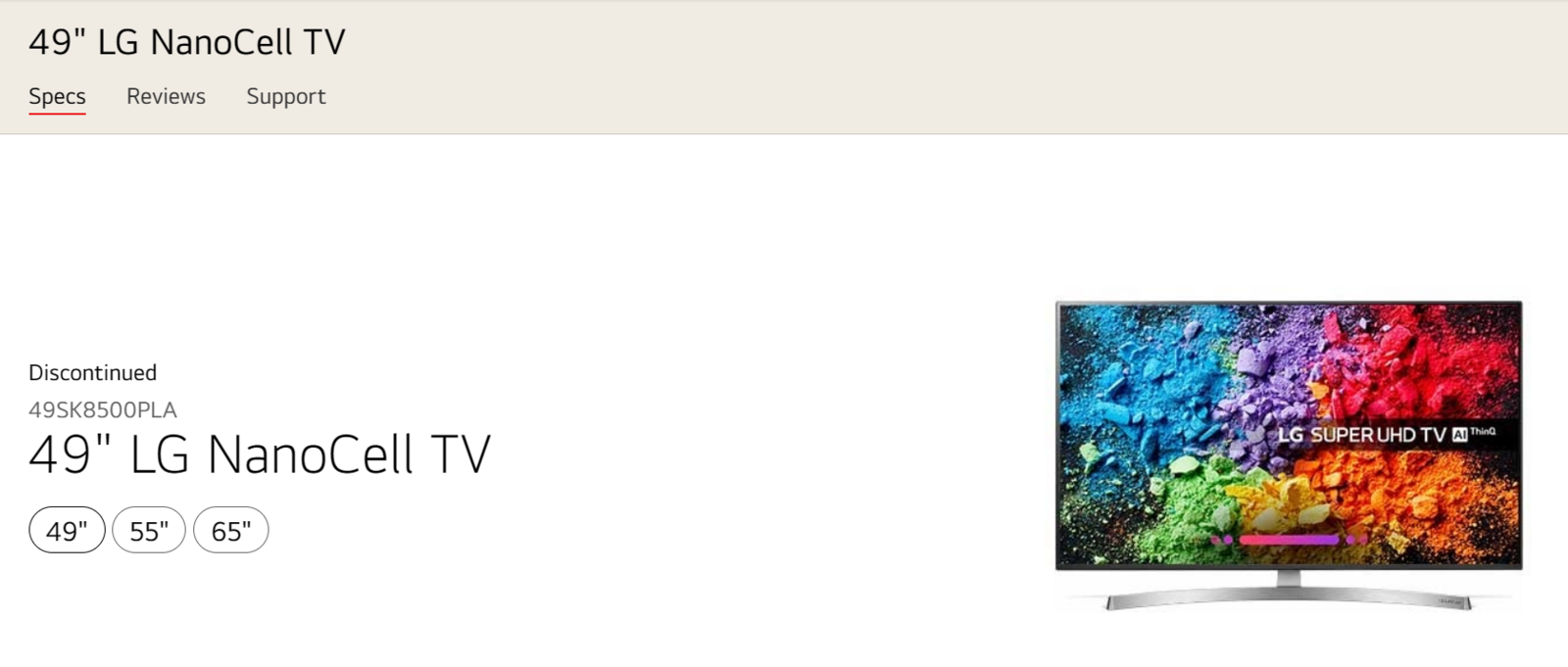

This is from the LG web site support pages for the 49SK8500PLA. I couldn't find a model match to your 49SK5800PLA, so I took the guess that this could be a typo with the 5 and 8.
Here I'm looking at the same user manual that is built into the TV. I think you have to press help on the remote or select from a main menu option to bring this up. The breadcrumb trail is Tour of Settings > Sound > Sound Out, and then I scrolled down to find this;
LG are saying that it is possible to use the internal speakers and optical, but they're vague about having more than two simultaneous outputs. This level of vagueness has been a growing problem with user manuals. The Web OS manuals aren't great, and it doesn't help that manufacturers try to cover lots of models with the same generic publication, so you find features described that your own TV model may not have. It's very frustrating from an installer's point of view.
The issue for you is two-fold.
1) Getting the TV speakers and Bluetooth on at the same time - but this may not be required if optical can be used instead
2) Finding out if optical works regardless of other settings
For #1 there could be a couple of reasons that prevent this. The simple one is a menu setting, but looking at the manual the only option appears to be Bluetooth output On or Off. This could indicate that the TV has only a single digital audio processing circuit, and it can either create audio for the speakers and wired headphones (both analogue) or be dedicated to creating audio for Bluetooth.
My own TV is a Panasonic. The Bluetooth connection gives me a choice of having BT only, or sound output to all the connections. In my case that's HDMI ARC, Optical, the TV speakers and BT. I realise that this doesn't directly help you with your TV. I'm simply highlighting that it's possible. Your mileage may vary.
Point #2 - My gut feeling is that optical will work when the TV speakers are running. There's a common issue when basic sound bars with optical in are used. It's that the TV speakers need to be turned down otherwise both play together. This is because both optical and the TV speakers work at the same time.
The only way for you to be satisfied on this though is to try it on your TV. That might mean borrowing a speaker with an optical input from a friend or family member.
