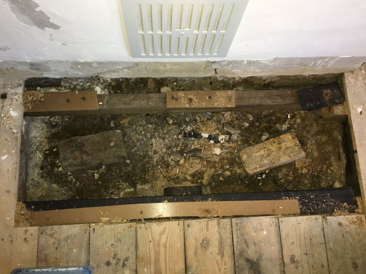

In my 1880 Victorian End of Terrace, the relative humidity in my front living room is staying around 75%. Not good.
Part of the problem seems to be water ingress through the external flank wall (which used to be joining onto a house next door bombed in WW2). I'm hoping to cure that by having lead flashing installed on the roof instead of the cracked cement fillets, and probably removing all cement render and plaster from the wall, replacing with lime equivalents.
Today, I uncovered the old hearth area in front of the chimney breast, and found a bed of soggy clay soil. I'm hoping that it's only soggy from ingress rather than wicking up moisture from the ground.
What should I do? Should I did out the soil? Is there likely to be some sort of solid base to it or is it just a tunnel to the centre of the Earth?
Pics attached. Thanks.

What level is the sub floor in other areas of the room? I assume there is more space under the joists outside the hearth area I hope so anyway as that very poor ventilation if not!?
If the subfloor is lower in other areas then your hearth may be a mix of weak concrete and rubble fill. I doubt its up to much.
In a house of your age the subfloor will not have oversite concrete of anykind obviously so of course the clay is probably damp it is bare earth and thats why your subfloor should be well vented.
If you have damp problems i would open up that chimney brest (or at least cut out that vent) and clear out anything in there and let it vent open for a while. Also make sure your air bricks are unobstructed and adequate.
These are both good things to do for long term building health even if not responsible for the damp so worth doing now when floor are exposed etc anyway

No need to dig out the soil too deep just get it well away from the joists and that sleeper wallplate on the photo looks pretty rotten. Ideally only create a constructional hearth the size you need so dig out the soil and make a basic box frame, line the base with a dpm and pour a small concrete slab. nothing too serious 4 inches thick would be fine.

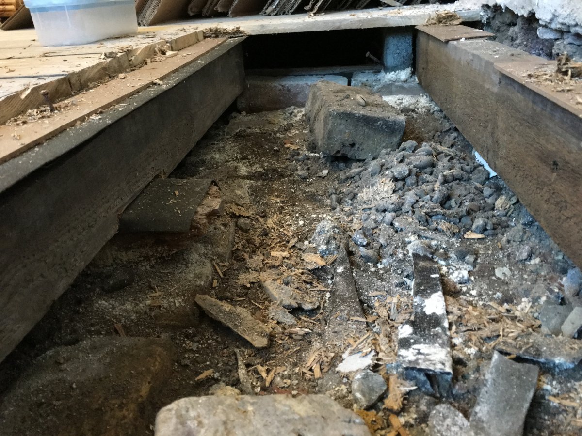

I'm digging out the soil in the hearth now, and worked out that it's 2 feet deep by hammering a metal pole into the soil. It's heavily compacted London clay soil, holding quite a bit of moisture, and I recognise the smell as being the same musty smell in the room when it's damp. In that case, should I remove it all right down to the solid (presumably concrete) base?
I've poked the subfloor with a stick and while it doesn't seem to be overpoured with concrete, it seems ash-like, very light grey, not like the soil in the hearth. Any idea what that would be? I also noticed lots of salt residue on the brick pillars supporting the joists. Do you think this will pose a problem, or is it normal in these sorts of houses?

The salts are nothing to worry about. There is no need to dig out the hearth super deep as there will be no concrete under it most likely. Dig out to below the joists level to aid air flow in the sub floor and then form a box with scrap timber and line it with dpm and pour a hearth as mentioned. Dont make it hugely deep, 4'' is plenty but dont make it more than a foot or it will be so heavy it might gradually sink itself over the years.
Thanks. I definitely felt some sort of base (concrete or stone?) in the hearth when I hammered a pole into it though... Does that change your recommendation to dig out? I'm worried I'll be trapping moisture in the soil which will keep seeping into the brickwork. Relative humidity is still about 15% higher than other rooms in the house :(
You most likely hit a large stone or perhaps a bit of the wall footing. If you get the soil well down below the joists and use a dpm then there should be no issue.
