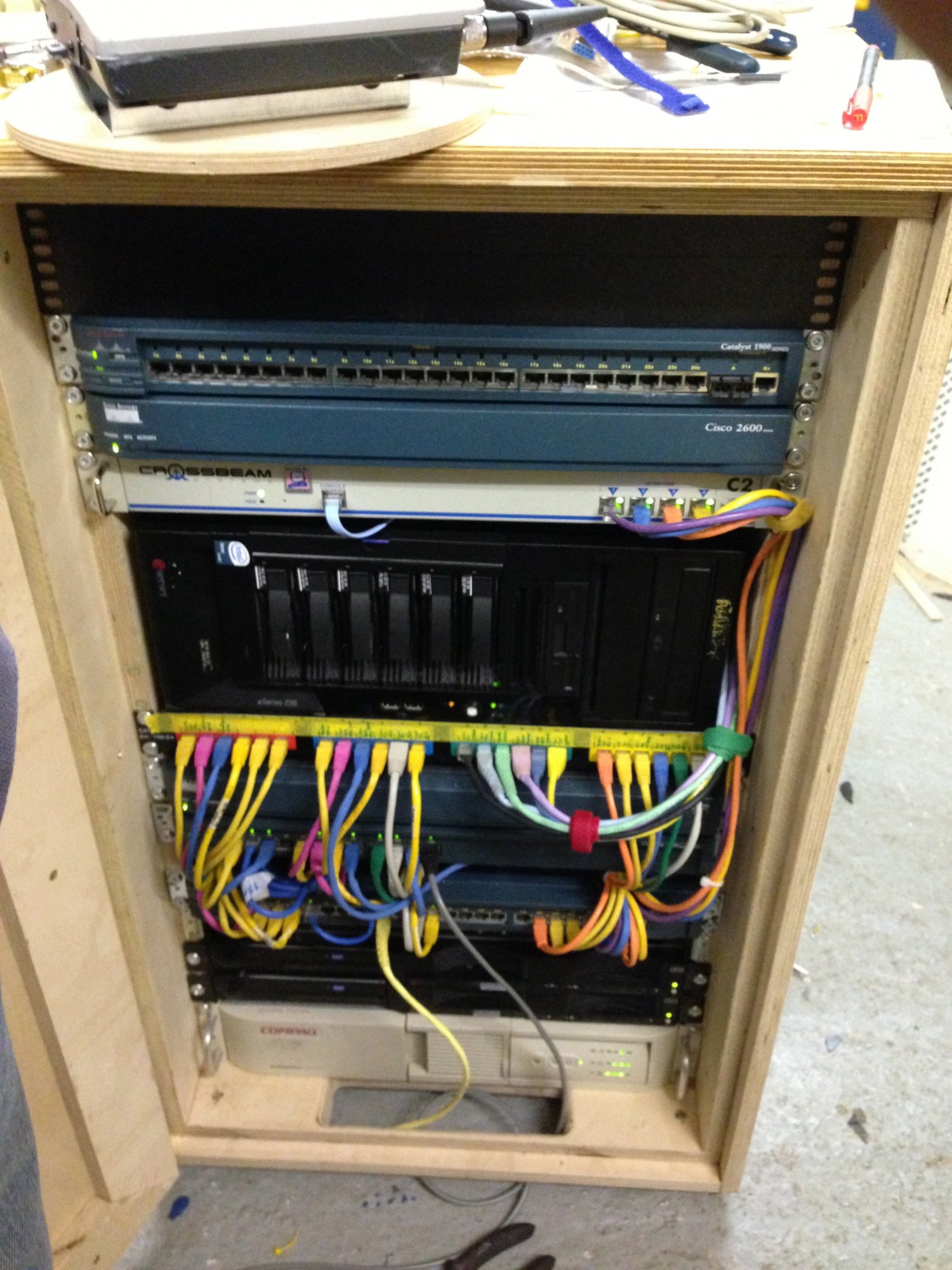

Run out of cable ties? :D
I do quite like the homemade server cabinet though. I've lived in flats smaller than your plant room!

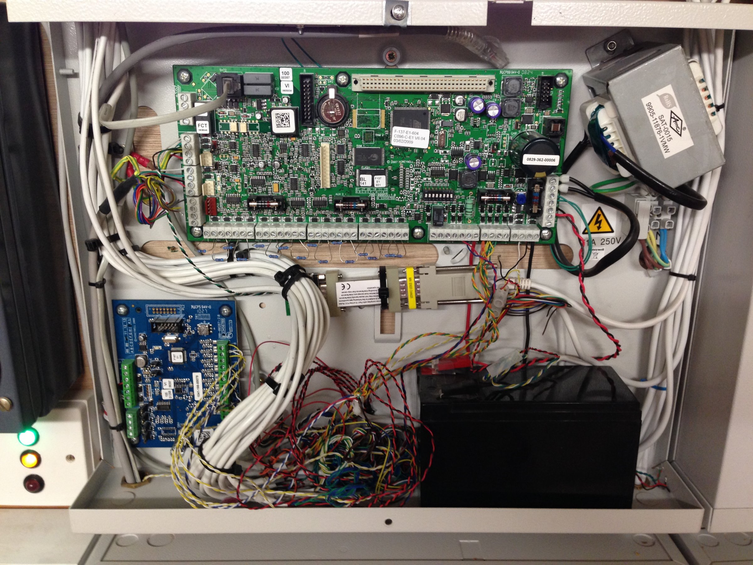

Here's how I interfaced to the Galaxy GD96, in the middle you'll notice an RS232 <-> RS485 converter which I've connected across the data line of the alarm. It's fairly easy to read the data off this serial link and use it to do useful stuff without the need for separate sensors for alarm and HA stuff.

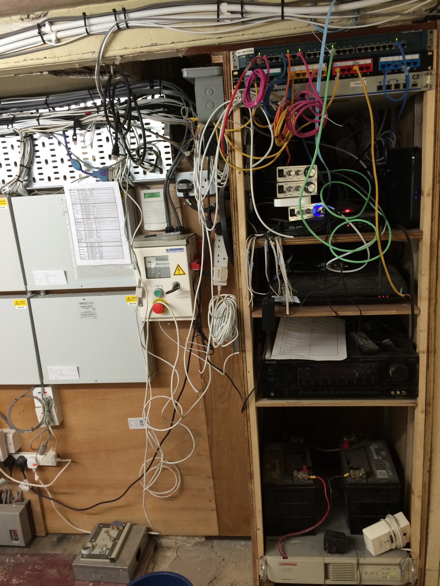

Hi, You can't see the back door, but it has a couple of big mains fans in it, that slot in the floor is where the air comes in, and it's sucked through and out the back fans. Works pretty well, but in all honesty I tend to keep the doors open now, you can't hear the fan noise from the main house
Wow... If thats the space i'd need to sort out my home automation i'll give up now- need to buy a bigger house first!

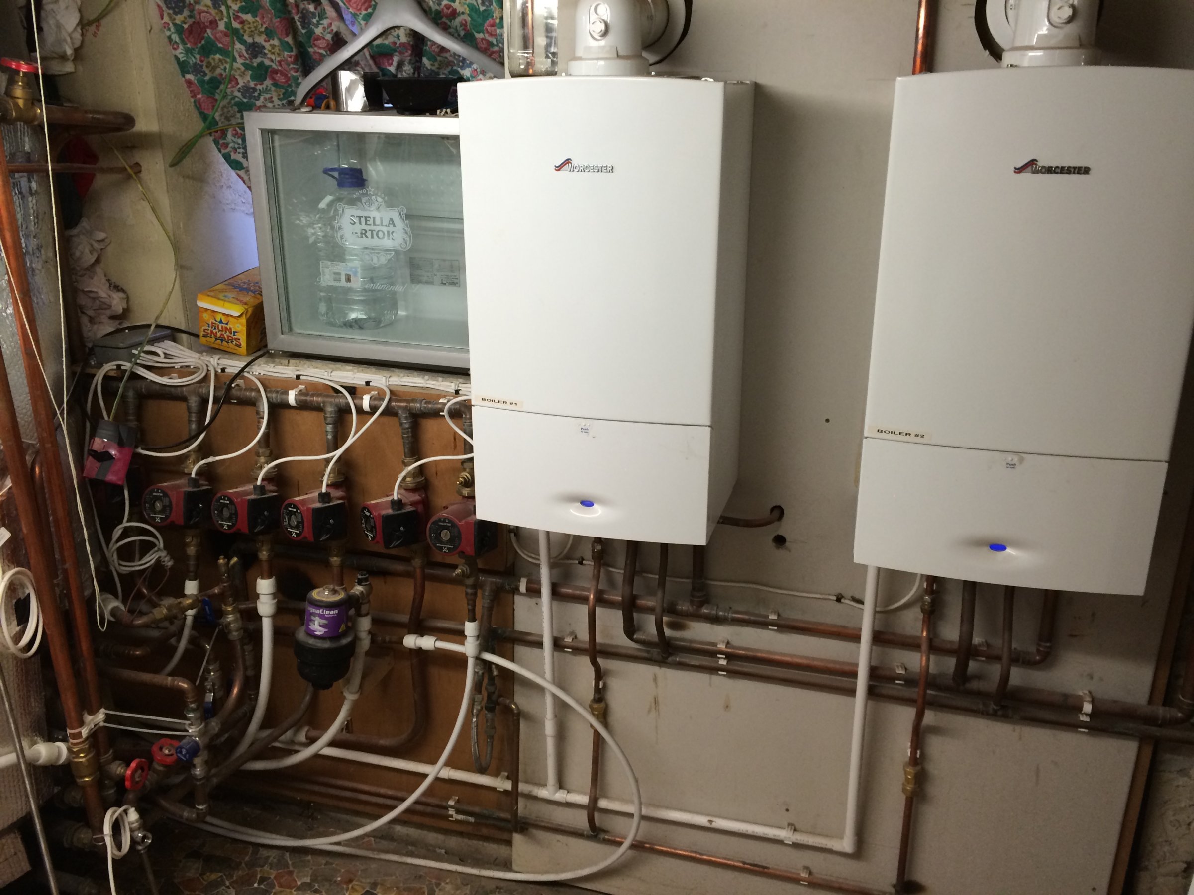

You have a couple of pi's in the second pic, is that what is driving everything?
Also you have a fair few pumps on the CH loop, no zone valves in sight, what/are there any controls for zoning?
Lastly, how are the two boilers working together? (I started a thread a while back and conclusion was no point unless using a proper controlling device between the two!)

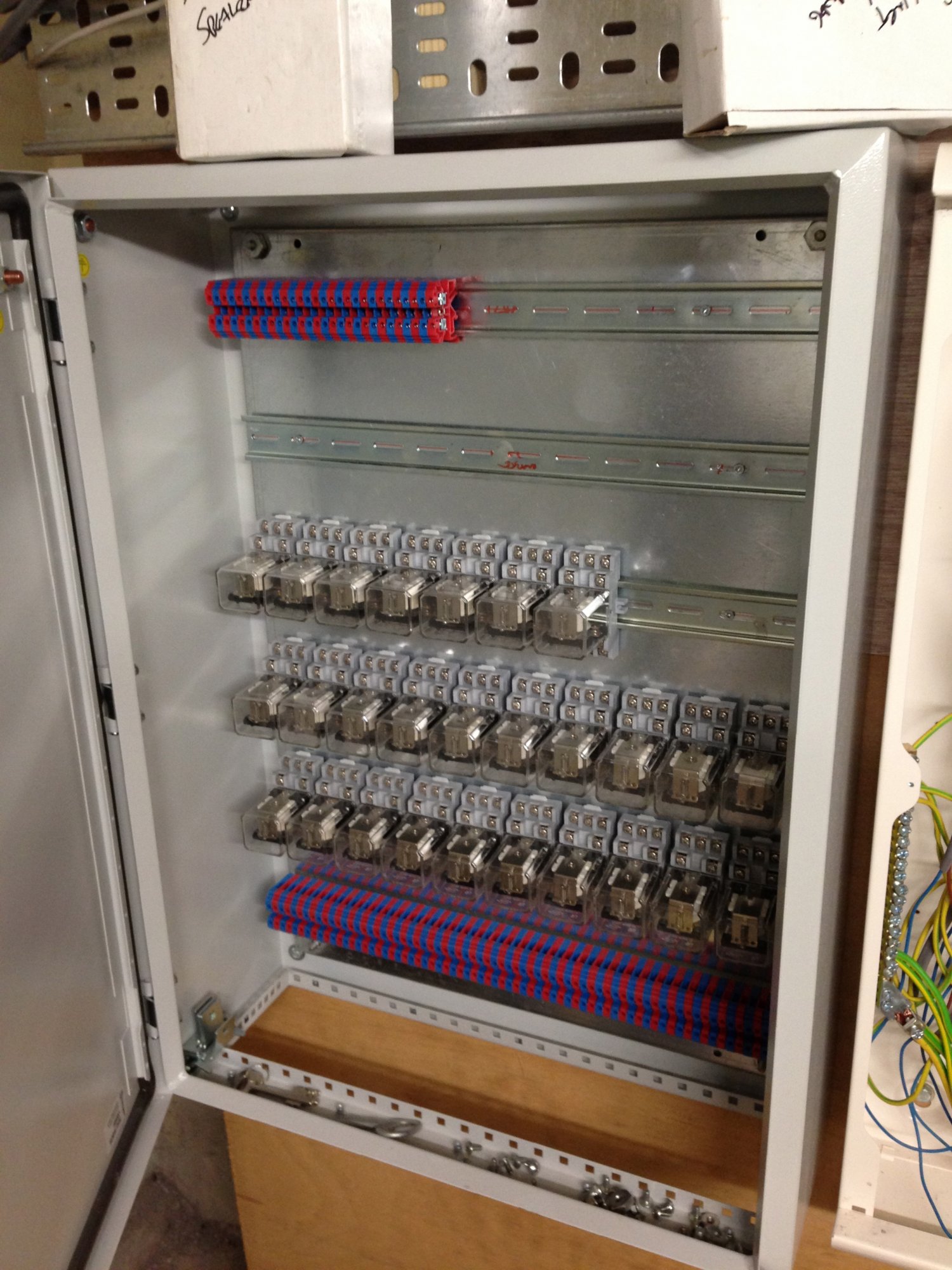

Hi Bob, yep those 4 raspberry pis drive everything, they do dmx for the lights and you'll notice a couple of external rs232 for serial comms, all the relays and inputs are via pokeys 56e and I use i2c for temperature sensing

Yep the pumps are for the various heating zones, there are 4 floors, so a zone for each, then one for underfloor and the final one is a flat plate heatex for domestic hot water. No zone valves, I don't like them and with multiple pumps I can better control the flow for each zone, both by pump speed and the union valves.
Water speed is important to me, that big black cylinder is a 1000 litre thermal store, I want the return temps quite low to ensure good stratification
Hi Bob,
I went for two boilers as I needed a fair few btu output and I also wanted resilience and reliability.
I use the rasp pis and a bank of temp sensors on the thermal store to trigger the boilers. If the tank gets cold or the rate of heat change is high, I use both, otherwise I cycle between the two on a daily basis

PS - like the idea of tapping into the alarm panel to find the state of various sensors! i was toying with putting two contacts on the windows... this way i just need one set of cables between alarm and pi, and lots of code to decode whats being sent!
