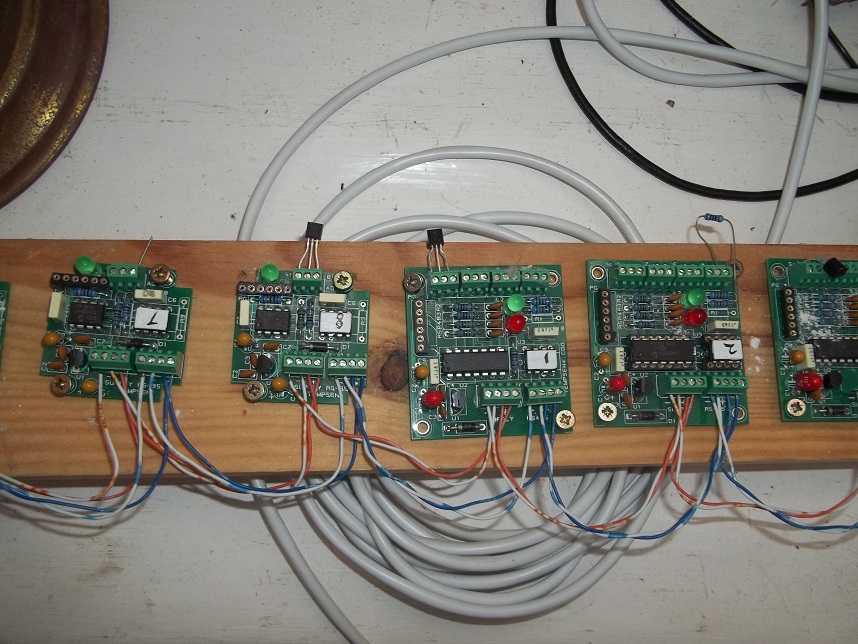

My sensors are AD22100 and the analogue to digital conversion is performed at the sensor location on bespoke PIC based convertors. These are networked on RS485 allowing up to 100 metres between sensor and controller. This after some trials with "long" leads between sensor and controller with analogue inputs at the controller.
Two types of board. One has 4 analogue inputs and the other a single input.
The green LEDs are diagnostic for the board being addressed and the RED ( only on the 4 channel ) can be used as an indicator.

Very professional looking. Did you find a company who would make small quantities without charging the earth?
I used the same company that I used for my business. UK based and their main production facility is in the UK. They are not the cheapest ( and not the dearest ) but they are reliable and the quality of their work is very high. It is also a one stop shop. I just e-mail the Gerber files for the layout to them, they then photo plot and check for any errors ( hole large than the pad etc ) and then 3 or 4 days later the boards are ready. They work on a fixed price per plate irrespective of how many holes and routing there is in the design. That makes costing of a project very easy and allows for several different items from different projects to be put onto one plate.
