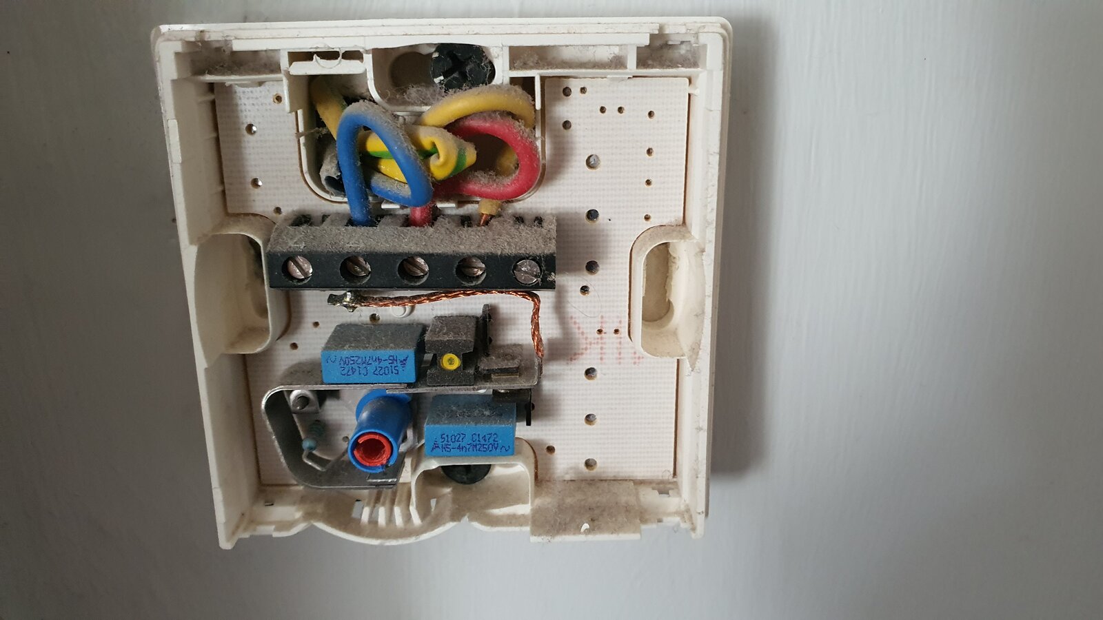

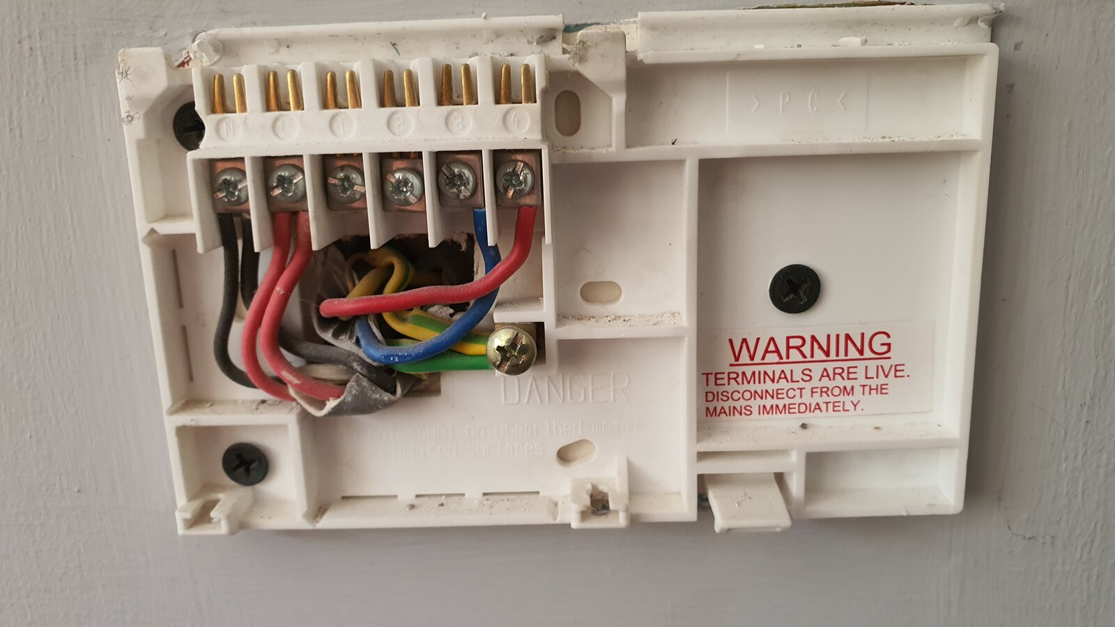

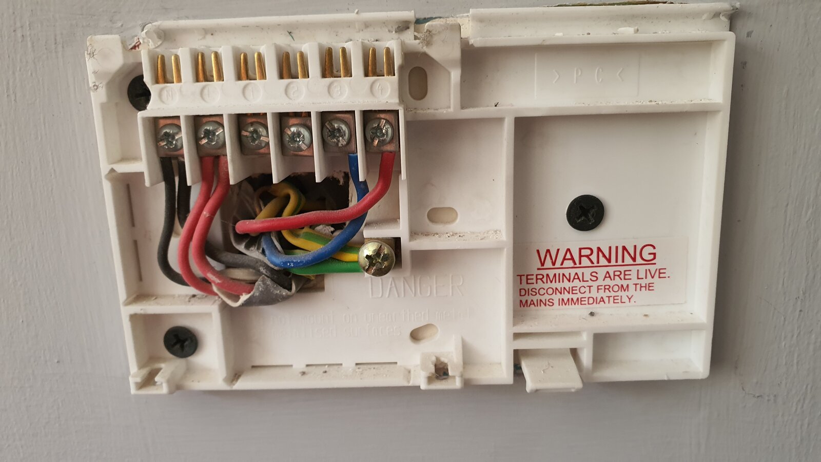

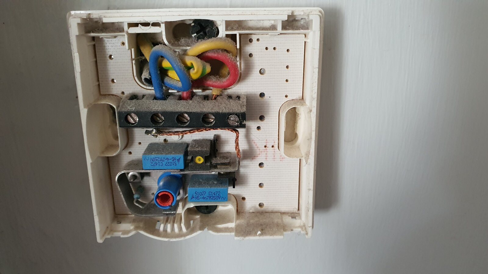

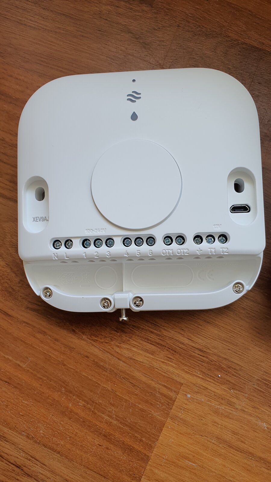

I am currently trying to install a nest 3rd gen thermostat on to an existing myson mep2 programme system.
Can some one please help a guy out and let me know which wires go where and also can I put the wires from my room thermostat straight into the nest?
Your help is much appreciated.

If you want to use existing thermostat position and wiring, then you’d be best putting the nest heatlink near the wiring center.
Nest pro or someone more familiar with wiring on here. I can do it, but not 100%.
The programmer
clearly 3 and 4 are switch wires, but there is some thing missing, you have red and blue at programmer and red, blue, yellow at thermostat, but seems likely behind the programmer there are other connections.
So as CBW says start at the boiler, there are three ways to wire a boiler to a thermostat, extra low voltage on/off, low voltage on/off and varying voltage up/down, the latter is the best.

Thanks for this, I think I either need to get a professional in or just send it back. Much appreciated.
You can start with model and make of boiler. Then at least you will know what will work.

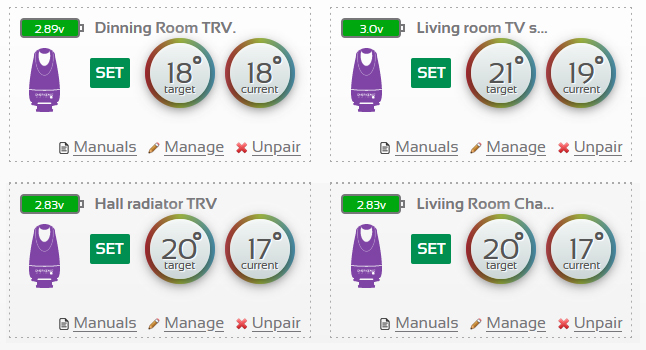

I used the Energenie in the last house with gas central heating and a modulating boiler and they worked spot on, once set, the display shows 4 TRVs-1.jpg the target and current, and if current is over target close the lock shield a tad, and if under open it a tad, and in the old house once set they were spot on, however new owners did not want them, so put the old wax type back, and guess what, now set, they also worked spot on. So yes @AndyPRK is right in a way, not required if heating all rooms at the same time.
