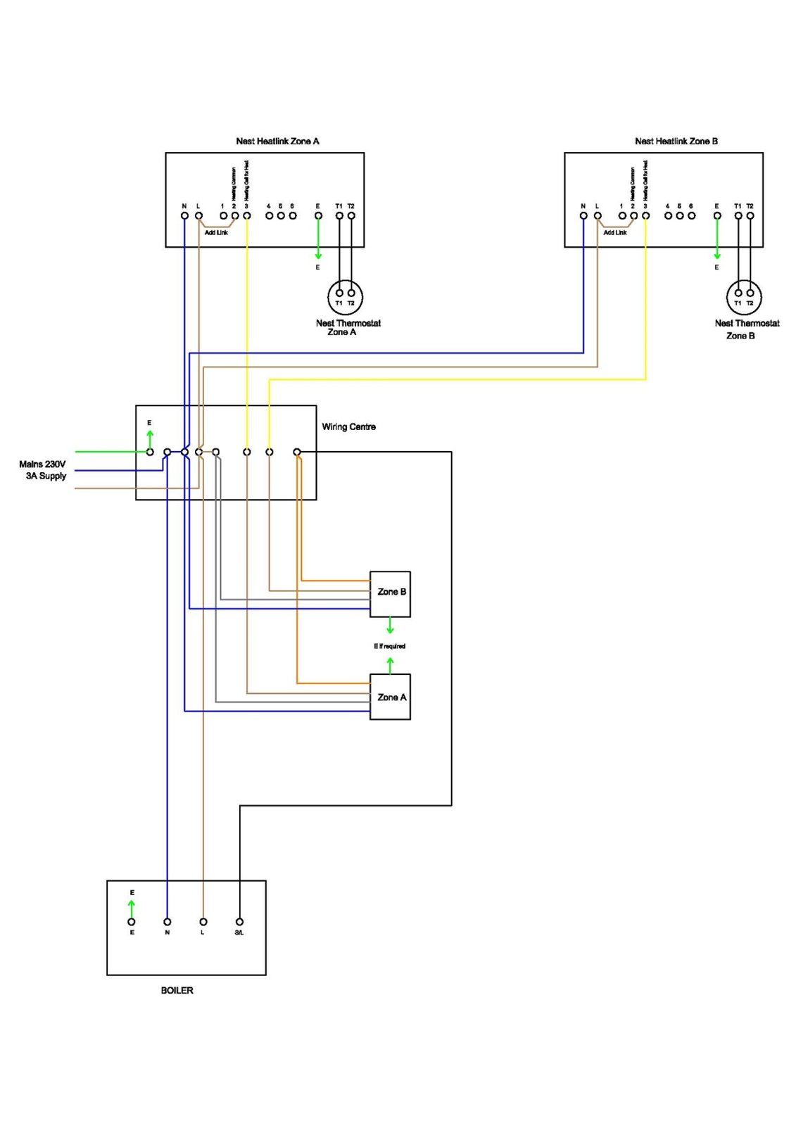

OK, in that case, here's a wiring diagram for your complete system. The connections at the wiring centre can be in any order, provided the wires are connected to each other as shown. I've omitted the terminal connections for both sets of T1 and T2 for clarity as they just go straight through.
Wow, thank you so much! I can't wait to work through this to double check that everything is correct before I fire it up. I am sure that this will be useful for many more people too :)

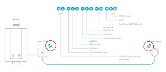

The final section of this Nest support page for the Nest Learning Thermostat says the following:
"If your Nest thermostat is installed on the wall and connected to your old thermostat’s wires, it will use both the wires and wireless Thread to communicate with the Heat Link."
I will switch over the thermostat faceplates and see if it then operates correctly. More to follow.
I think @ericmark is right. T1 & T2 primarily provide the thermostat with power and the are not essential connections, because a separate 12v power supply could be used, in which case, the thermostat will still communicate with the Heat link. And, as you say from the support page, and also as the diagram below shows, some communication is still wireless.
