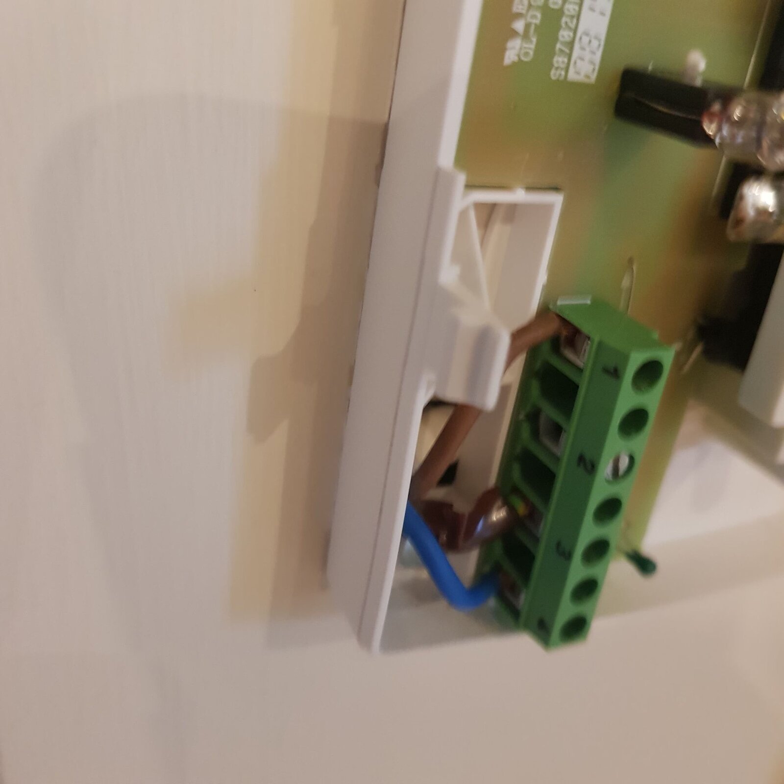

Hi all,
Apologies another nest thermostat query re installation. Reading the other pages has been helpful and think I'm nearly there.
Current set up: from mains fuse box 3 core cable to isolation switch - then a Live and Neutral come off and go to control panel (currently centaurplus c27), a further live and neutral go to boiler via 5 core care, and lastly an earth goes to boiler and further earth to control panel.
On the control panel: L, N as coming off isolation switch, a neutral wire coming off and going to thermostat, grey wire in number 3 from boiler (call for hot water), brown wire from thermostat into 4 (call for central heating).
Wall mounted thermostat - Thermostat position 1 brown wire - call for heat into the control panel position 4, Blue Neutral coming off control panel to thermostat position 4, and lastly direct connection to boiler via a black wire in the boiler 5 core which is joined to a current carrying yellow/green wire located in thermostat position 3.
Using the nest wiring diagram:
- Control Panel Neutral Live get changed over to the nest Neutral and Live
- Jumper wires from Live to position 2/5 in the Nest
- Grey wire in position 3 in the control panel to Nest 6 (call for hot water)
-Then Nest T1/T2 position wired directly to Nest thermostat

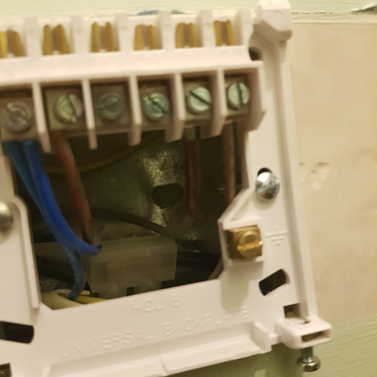

My question really is about the call for central heating which will eventually go into Nest position 3. So current set up black wire directly connected to boiler comes to join in picture 2 behind control panel from which a yellow/green current carrying wire goes to position 3 in the thermostat, with position 1 in the thermostat then joining control panel position 4 the call for central heating. Can the yellow/green current carrying wire be connected directly to position 3 in nest as thermostat will no longer be needed?
Any help would be greatly appreciated
Green/yellow should only be used as an “Earth“ or better known as a cpc. I don’t believe the black wire will go directly to the boiler, more a wiring center and from there.
Hi Chris,
Thanks so much for the reply. All wiring has been like that since it was installed by so called 'professional' when boiler put in. If the black wire is connected to the call for heat on the nest heatlink will it work?

Yes from my understanding the oil combi has 2 connection one for CH and one for DHW, which would be the 5 core cable currently from boiler to control programmer. I know the DHW links into nest position position 6. The CH wire at the moment goes from boiler via a black wire to block connector behind control panel to thermostat then back to control programmer. My understanding is that by wiring the black wire connecting into the boiler for CH to nest position 3 would work as nest taking over the defunct wall thermostat.
I will search for the wiring diagrams online
