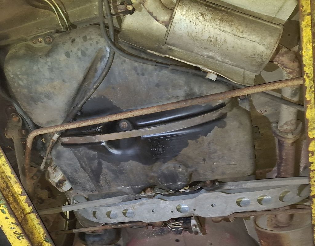

Had to rescue youngest sprog yesterday! Ran out of fuel. I was going to give him a thick ear for boing daft, but on arriving (in my EV with the can of petrol for the lawnmower) and tipping the fuel in, imagine my surprise when it started dripping out of the bottom of the car!
Turns out, there was a hole in his (plastic!) fuel tank! The most bizarre thing ever. The location was immediately behind the rear anti-roll bar. Definitely not the lowest point on the car, and impossible to hit anything there.
I'm baffled! They look like teeth marks? Anyone ever come across a case of a rodent gnawing a plastic petrol tank?

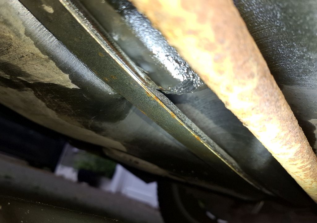

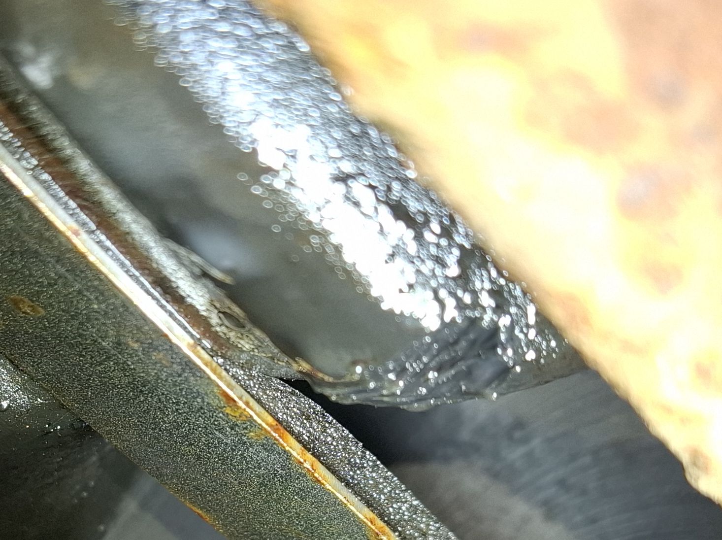

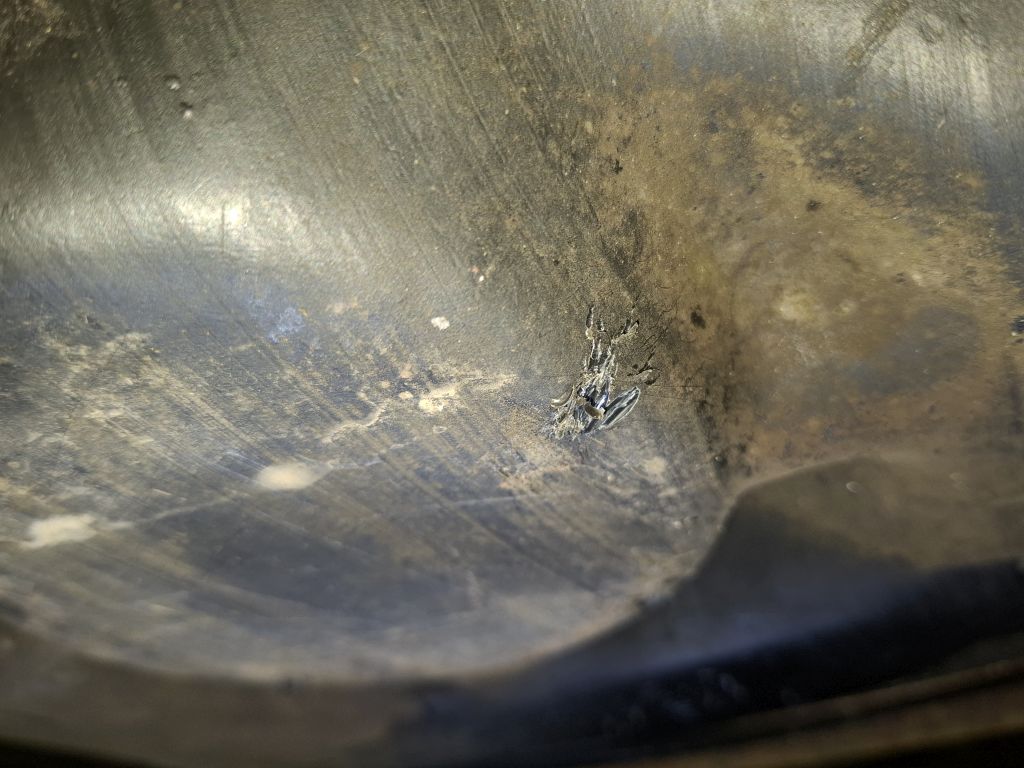

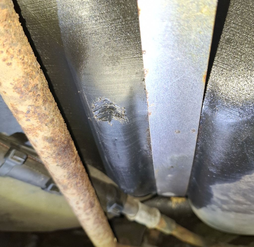

I've taken your and Deluks' advice and e-mailed a few companies in the North East and Leeds area, who advertise that service. We got it up in the air yesterday evening and I took a few more photos. I'm 99% certain it's rodent damage now. I can see a few other places where something has had a nibble, but hasn't gone through.
(This is the one that's gone through, after we'd wiped the fuel off it).

Gosh, that would be a fabrication and a half! The bottom is quite a messy shape to fabricate - you can see there's a step in it and it carries on over the rear crossmember, and the top is even more complicated, and moulded to accept the sender and pump assemblies. If I can get it fixed, or find another one, I think I'll wrap the bloody thing in chicken wire though!
