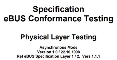

For what it is worth...........
As I recall OpenTherm was not an Honeywell original concept but was a version of the eBUS network.
eBUS was developed and was in use in various application before 1998
( the file is https://ebus-wiki.org/lib/exe/fetch.php/ebus/spec_test_1_v1_1_1.pdf )
The specification of the eBUS physical layer ( the hardware ) and the eBUS Data-Link layer ( format of data bits ) was more formally published in March 2007
eBUS is polarity sensitive, OpenThermo is not
eBUS and OpenTherm use similar bus interface circuitry but OpenTherm adds a bridge rectifier to allow for reversed connection of the data pair. This bridge rectifier reduces immunity to noise on the wiring but with the short cable lengths in domestic installs this should not be a problem. (eBUS works up to 100 metres )
