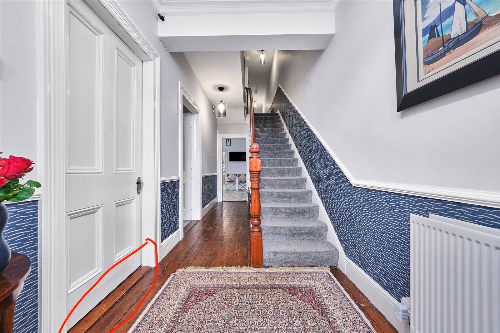

Hi guys, looking for some help please. I get the keys to my new place on Friday and plan to sand this wooden floor over the weekend.
Ideally we would like to have a light scandi finish. Is there any recommended processes or topcoats that I should consider using please?
Also I spotted on the photo that there appears to be a (previously stained) groove that I will not be able to sand, how should I tackle this to achieve a light look.
Any thoughts or suggestions would be really helpful.
Many thanks.

It looks like mahogany stain which you could sand out but depending on the floorboards age they could be a darkish colour anyway then when you put a normal varnish on they will look darker than the newly sanded look. It may be a lot of work and not get the scandi look you want, how about laminate.
Others might have a suggestion of some sort of wash perhaps to help

In a downstairs room I hired the big one that looks like a lawnmower and the edger but you will still need to get right into the corners unfortunately for me the triangle sanders were not out at the time i did mine so it was a sand block.and they really shake the floor, so for upstairs. I actually used a bosh DIY planer much quicker than a DIY sander - and it did a good job too.
Your floor looks to be pine but in my hallway I had an oak floor that I really wanted to keep but when I sanded it down ther were lots of really bad dark water stains that I could not get out. So I ended up laying engineered oak over it - and most of the rest of the downstairsthe

You can use a wood bleach ( after sanding) for a pale finish .
Sounds good but does it last as I find that wood underneath the finish over time darkens with light (sunlight ) not even direct sun
I'm not saying you shouldn't do it, but as a professional I would not take this job at any price.
I would suggest replacing all boards, refurbish with similar or darker colour or lay new flooring on top of it.
Its not a groove - its a threshold strip that usually is a transition between 2 different floor heights but from looking at your picture all rooms seem to be the same height floor.
