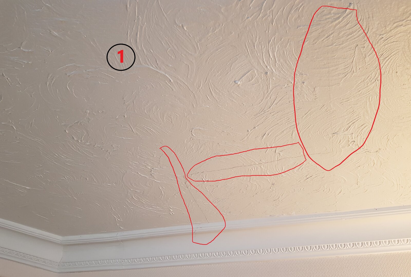

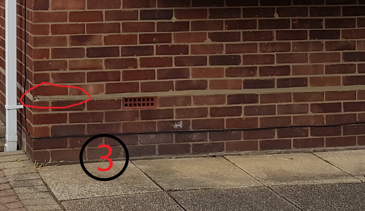

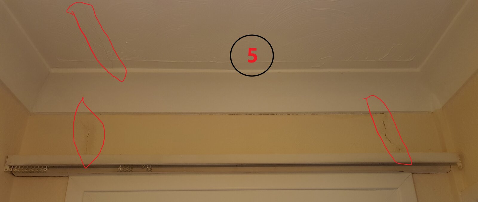

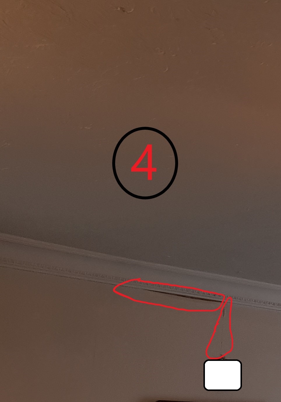

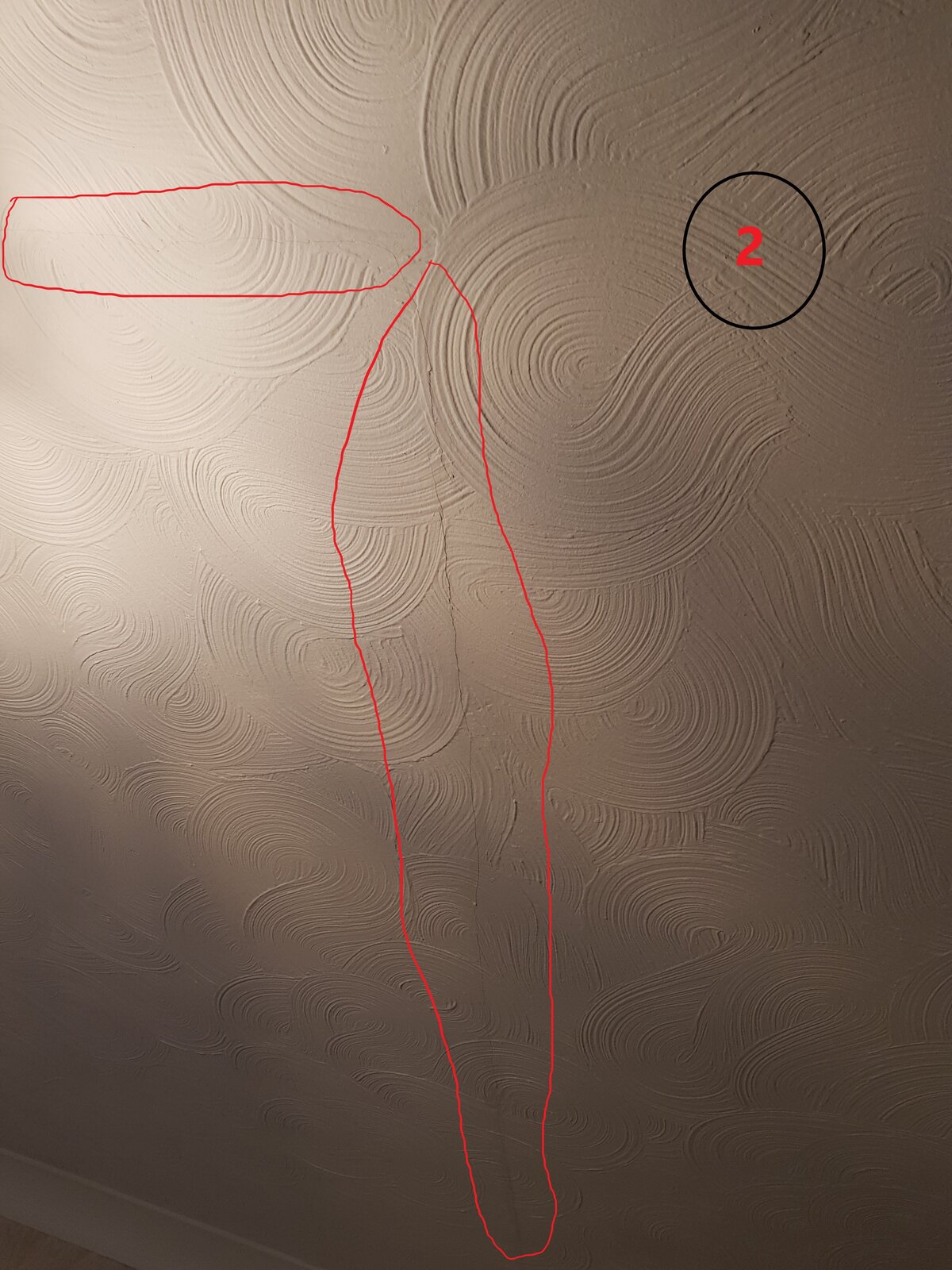

Hello
I am planning to buy an Bungalow. I had a viewing recently and i like the property.
These are some of the things that i noticed on ceiling / walls. Not sure if these are because of any structural issues (Please refere attached images - images numbered 1 to 6)
OR let me know if i dont have to worry about these.
Obviously we will have a detailed survey done on the property prior purchasing / going further.
If anything serious on structural problems comes up post survey, sale is very likely to fall through. But i would have already spent money on the survey and it will be a loss on me as this will be at the expense of some money that i have saved up for deposit with the sale falling through.
If you / some experts can look at it and tell me what these cracks / linings means from your experience that will really be helpful. Please refere attached images - images numbered 1 to 6.
Need some first level thoughts which may provide us some info to decision our response to the agent prior going ahead with the offer.

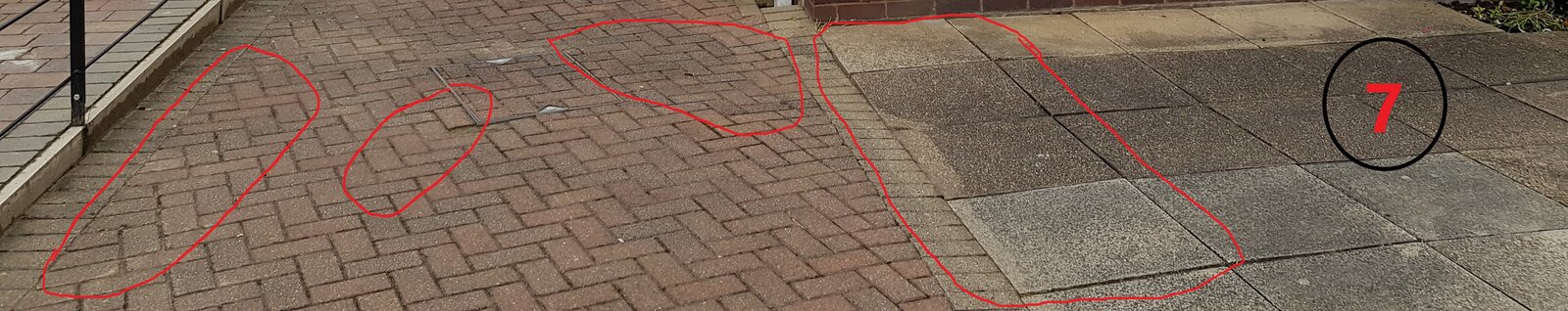

Also one thing that i noticed was the parking flooring was a sligtly up and down. I mean it was uneven a bit here and there (Image numbered 7). Any thoughts on this as this may create subsidence (or if this is because of subsidence) ?
In case if you have any other questions, let me know.

I am not an expert but they all look like minor cracks where typically plasterboards joints meet. The drive has just settled unless you know any different. All surveys will cost money but the idea is you use the result to negotiate the price or pull out based on the seriousness of the findings.
Personally I don't see what the problem is, nothing there. Buy it.
Just decorating required by looks of that.

There is nothing in those images of any concern.
The only possible thing to be aware of, is that that textured coating on the ceiling may have some slight asbestos content. That in itself is not a problem or to be worried about, but if you decide on any repairs done contractors may not want to work on it without costly precautions.
