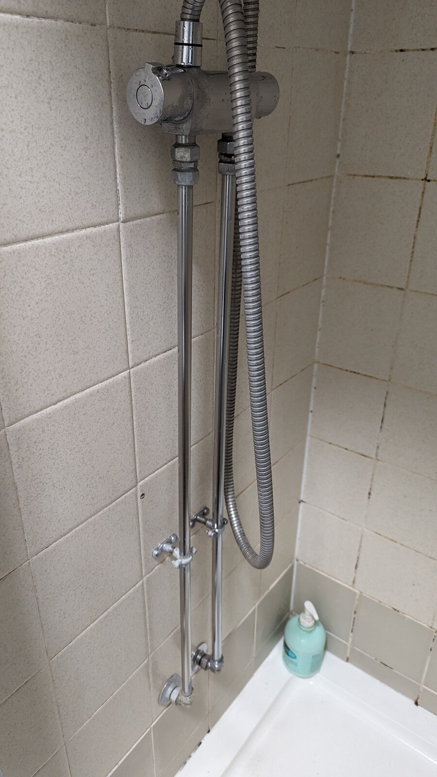

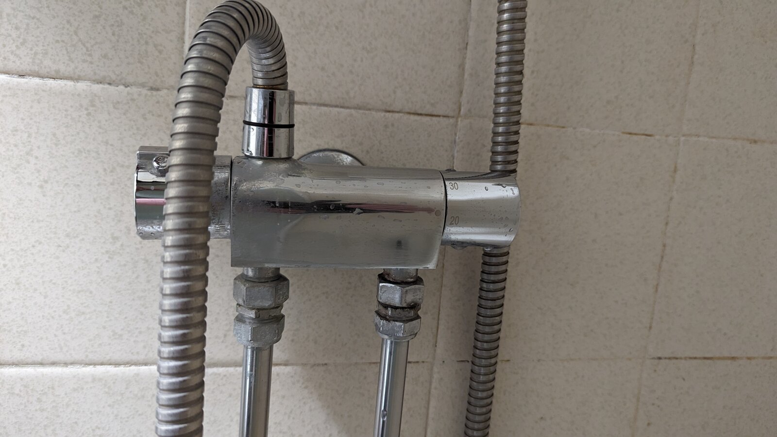

Hi everyone. Our shower controls are old and we cannot read any of the settings on them, plus they look a bit tired, so I want to replace them. The problem is, I cannot quite identify the type I need, and so can't find any replacements online. I have attached a couple of photos, showing the separate hot and cold water pipes coming up the wall, which will stay, to the bar valve (?) at the top with the controls, which I want to replace. I can find lots of bar valve types, but they all have the inputs coming directly into the back from the wall and not from underneath like mine. Any help with tracking down a replacement or type would be very much appreciated! Matt
If you want to replace with a bar type shower do a web search for shower back plate elbows.
Existing pipework may need a bit of adapting but easy enough.
