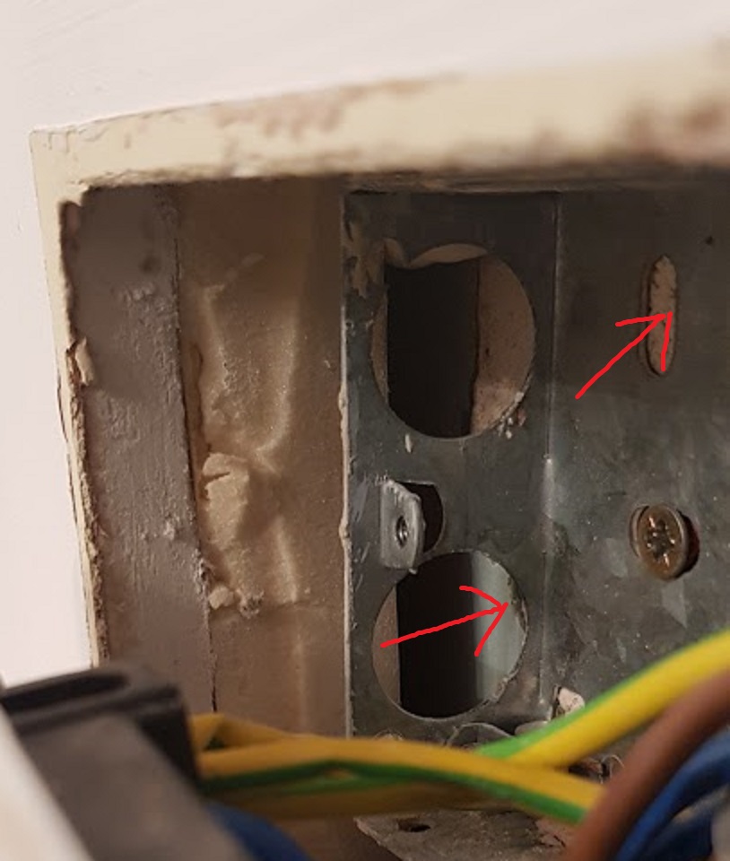

I'm trying to locate the studs in a plasterboard wall to mount a 75" TV but so far with no luck.
I've attempted to use a stud finder, but upon drilling into the wall where it locates a stud I'm finding no more than the 15mm plasterboard seen in the pics below.
It seems to be locating "studs" about 250mm apart, which seems too frequent.
Additionally, there's a slight vertical crack running up the wall against which I'm told there's a fairly good chance there'll be a stud behind it, but drilling through again I seem to hit about 15mm of plasterboard with nothing behind it (judging by the material left on my drill bit).
Additionally, I can't seem to find any screws joining the plasterboard to the studs using a strong magnet I bought for this purpose.

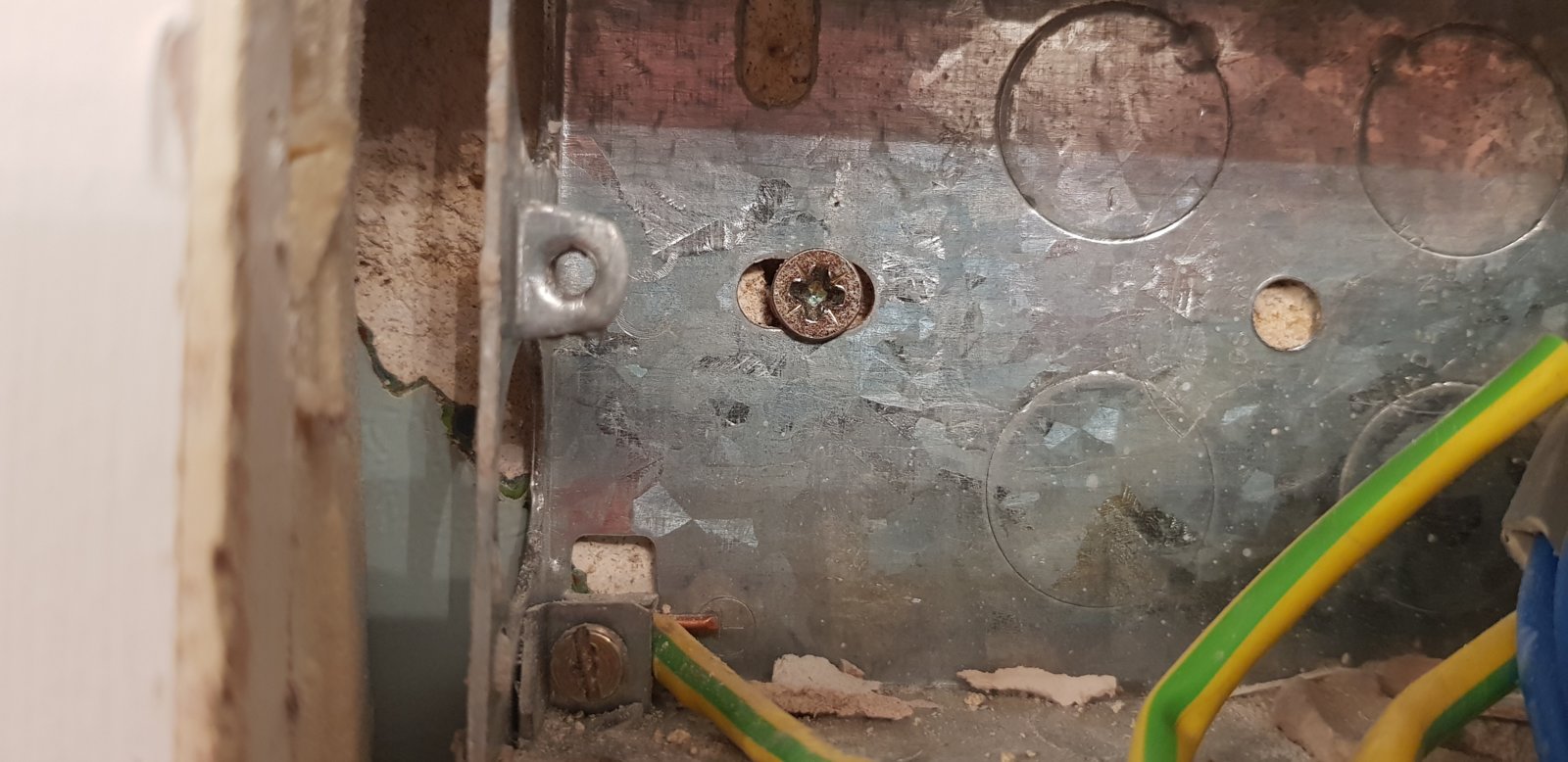

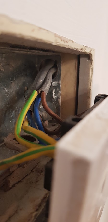

I've taken a look behind one of the power sockets situated dead centre of the wall (centered both width-wise, and height-wise) but I can't make out the construction. It looks like there's...
A solid brick/mortar wall (to which the backbox is screwed to).
A void of 10mm or so.
Insulation of 20mm or so.
15mm plasterboard.
...does anyone have any suggestions on how best to approach this?
If you are 100% certain that the back box is secured into masonry and it's not a 'paramount partition' (i.e. very thin walls, you would be able to tell by looking at a door frame reveal), then you must have a "dot & dabbed, insulated foam backed plasterboard and masonry wall". So no studs/battens to fix into.
You want Rigifix fixings for that type of wall. Any 'normal' (but long enough the reach the masonry) fixing can pull in the plasterboard and crack because of the gap behind it, as you tighten them up.
If you happen to drill through an "adhesive dot" behind the foam insulation, then good, that fixing will be even stronger!

Then it really ought to be proper solid bricks, but looking through the knockout holes in your first picture, something just doesn't look right, even zoomed right in.
You say you've tried two test holes already and found this gap. What happens when you drill further/deeper? You're going to need 100mm drilling depth to use the Rigifix M6 size, if it's still very soft, then stop, you might end up with a hole through to the bathroom!

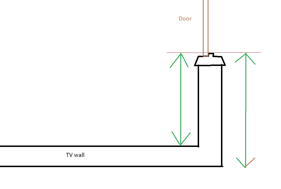

I can't see any way to measure the thickness.
Measure from the bathroom door jamb inside and out and calculate the difference. This really is important due to the unusual photo.

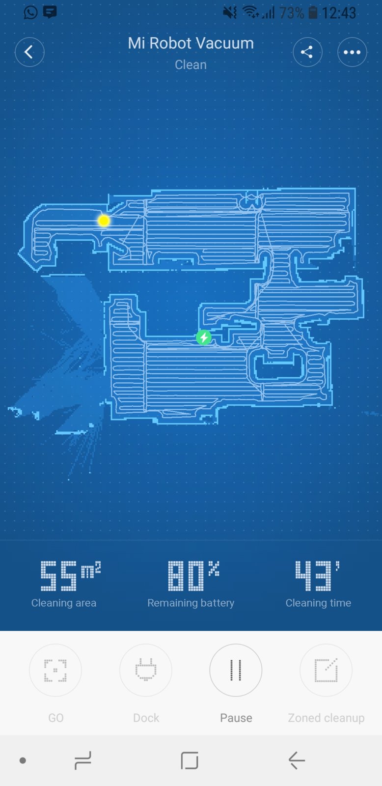

Unfortunately my earlier description was an oversimplification. Fortunately I have a map available for illustration.
The green circle below sits on the wall in question (running horizontally, left-right). The big void behind it where the vacuum never made any tracks is where the bathroom is.
I hope you can see it's a bit more complicated than measuring the door frame.

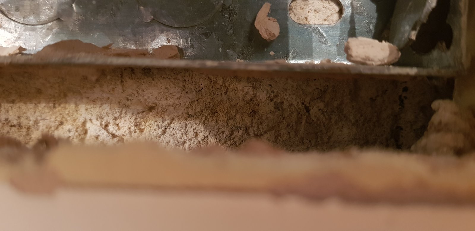

OK, using a screwdriver (approx 4mm flat), poke into the wall hard with a twisting motion here and here....
Soft and mushy? Or brick dust/mortar and can't penetrate?
Can't penetrate, so I think I have the answer and a few Rigifix have been ordered - thanks!
Looks like some sort of concrete brick, overlayed with a thin layer of green (painted) plaster. Whatever it is it's definitely hard to penetrate and barely chips away.
Ah, that's much better. It was the colour that threw me, it looked roughly the right colour for thermalite blocks, but without any texture, which don't exist! So your walls will be approx 18 to 20cm overall thickness.
You might not be out of the woods yet, under that original plaster will probably be proper 'old school' bricks, extremely difficult to drill into without an SDS drill, likely the same as the bricks on the outside of the property.
