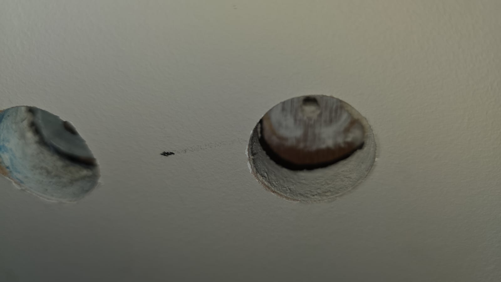

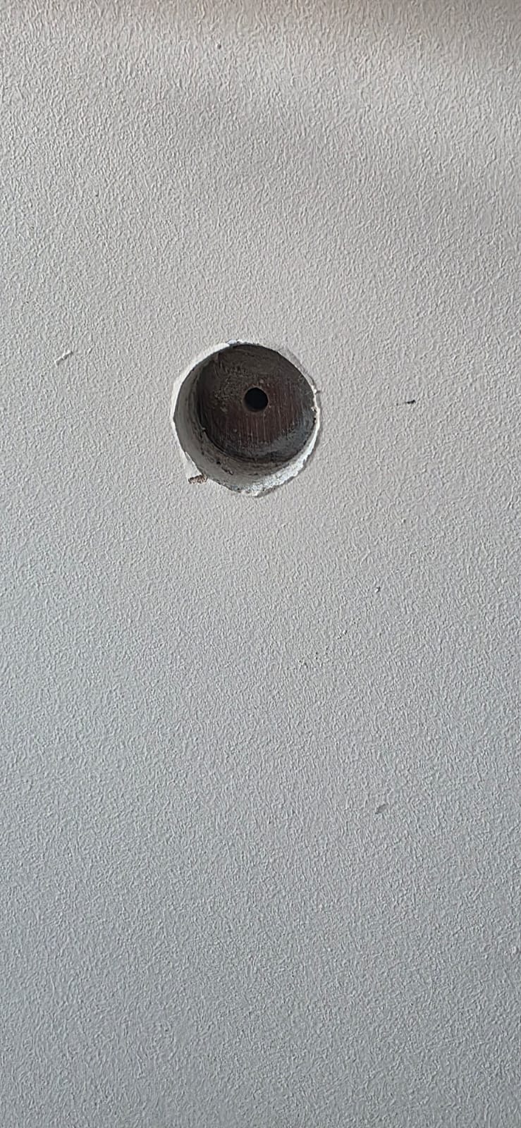

Update:
Those Geefix fixings....I drilled my first hole and hit a batten, tried a second hole, metal stanchion. third hole - bingo! another batten
There is a small void between the plasterboard and the batten, so direct fix is out as the plasterboard will flex and I now have a 1" hole so a corefix fitting is out of the question
So I now have four 1" holes and need some way to fill them with some kind of spacer. I'm torn between widening the holes a tiny bit to 28mm and then using an old curtain pole as spacers, otherwise buying some nylon or aluminium 1" rod and cutting that down
Any other ideas?
Regards
Tet
Am I missing a trick?

I have battens, but I have a void as well. If I fix my bracket with coach bolts for instance then I will be tightening the bracket and crushing the void. I'm looking for a spacer to directly compress the bracket onto. In theory I could do it with a dozen or so large washers, I'm thinking that a wooden or aluminium rod would be preferable
Am I incorrect about the bracket and the crush?

Any other ideas?
Use a 1" hole saw (the same thing you used to make the hole??) to bore though a bit of wood the same depth as the hole, which will leave you with a 1" plug of wood with a hole in the middle i.e. a very fat wooden washer
Like the sleeve of a corefix fixing, only better at spreading the load from screwing your bracket on
