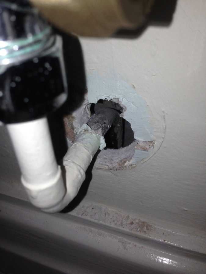

Hey all, I've had to change a central heating radiator in our spare room as the bleeder snapped off.
I've had to go from imperial to metric, and I understand I will need extensions to fill the gap.
The problem I have is that the new radiator sits further away from the wall than the old one did, it's on the shortest bracket option so there's not much I can do there.

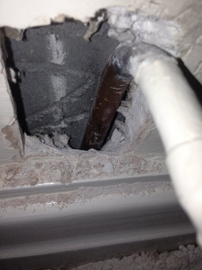

Short of getting a plumber to cut the pipe and extend this a tiny bit I have decided to hack away at some of the plaster to see how much flex was in the pipes.
It turns out I can pull the pipe forward now and it should mate up with the rad connection, but obviously when I let go of this it will just spring back to where it is sat now.
My question is, can these copper pipes be pulled and connected like this? Or am I likely to put too much strain on it and cause it to leak? Without knowing how this pipe travels behind the wall or if it's a solid section or has elbows soldered to it leaves me in the dark.
Here's some pictures. Thanks.
How hard are you having to pull the pipe to get it to line up? Does it feel loose and springy or are you really having to pull on it ? Can you lift a floorboard to check?

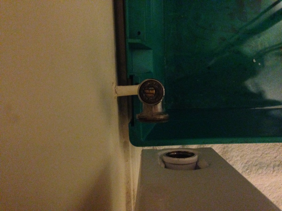

I think you've fitted a double when a single radiator was in place, yes?
11 replaced with 21?
If you'd bought another 11 (single) it would fit
I wouldn't want to strain the pipes personally.
Sorted it.
Yes it's a double radiator but slim profile.
By the time I put the radiator extensions on they only had to be pulled back a few mil to be right.

It's a P+ rad , could you give us more pictures please mate I can't tell what you need to do :LOL::LOL::LOL:
Obviously looks shyte , should of altered pipework to suit.
Tails obviously pizzed and going into rad @ an angle.
Pet hate of mine , a sign of a good fitter being pipes straight into valves.
