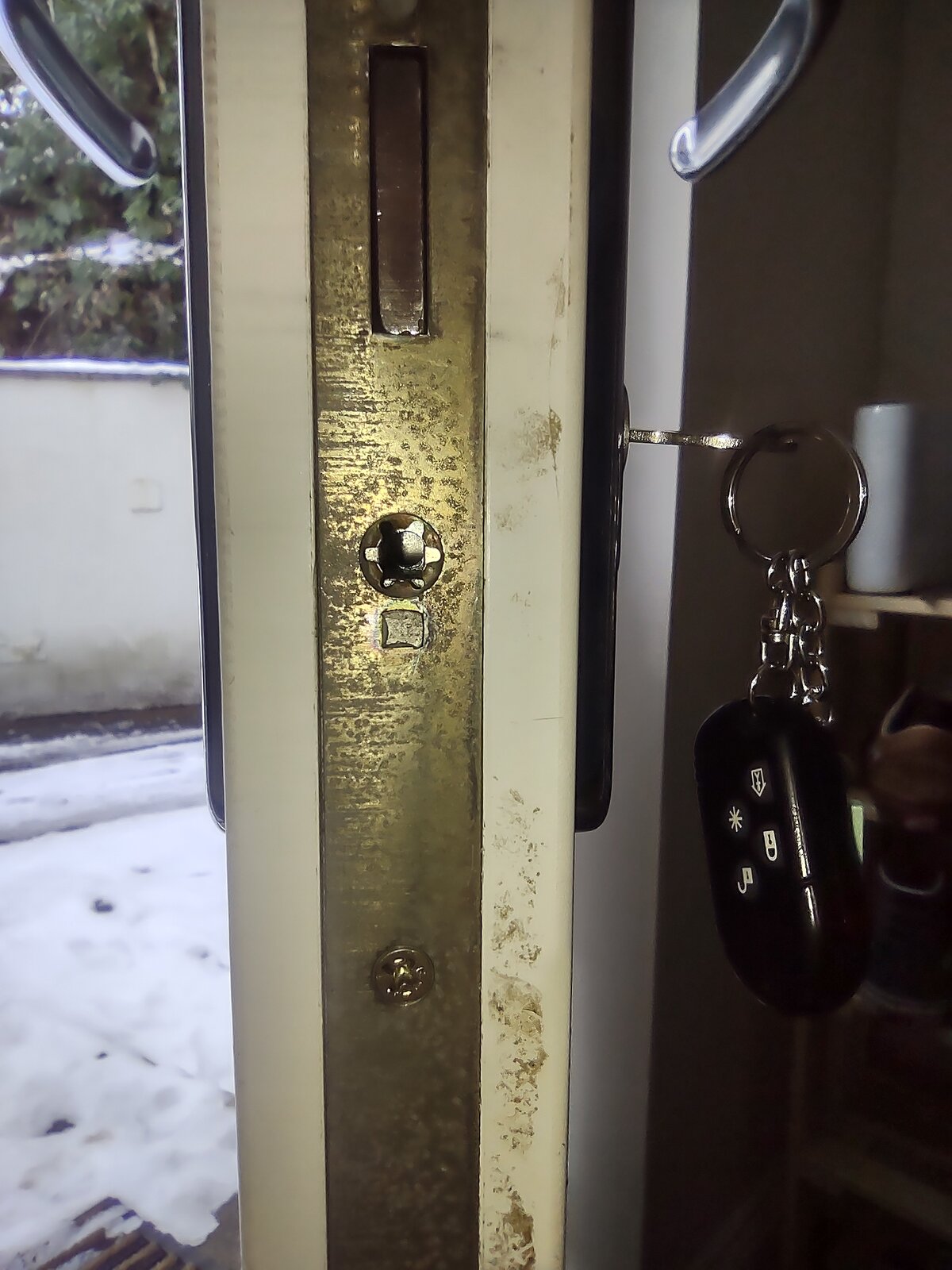

Hi, can anyone help me figure out how the remove this lock cylinder please? I can see parts moving when the hand is lifted. There doesn't seem to be a screw in the hole but it's difficult to see in. Thank you.
Thank, yes am trying to get the lock cylinder out to measure. It does look like a torx screw but I'm not sure that that part is moveable as it looks like it's part of the surrounding plate. Will have a look
That (Torx) screw is the barrel retaining screw. Removing it frees the barrel, you then have to put the key in the barrel and turn it slightly one way or other before you can pull the barrel out.
When you get a new barrel to put in you should get an 'anti-theft' one and then insert it the right way round; you will need to read the notes regarding that.
Just need to rotate key slightly to align internal arm and remove, helps to gently tap the other end of the barrel as they can stick , while you turn key.
So when you pull the handle down, you can see a hole there? If so it's an allen key ...probably a 2mm, but maybe 3 , I can't remember of the top of my head.. but yes it is a bit of a blind hole, shine a torch in it. Just try allen keys till you get one to fit!
