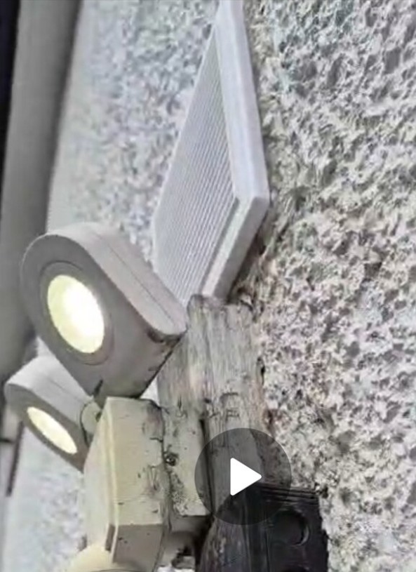

Yes this is the idea we liked but an electrician said you can't put a hole above the window but the window runs to where the blinds start so only about 20cm from the ceiling and also you would need to cut a hole though the concrete that holds the window and wall in place. This is what the electrician said and why it can't be done this way. Not sure if he's correct or not.
If that were true, which seems very unlikely, then the boiler flue has been installed, cutting through the lintel above the window. The boiler flue diameter, will be maybe a touch smaller than your extract flue, but so long as it misses the lintel, you're fine. I also note the boiler flue has a bit of a gap above it - your flue/duct needs to be up against the ceiling anyway. That supposes you are using a round pipe, a flat pipe, will need even less height.

The ducting can stop before the pipework using two 45% joins to pull it flat against wall again ,run along roof and exit through the vent already there .
Or take of existing grill and fit a powerful wall mounted extractor .

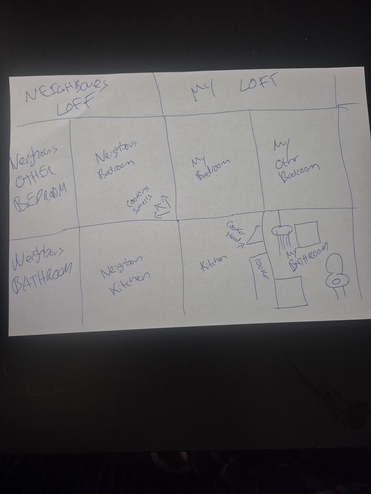

You still haven't posted a floorplan, and this info coming out in dribs and drabs is incredibly tedious, but at least we now know you own the room on the other side of the wall, which makes it feasible to duct up and into the busy corner in the kitchen then go through the wall very near the corner so all there is in the bathroom, if anything, is a bit of duct crossing through in the corner of the room. That may then be possible to hide with coving, a corner shelf etc
Alternatively, if you post a floorplan with joist directions annotated we will be able to see if it's possible to go through the joists above the bathroom because they're clearly shorter and don't need to be as strong
Post a floorplan with neighbouring rooms so we can see what is on the other side of the wall furthest away from the cooker
You clearly know how to post a photo so get a pen, draw some hasty rectangles on a piece of paper repeating a floorplan and take a photo of it and post the photo
Ive drawn a floor plan for all to see here.
We donr get smells In our bedroom above our kitchen.
My neighbour was at door yesterday telling me the smell is still very bad in his bedroom from our cooking. He said he could even smell our cooking when he was standing at our front door.

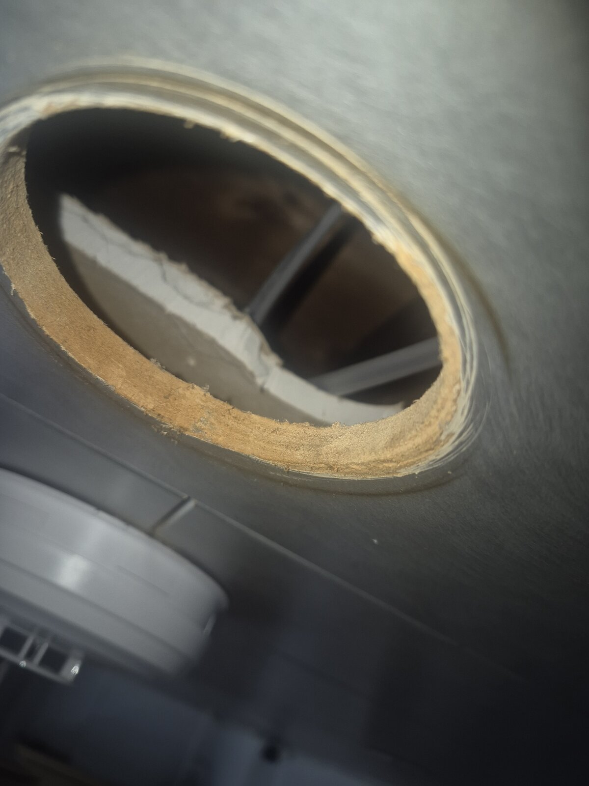

There are holes in the real ceiling above the false ceiling in our kitchen which previous owner made I presume to fit in down spot lights in and somehow the neighbour knew this and said he would like us remove false ceiling and to seal those holes up in teal ceiling. Pleqse see photo as you can see the white part which is real ceiling has been cut. He wants me to do this if me sealing the edges doesn't work.
But surley there must be holes in the partywall that should be sealed and that's more important and more likely to resolve the issue than me sealing the holes up in the real ceiling?

He invited me into his bedroom and I could smell the smell along the skirting board along the floor, where it is on the picture I drew. So it is genuine.

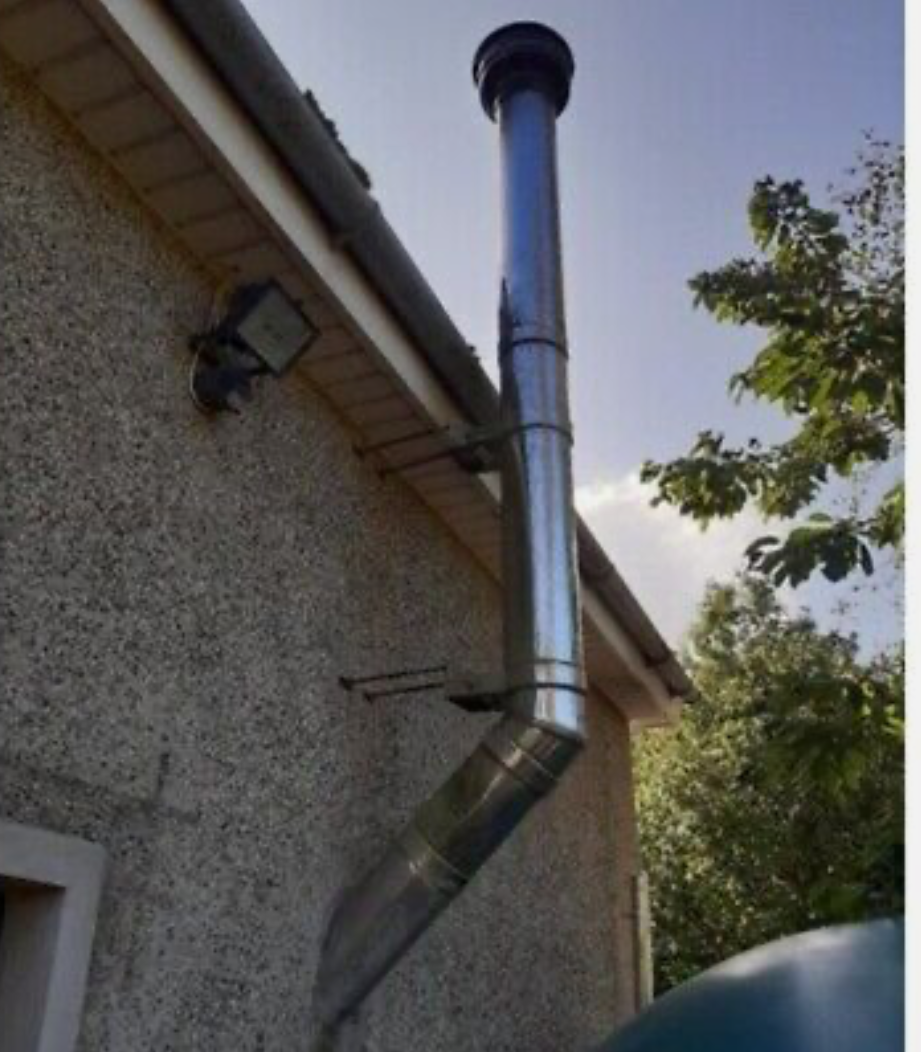

If you do it a better way & duct it through the outside wall, all neighbours will get it. A ridiculous way around it is ducting it up a lined chimney if you have one or an external pipe up the wall, like restaurants have to do.

We do smell neighbours cooking coming into our windows from the house to the other side. Doesnt bother us. Just lasts a little while. The smell doesn't bother us from our own cooking outside. I am guessing there's no way to avoid smelling the cooking smell other than to have ducking like robin has a photo of, so jt goes all the way up to the roof. But that seems a little extreme. Plus wpuldnt the air pressure be lost as it would have to travel much futher? Hence be less effective?
The only reason we would consider doing this is if it was of any benefit to us ie we wouldn't smell our cooking when we open the back door or are sitting on our decking. But crucially when it's gusty or windy the smell would still be smelt by him and us and would still blow into his windows. Which leads me to think we also have a pipe coming out for the gas boiler and when the gas boiler gives off a little gas smell at times when first turning on and our window is open we always smell it so that means even with a pipe vent wind will still blow it in.
Isnt it the case that if we added the external pipe it is still going to be blowing and coming out? How will it stop the smells blowong back into the windows or our back door when open? Is it because it will be directed higher up? And will help reduce the smells? As it will be blowing a bit of a different direction?
I did ask the conpany who did all this work and they didn't recomend doing this. They said the wind would still blow the smells around and if anything would be smelt by him more as would be higher up closer to his bedroom window. They also said rain and dirt would get into it but don't see how as it wouod have the exact same flat cover on it. They also said the air pressure wouldn't work as well as it would have to travel futher and therefore not be quite as effective? Is this true?

Exactly as a previous poster said, the best way to deal with this would be to have a vent pipe running up the side of the building to above eaves height, the idea being that the smells are vented high up away from windows so they disperse, the same principle as stench pipes. You don't want a rain cap on an extraction duct as the cap will create resistance to air flow so you'd need a drain on the bottom of the vent pipe or a water ingress damper of some sort.
