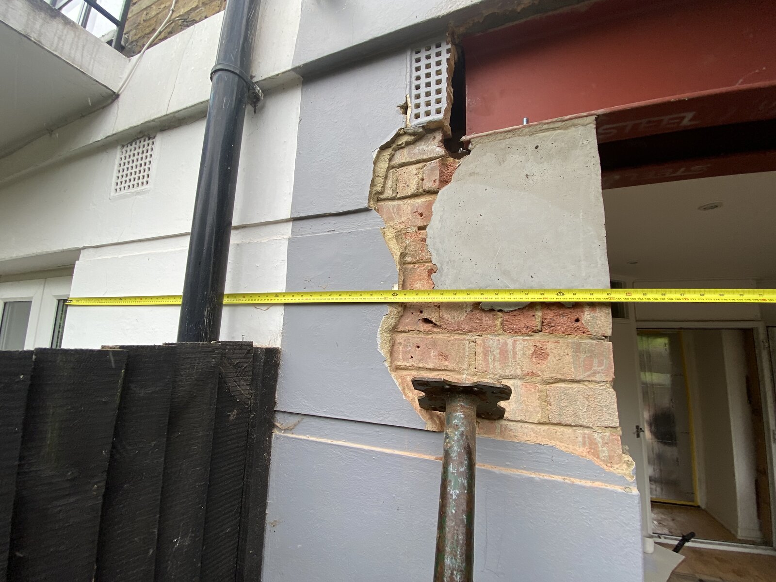

Got a funny neighbour who first objected our planning application and now refused when I ask for access to finish the extension wall which is sitting on my side of the boundary.
She emailed and said:” I do not give you permission to remove my fence” after I offered to address all of her concerns and offered putting a temporary fence in place.
Below is a picture shows the wall with the adjoining neighbour which measured at 161cm. Builders’ view is that the boundary should be at the mid point which is 80.5 from either side which is exactly where the downpipe is positioned. I think the fence was misplaced historically due to the position of the downpipe and our deed does not specify where the boundary is.
Appreciated if anyones got any views on where the boundary should be and how I should proceed from here? If the boundary is the mid point then the fence is clearly on our land and we have every right to remove and carry out the work thoughts?

The issue is less the boundary position than the problem with your small minded neighbour.
I personally would diplomatically explain to your neighbour the fence is yours, on your land and you will remove it to do your works and replace it afterwards.
I think you need to explain politely what you will be doing and when, then just get on and do it. What can the neighbour do about it?
If it’s on your land it can’t be her fence
and if it’s not on the deeds, then she has no proof it’s her fence….although of course the neighbour may have paid for it.
Any idea how long the fence has been up? Historically it was polite to give the neighbour the ‘nice’ side, but more recently whoever is paying chooses to have the nice side.
Far from definitive, and not all that helpful. Sorry!
As Notch says, just get on with it. It can’t be trespass if it’s in your land, and if you remove & replace the panel carefully it can’t be criminal damage.
Ownership of a fence, paying for it, responsibility for a boundary and a fence's position on or near a boundary are all different things.
The neighbour may well own the fence even if it's not on the boundary.
Thanks for all the responses. We’re planning to crack on but is it worth to get a surveyor to determine the boundary line in case we get solicitors involved?
That won't work.
Why should a neighbour believe your surveyor? Why would your surveyor be correct?
Boundaries are legal disputes requiring legal intervention, the surveyor wil just provide opinion.

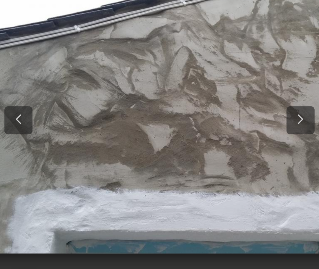

Thanks Woody. Thought about it but we’re using blocks for both inner and outer cavity wall and building control asking for rendering? Do you think they’ll accept pointing or shall we go with bricks without rendering?
To finish the rendering of the wall as the space between the fence and cavity wall is only 10cm.
That's plenty of room to smear some dreadful lumpy render on with a small trowel - just write back apologising in advance and enclosing some pictures of what they could have had - no doubt a nice K-rend finish, and what they will be getting - something like this, which will be the best your builders can do under the circumstances:

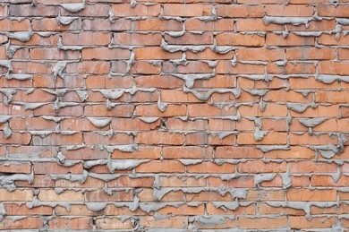

Tell your neighbour you will be forced into this and that the wall will look a right ugly, mortar smudged mess. See if you can find a photo to illustrate.
And this would be the only time I'd recommend using crap bricklayers. :rolleyes:
Something like this or nice and smooth and painted. Just give them the choice.
