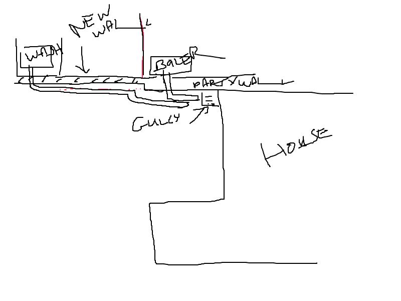

Hi,
I am wondering what the regarding this situation is. We just purchased a house and have now noticed that the neighbour has run water wastes (from washing machine in their garage which backs onto us) and their boiler condensation pipe into our waste water gulley.
Are people allowed to do this? Would they have needed written permission from the prior owner? What is the legal situation on this.
The bolier condensation pipe runs through a boundary wall and we are thinking about building up to the party wall concerned, and also moving all the gulleys. Obviously this will start to create an issue.
Thanks for your thoughts and experience!
Pictures would help as it is hard to picture your exact scenario. What type of property is it? Where are they in relation to your property (i.e. joined next door neighbour) or neighbour behind your property? Maybe a diagram if you can't take pictures.

Many thanks, here is a very rough mouse drawn picture :)
The main wall is a party wall. The drainage works and new wall are recent (within 10 years).
The new wall appears to have been build about 6 inches back from the boundary (presumable to stop it becoming a party wall.
As regards neighbours, I'm 100% with you in terms of communicating. We have only taken dissension last week and so am planning what to do. We have met the neighbours and already chatted about things in general in a friendly way.
These sort of things (party walls, drainage into some one else drains etc) is all a new area for me so just trying get my head around it, hence posting on the forum.
From the original conveyance when the property was split in 1938 the adjoining property is allowed to use the drains / gutters etc as was at that time. Of course these extra outlets have been added since 1938 (combi boilers and washing machines not being very popular then :) )
Well, First you should maybe determine if the drain was originally/or is a shared drain. Even then I would still seek advice from a chartered surveyor. Looks for a RICS surveyor in your area.
Keep the neighbours onside and try to approach positively i.e. our building surveyor noticed this, and suggested this as a way to solve it. Rather than "you need to move this because you should not have put it there in the first place."
You will probably need to move the drain system anyway if your building up to the party wall (if I am reading this correctly the back of their house joins the side of yours?). So you just need to work out a compromise, the only issue may really be the boiler flue & waste pipe and drain, they may need to redirect the flue through their garage with a flue extension. In fact as the "new wall" is set-in, they may be able to redirect externally it down that small gap anyway.
If it does mean they need to change something at their cost, you have to decide if there is a compromise you can reach (i.e. you contribute to the cost or pay all of it), or you say that they have to pay for it (because it should not be there) which could strain relations. Sometimes it may be worth a compromise as falling out could just cause more complications and cost you more in the long run.

You are totally correct in that we would have to move the drain anyway.
The boiler flue isn't an issue, it looks like it had previously vented through the party wall, but is infact now vented through the side wall and angled away, at a level above the 'new wall'.
The main 'issue' if any would be some how re-routing the condensation pipe, which may be possible through the 6 inched of 'side wall' at the ground floor level (new wall joins party wall).
