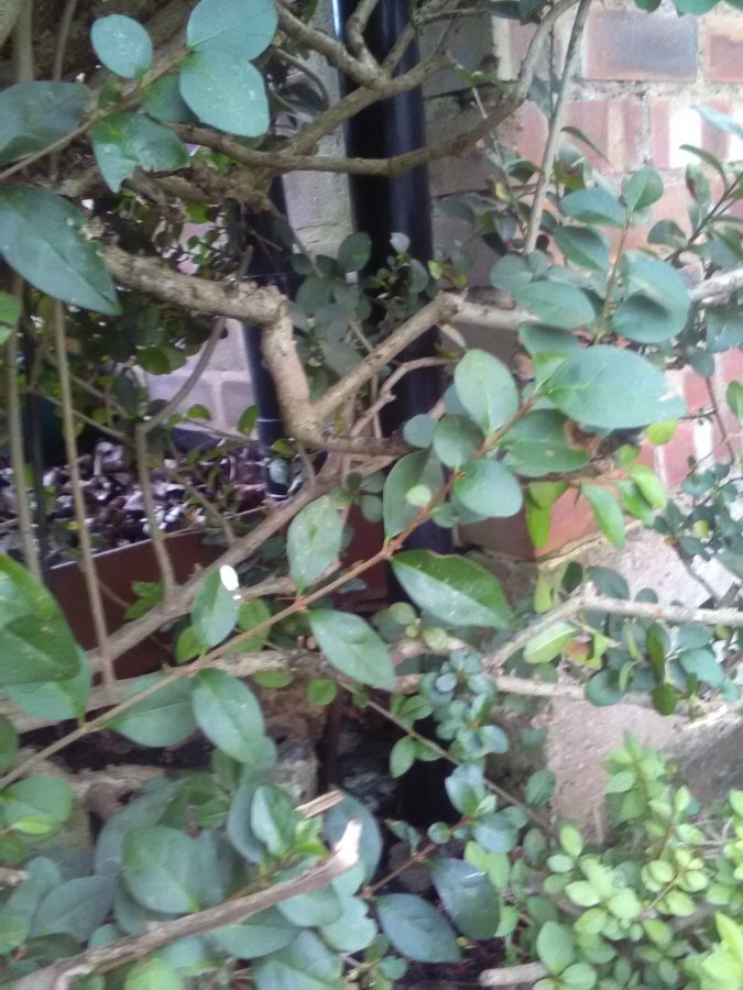

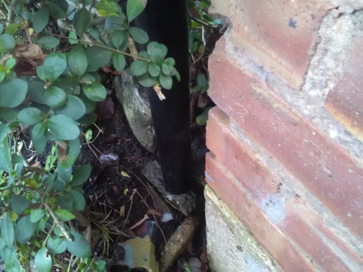

    Just went out back took a couple of situation there this is her downpipe totally sitting in our garden. Sorry they aren't brilliant because of the hedge IMG_20161114_160447.jpg IMG_20161114_160437.jpg

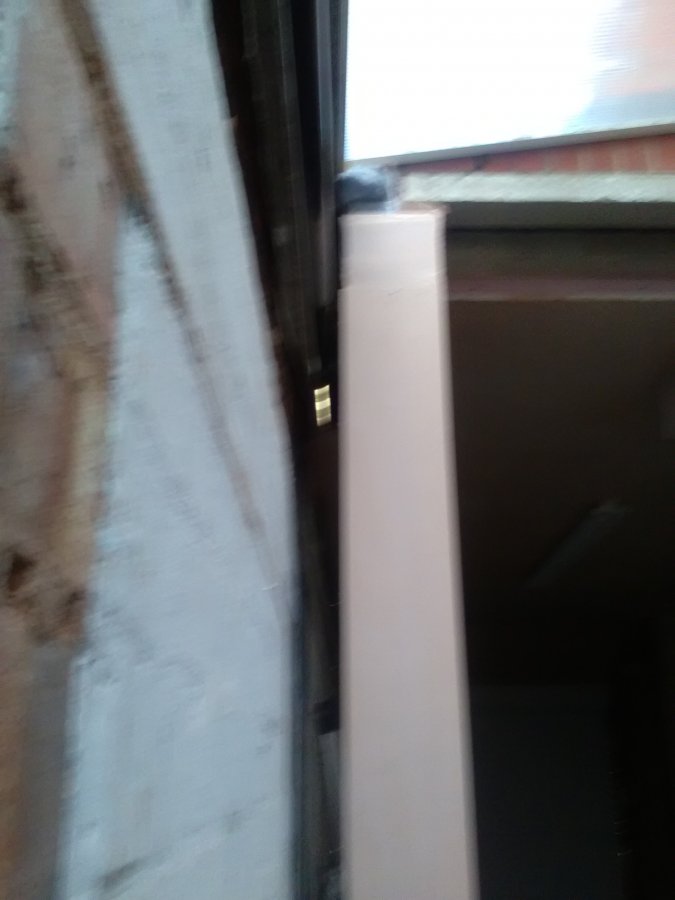

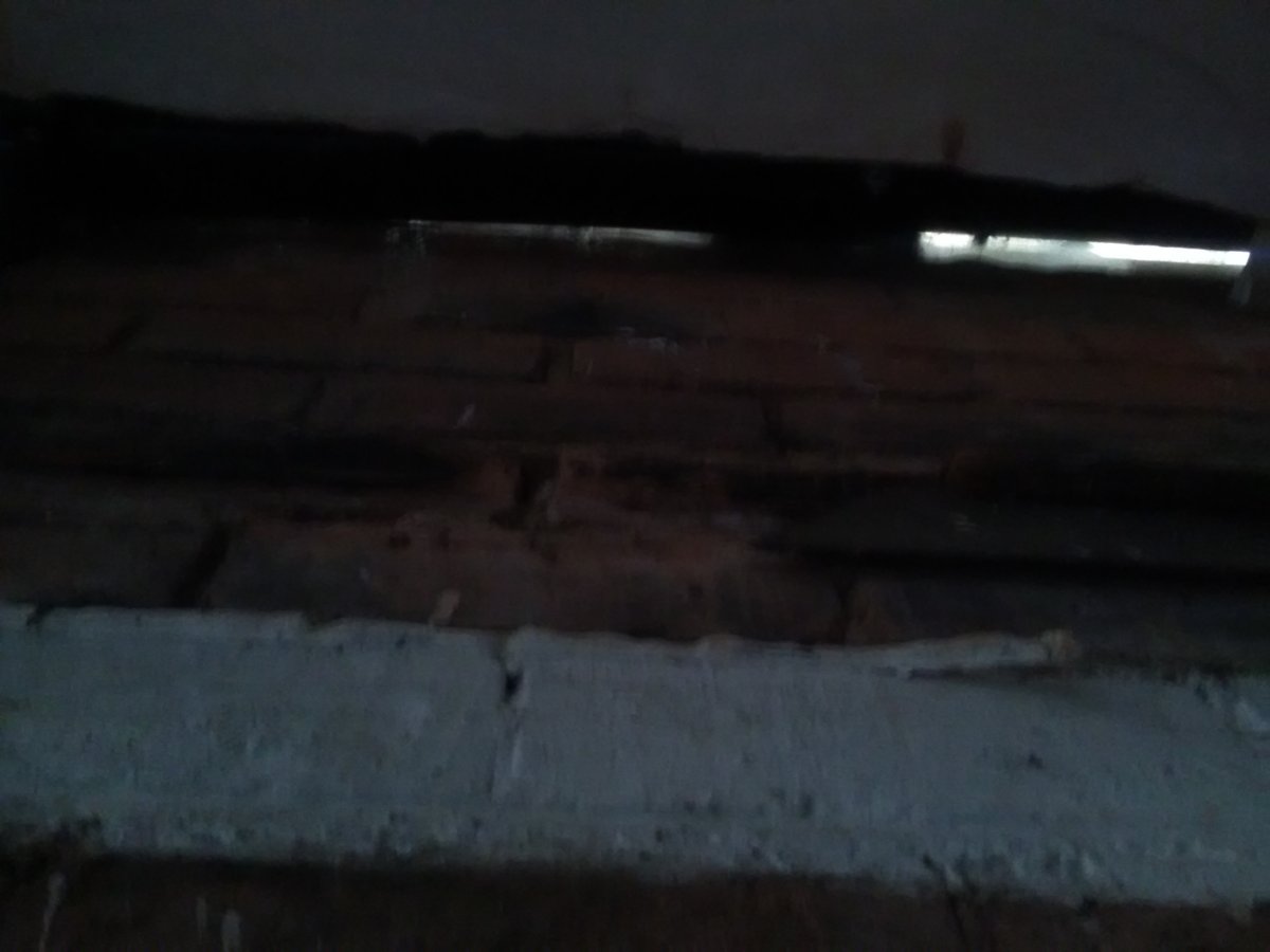

    This is situation inside our garage looking up to show where we can't seal our property because of her roof and guttering inside our garage. I need one out front without neighbours watching! IMG_20161114_160352.jpg IMG_20161114_160326.jpg

    Did you take the pictures with a cornflakes packet?

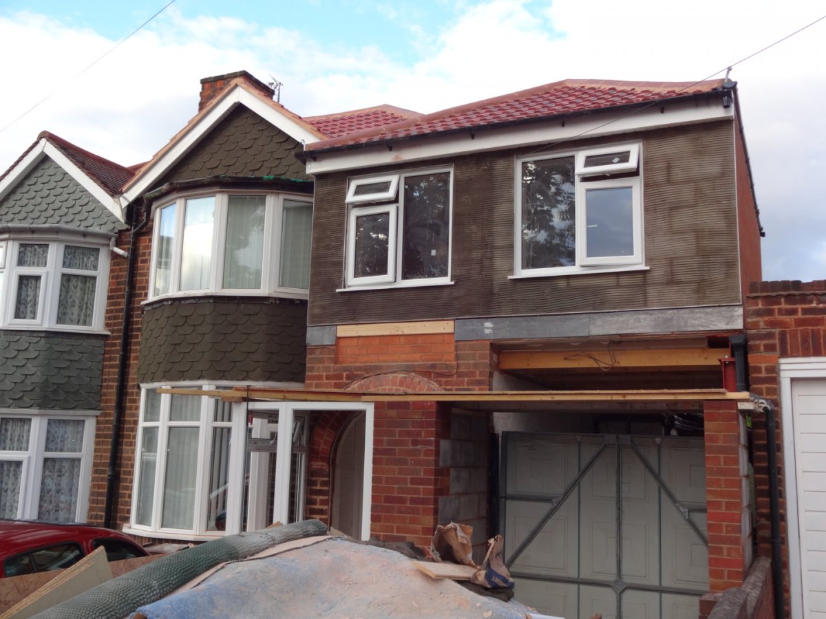

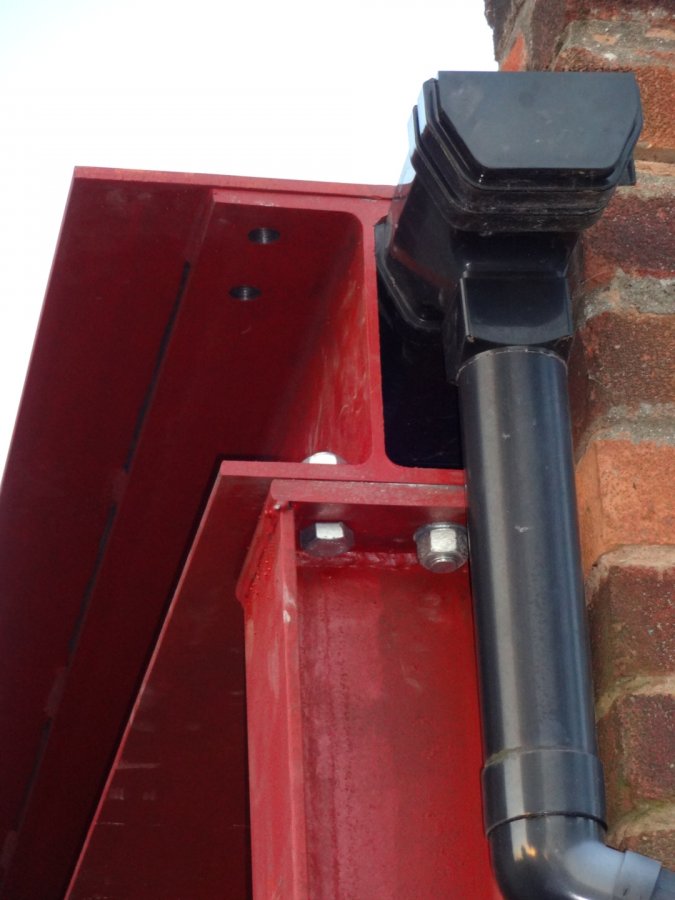

    I've found some better photos to explain the situation and show the neighbours guttering runs over inside our garage and is now sitting inside our extension within the steels. The photos don't show this but her corrugated plastic sloped garage roof is also hanging inside our extension. This is a big issue for us since having the extension as we can't seal our house. As above there's also the situation at the back with her downpipe pointing into our garden and as she has no drainage We are taking her neighbours water too. We don't know who to turn to anymore. I'm at the point of a nervous breakdown.

    How long has the guttering been there? The neighbours garage looks quite old.
    In a nutshell if the guttering has been there for at least 20 years they have probably acquired the rights to keep it there so it would be down to you to make them an offer to change the roof, probably requiring you to pay. If it is less than 20 years and there are no express easements permitting it then tell them to remove the trespass.
    Rather unfortunate that it has got to this stage without it being resolved, makes you wonder what the designer had in mind when he drew the plans. It looks like you will need to form a box gutter along the neighbour's side which can be quite tricky if trying to cut into an existing roof.
