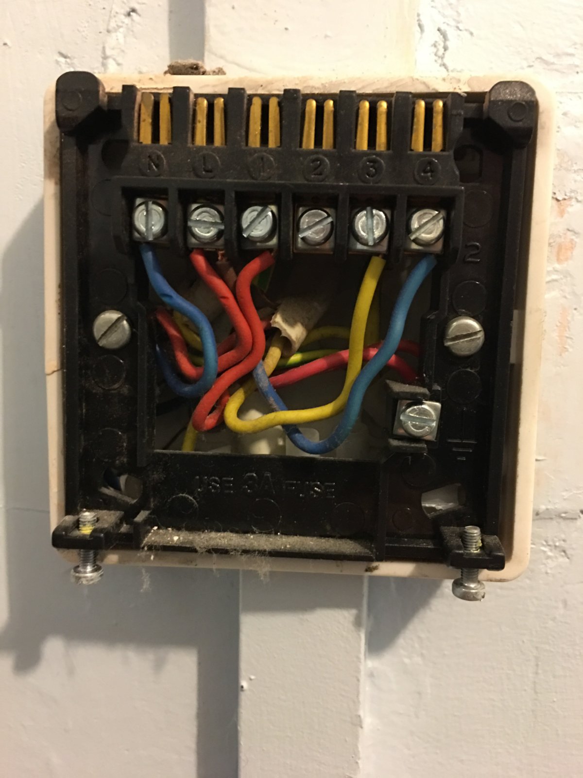

Existing wiring diagram of the LP522:

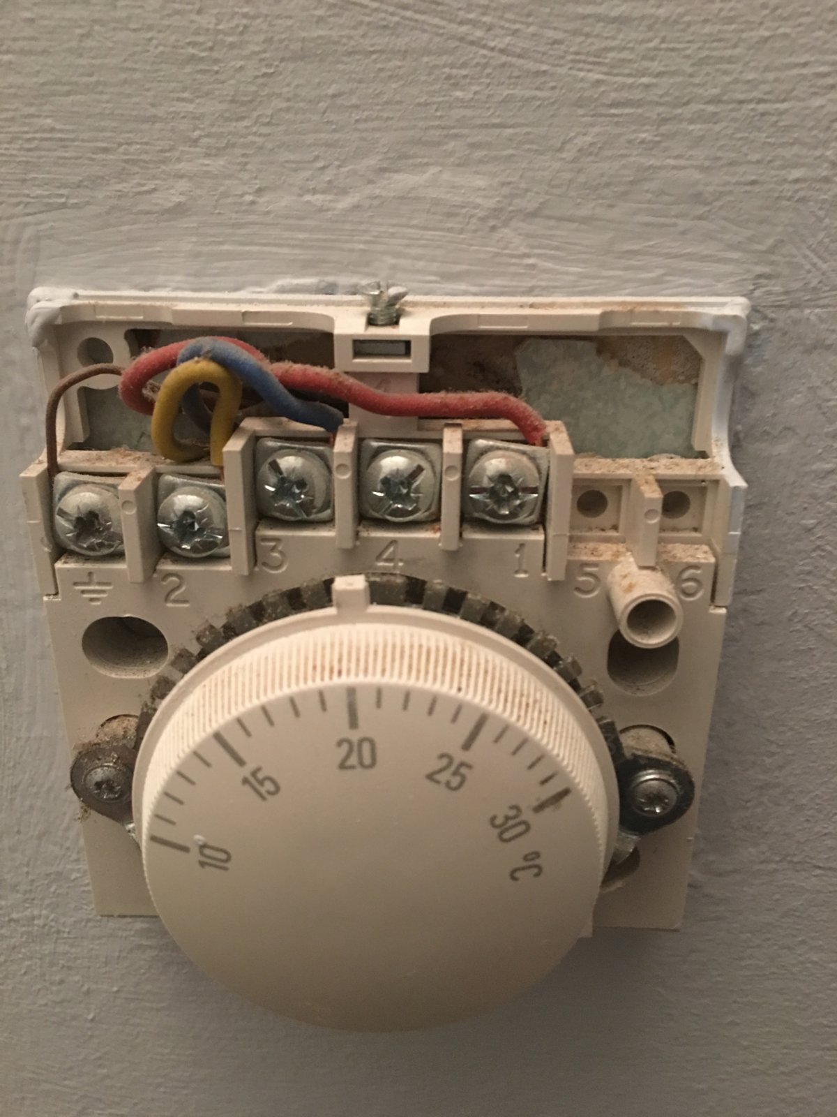

Existing wiring of the honeywell:

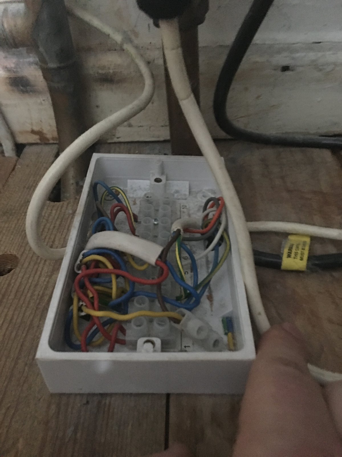

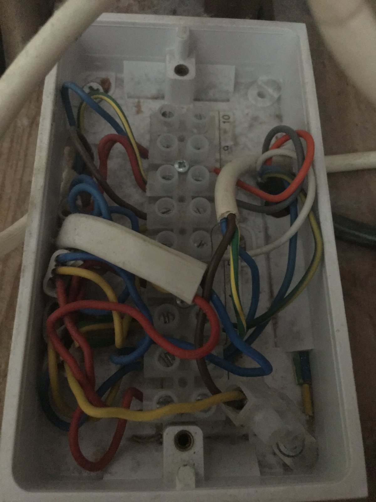

From my understanding by reading various similar discussions I may have to "rewire" or modify the connections of the wired central unit where the tank resides. I hope that this is not the case and i will be able to accomplish my plan without this. Is this possible?
Here is the wiring of the wired central unit next to the tank in the airing cabinet:
Could you please advice the wiring arrangements required for the LP522-> Heatlink & Honeywell -> nest display?

The LP522 wiring terminals are thus:
lp522-jpg.141746
The existing wires are simply moved from the terminals of the LP522 to the terminals of the Nest Heat link that have the same function. Don't worry about terminal 2 not having a wire in it, very few do. If your system doesn't need it now, you won't need it with the Nest.
heatlink-jpg.141747
So:
LP522 N = Heat link N
LP522 L = Heat link L
LP522 1 HW off = Heat link 4 Hot Water Satisfied
LP522 3 HW on = Heat link 6 Hot Water Call for Heat
LP522 4 CH on = Heat link 3 Heating Call for Heat
The Heat link common terminals (2 & 5) need to be wired with links to the Heat link L terminal
The Nest thermostat can be powered by wiring it to Heat link T1 & T2 terminals, or alternatively by using a separate plug in 12V power supply for it.
The existing wired room thermostat can't simply be disconnected as this would leave the heating wiring 'open circuit' and it would not operate. So you can:
1. Leave the existing room thermostat in place and set it to its maximum setting and leave it there, this will prevent it overriding the Nest. Or,
2. Find the origin of the thermostat cable. Note where the wires are connected and disconnect the cable. Then link the terminals where the two ‘live’ switching wires came from together. (This will probably be in the wiring centre) The Neutral, is simply disconnected. Or,
3. Remove the existing thermostat and replace it with a junction box, connect the two ‘live’ switching wires together and isolate the neutral. Or,
4. Leave the existing room thermostat in place and join the ‘live’ switching wires together in a separate connector that you can tuck away in the corner of it.

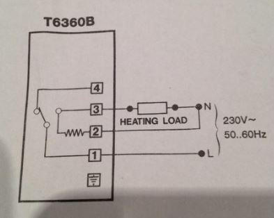

Your existing thermostat looks like a T6360B if it is, the live switching wires are connected to terminals [1] and [3] as can be seen from the diagram below. This diagram should also be printed inside the thermostat.
Check the thermostat carefully though, because if it is a T6360B different wiring colours to the norm have been used for wiring yours up. Normally red and yellow are used for the live wires that go to terminals [1] and [3], yours uses red and blue instead. But it will work provided they are also transposed at the other end of the cable.
