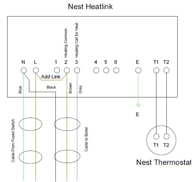

Hello everyone,
I have a Worcester Greenstart 24i Junior combi boiler installed in my house.
I'd like to wire a nest 3rd gen thermostat.
The programmer wiring:
The thermostat dial wiring (RTS1):
It looks like the fused switch is wired in a programmer unit:
So switching off fused switch cuts off power to programer and combi boiler.
My question would be how to wire the nest heatlink? Seems that there are too many wires in this programmer or is this normal? Thank you.
That's a perfectly normal installation. At the moment, you have separate controllers for time and temperature of your heating, Nest combines the two functions into a single unit. Usually the Nest Heat link is installed in the place of the programmer. All of the existing wires from the current programmer are moved to the Heat link terminals that have exactly the same function. You should have the wiring diagrams for the existing programmer and Nest and so as to be able to work it out.

I am going to wire the nest thermostat to T1 & T2.
Boiler connections:
LR: Grey
N: Black
L: Brown
Ground: Green and yellow
What would be nest Heatlink connections:
N: Blue (coming from the fused switch)
L: Brown (coming from the fused switch) and Brown (coming from the boiler)?
1: Nothing?
2: Grey(coming from the boiler LR)?
3: Black (coming from the boiler)?
4: Nothing?
5: Nothing?
6: Nothing?
OT1: -
OT2: -
Ground: Green and yellow (from the fused switch) and Green and yellow (from the boiler)?
T1: Nest thermostat T1
T2: Nest thermostat T2
Basically, the way it's set up nest heat link would be in the middle between the fused switch and the boiler? That's what confuses me.

It's just being used as a junction box, L N & E in from the FCU and L N & E out to the boiler, just keep the wires connected as they are.
Whenever there are two items wired to the same fused switch, then unless they are both wired directly to the fused switch, one will be a junction box for the other. It matters not which one it is.
Fused switch.....>Heat Link......>Boiler
Or
Fused switch.....>Boiler......>Heat link
Probably not a good idea to connect a black wire currently in the Neutral terminal of the programmer to Terminal 3 of the Heat link which is a live connection!
Here's a diagram for you. Easier to understand than my waffle. No need to touch the wiring at the boiler end and the old thermostat cable can be removed once disconnected. :)
And finally just to check both ground wires Green and yellow (from the fused switch) and Green and yellow (from the boiler) go to the same Earth connection in the Nest heatlink? Thank you.
Actually the Nest instructions say that the earth at the Heat link itself is only necessary if you connect the T1 & T2 terminals to the Nest Thermostat T1 & T2. However for earth continuity, the earth wires from the fused switch and the boiler must remain connected together. Once the room thermostat cable with earth wire will have gone, you should be able to get the remaining two into the Heat link earth terminal.
As they are stranded wires, be careful that there aren't any stray whiskers of copper poking out from the terminal which could touch another terminal. Heat link terminals are quite small and close together.
