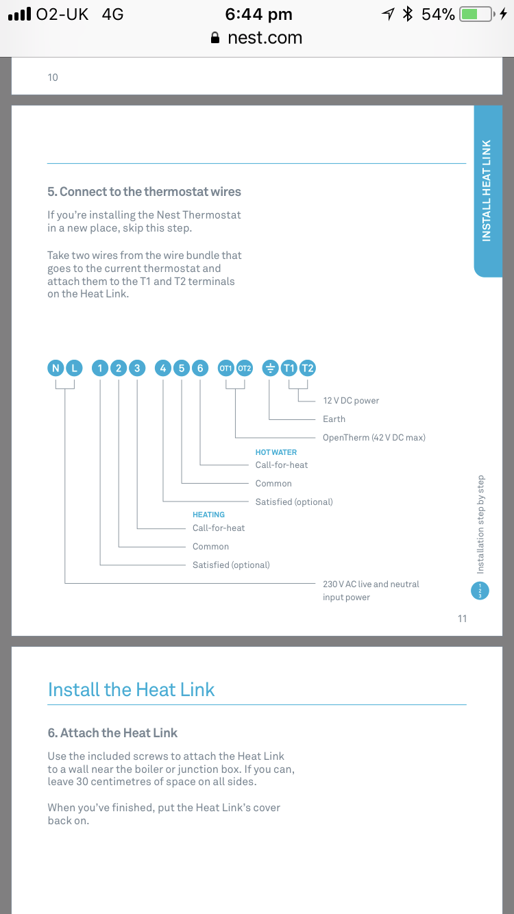

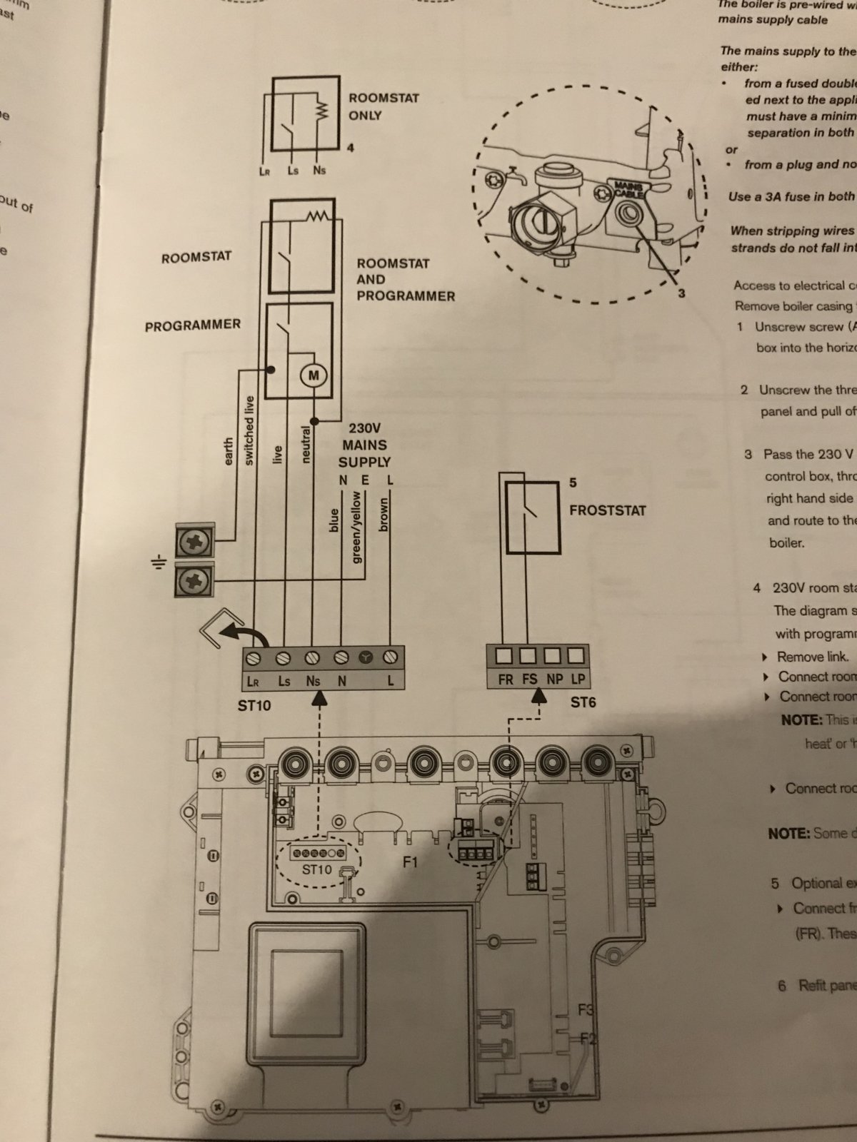

hi need to connect a nest heat link to my Worcester Bosch Greenstar 30si 2008
I am only interested in the heating not water so should be 3 cables
Can someone just confirm my thoughts of where I connect too
Diagrams below
Many thanks

Fitting a Nest to a WB has been covered frequently already on this forum. If you use the search facility you will be able to locate them. There's an example here.
