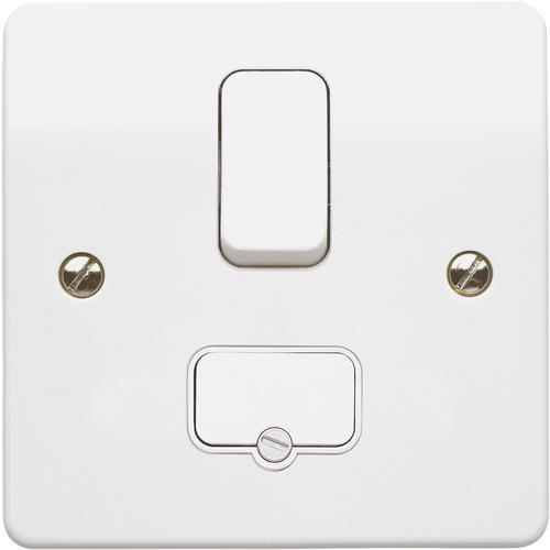

The Heatlink should be connected to the same Fused Connector Unit and 3A fuse as the boiler. This is so that the same switch isolates them both. Otherwise there is a risk that someone may turn off the boiler FCU to work on the system thinking it is electrically isolated, but the Heatlink is still connected to the mains power. You don't have to make the connection inside the boiler it can be connected directly at the FCU. Whilst what you suggest will work, it's not good practice.
Thanks Stem.
FCU?
If I were to hook into the power feed to the boiler... is that the FCU?
The 'Fused Connection Unit' will look something like this. It contains a switch and 3A fuse and will probably be located adjacent to the boiler.
The idea is that the same unit supplies the boiler and any associated components (eg Nest Heatlink) connected to it.
Other makes are available ;)

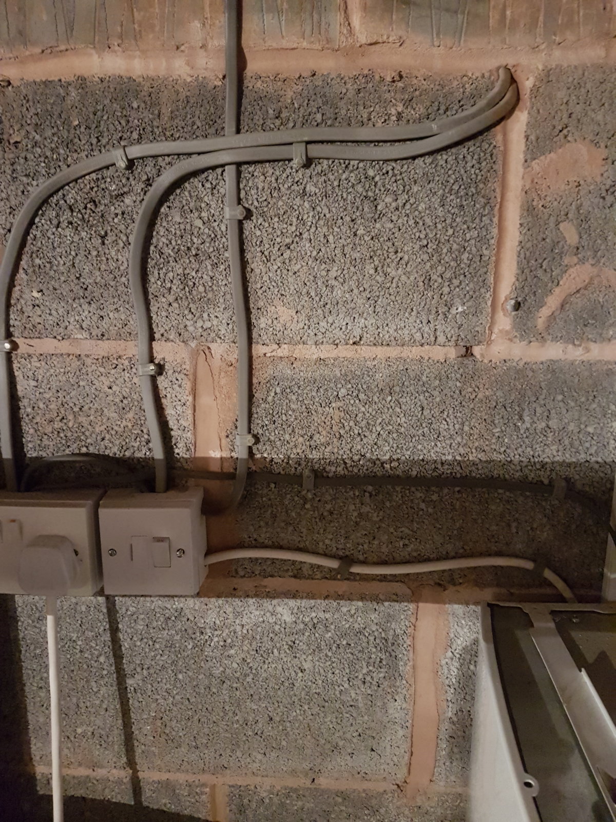

That's my FCU... power in and out and the link to the old thermostat in white and out going up from the right hand side of the fcu.
