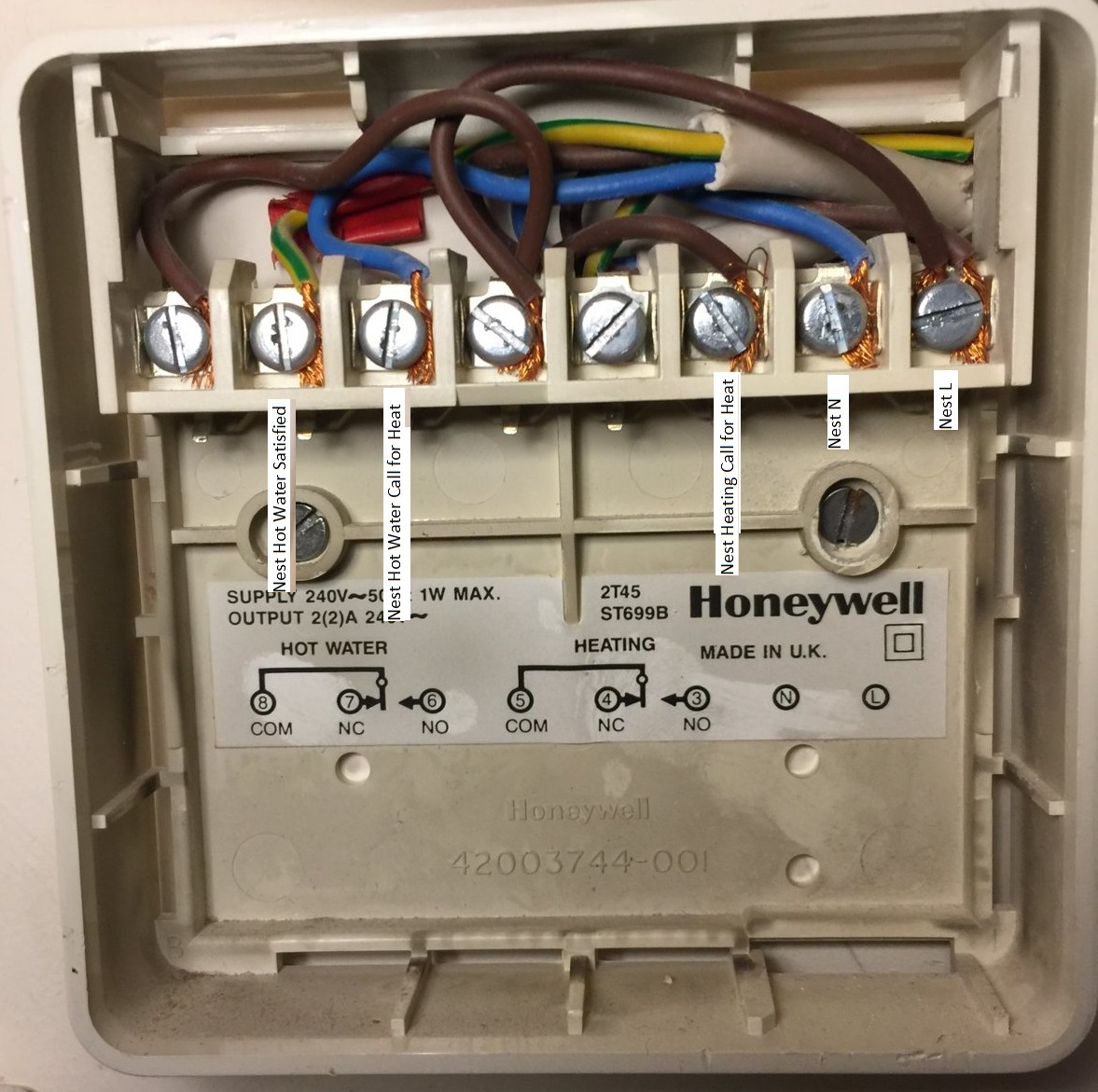

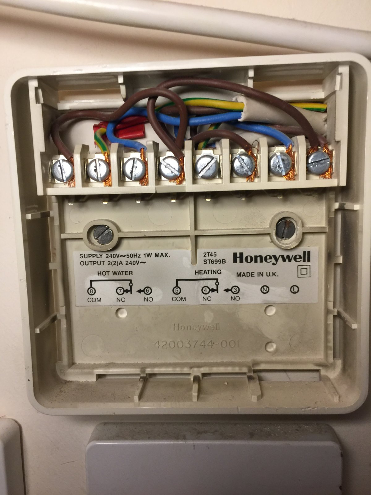

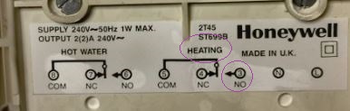

Attached is a pic of my Honeywell ST699 as it was (working perfectly)

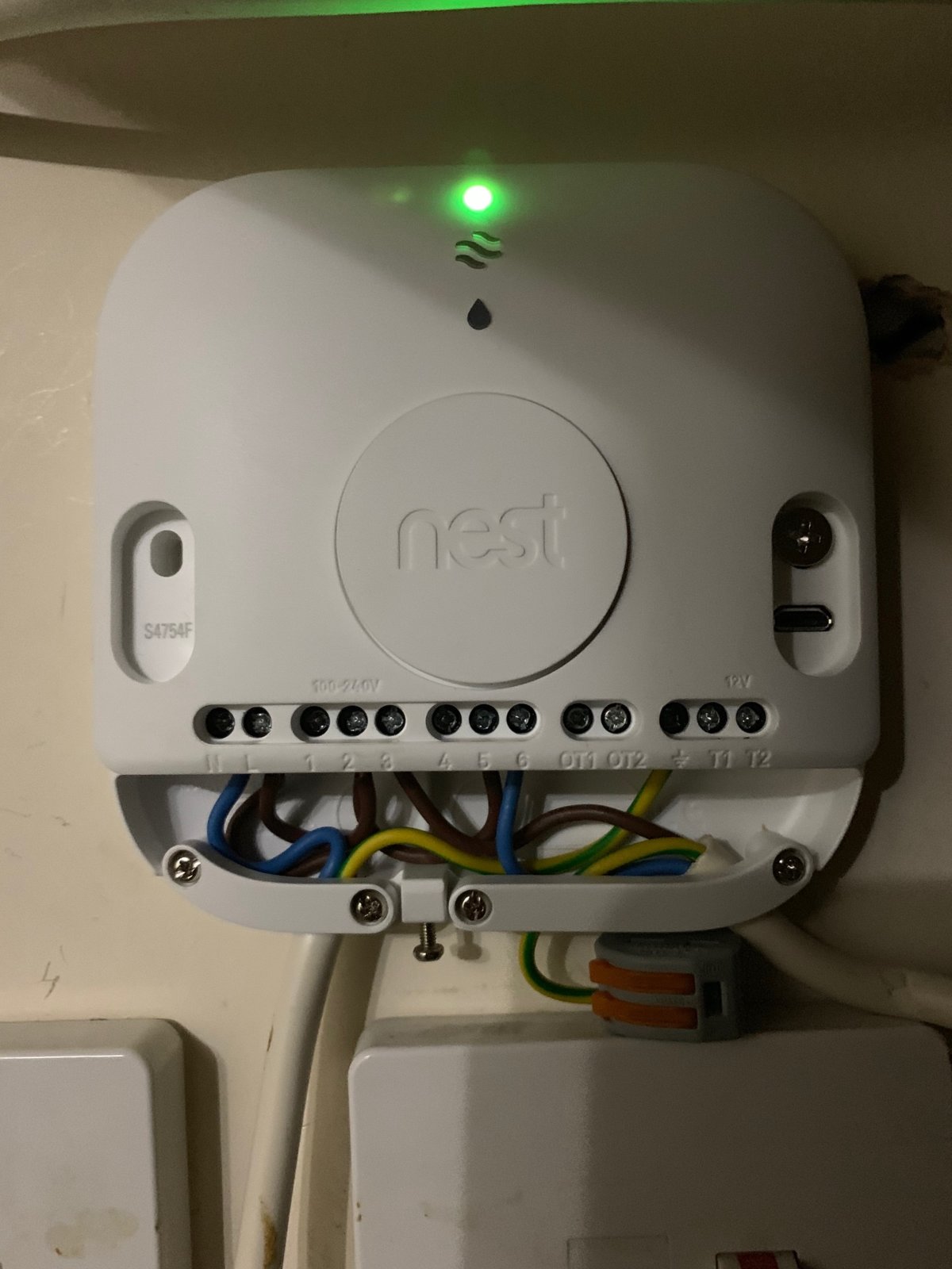

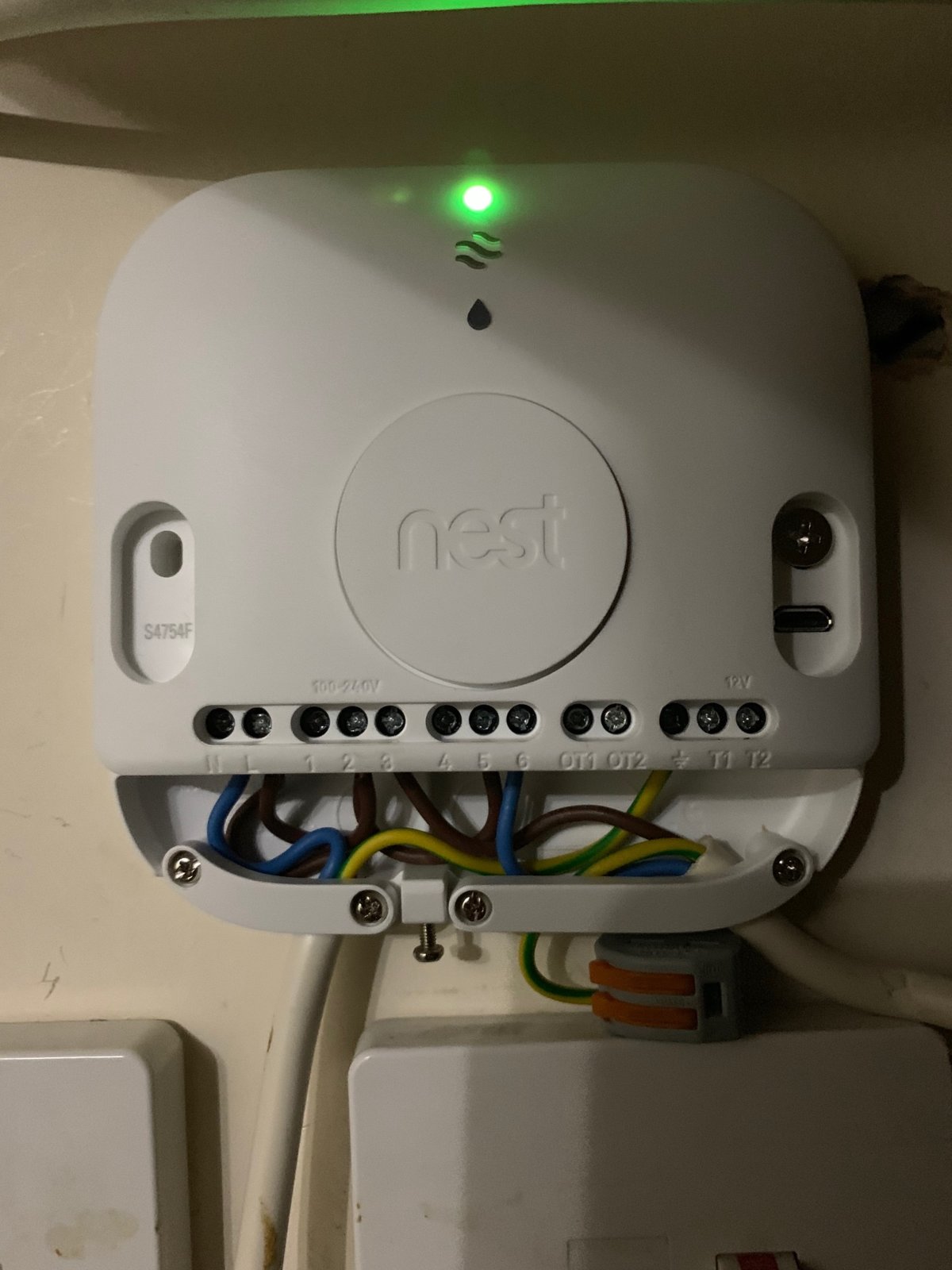

Attached is a pic of my Nest Heat Link as it is (not working perfectly)

I had 2 cables going into the ST699, one from a fused spur (which also powers the wiring centre), and one coming back from the wiring centre. I have put the L, N & E from the spur into L, N & E in the Heat Link. I have then put jumper cables from L in the Heat Link to 2 and 5 Common in the Heat Link . I then transferred the 3 core cable coming from the wiring centre into the Heat Link as below:
I transferred L from terminal 3 Heating NO - terminal 3 Heating Call-for-heat
I transferred N from terminal 6 Hot Water NO - terminal 6 Hot Water Call-for-heat
Finally, the Earth (which had red tape wrapped around it???), which is going to terminal 7 Hot Water NC on the ST699, I transferred to terminal 4 Hot Water Satisfied on the Heat Link.
Everything appeared to fire up OK, but the boiler constantly fires up an then shuts down after a couple of minutes, despite the Nest Thermostat still calling for heat. It's as if the boiler is responding to the tank thermostat (no hot water is being consumed, so the tank is almost at the desired 70C all the time)
I decided to remove the 'Earth' cable from terminal 4 in the Heat Link , to see if it made any difference, but it's still the same.
As you'll see, the 'Earth' cable is currently in a Wago block below the Heat Link.

the earth wire was being used as hot water off. that needs to be in terminal 4. i guess the old room stat if it has one has been disconnected/bridged out in wiring centre. if there was a room stat. that cable could be connected to the heat link so the nest doesn’t have to be plugged into a socket

Hi, many thanks for your response. Yes, I did put the earth wire into terminal 4 on the Heat Link, but it didn't make any difference. The boiler still keeps shuting off, despite the Nest Thermostat calling for heat. Also, I haven't yet disconnected/bridged out the old room stat in the wiring centre, I just set it to 30C. I'd like to transfer the room stat wires into T1 and T2 on the Heat Link, so that I can put the Nest Thermostat on the wall, but I haven't identified which cables they are yet. Also, the wiring centre is about 500mm from the Heat Link, so I'd need to extend the cables.
The links at the Heat link between L, 2 and 5 are correct.

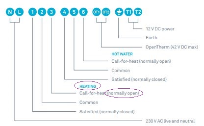

The existing room thermostat should really have been decommissioned by removing it and linking the terminals where the live and switched live wires came from together. Alternatively as a temporary measure, you can set it to set it to its maximum setting as it appears you have done.
Apart from the blue wire in the N terminal, the green and yellow wire and the other blue wire have been used as hot water control live wires. They should have at least been identified as such by fitting a brown sleeve over them.

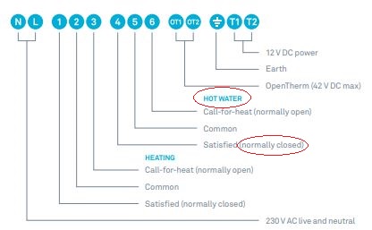

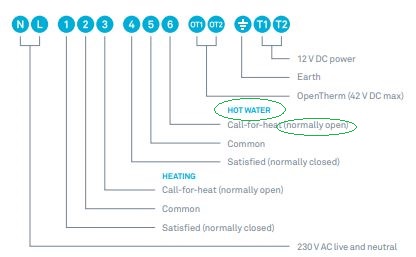

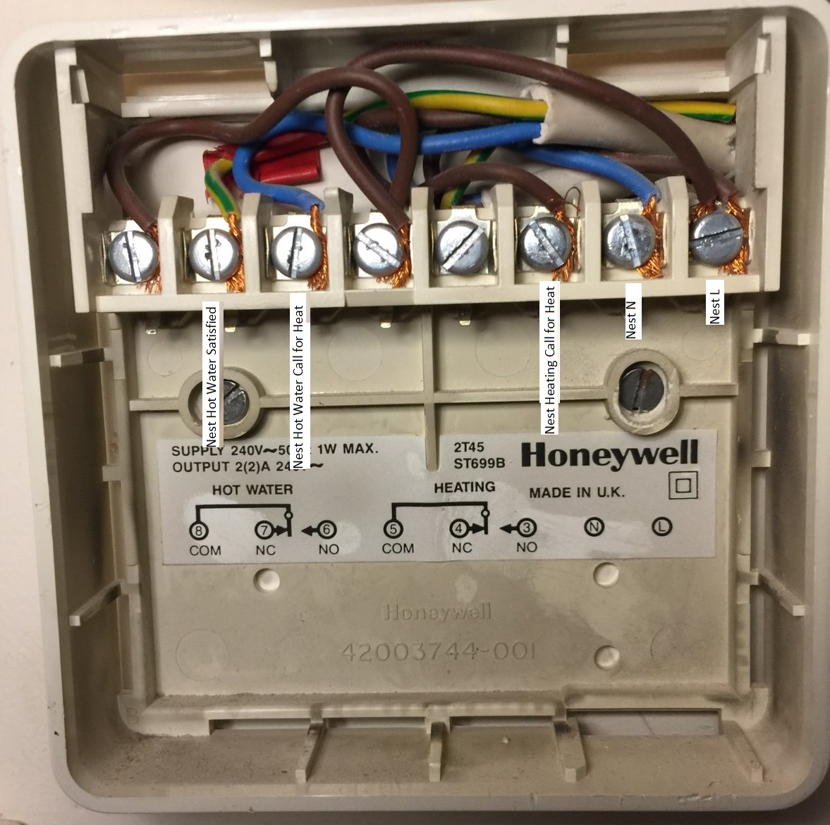

The diagram is definitely right, so you can't have installed it correctly. Both the Honeywell and the Nest terminals are clearly marked with the appropriate connections. It's straight forward to move them across from the Honeywell to the Nest. Even if the wires were not labelled correctly, if the Honeywell was working as it should then the wires would have been in the correct terminals.
Hot Water 'off' [NC or normally closed] control wire (green/yellow with red tape on) presently in Honeywell 7 = Nest 4
Hot Water 'on' [NO or Normally Open] control wire (single blue wire) presently in Honeywell 6 = Nest 6

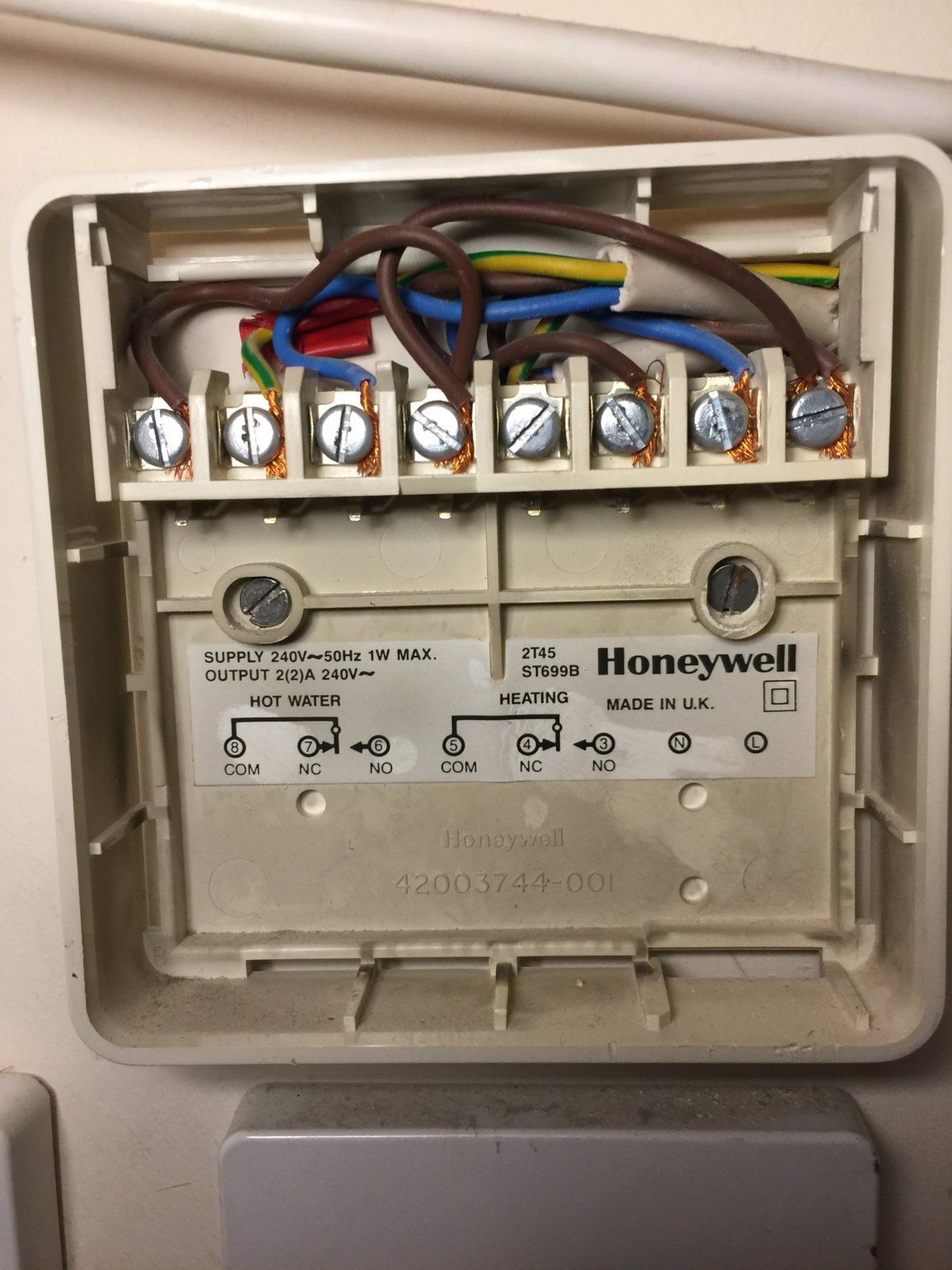

Heating 'on' [NO or Normally Open] control wire (single brown wire) presently in Honeywell 3 = Nest 3
N to N and L to L are self explanatory, so no photo's required.
Did you also include:
And was the existing room thermostat taken out of service properly?
If the above was all done correctly, either one or more of the wires was not properly terminated, the Heat link is faulty, or the Thermostat and Heal link not configured properly.
Some extra information might have been helpful. In what way didn't it work? Did neither the hot water or the heating work? Did the Heat link not power up at all?
Hi Stem, I re-installed it and it's now working properly. I wired it exactly as before, so I must have caught one of the wires on its sheath or something - as you suspected. Thank you so much for all your help (and patience!)
