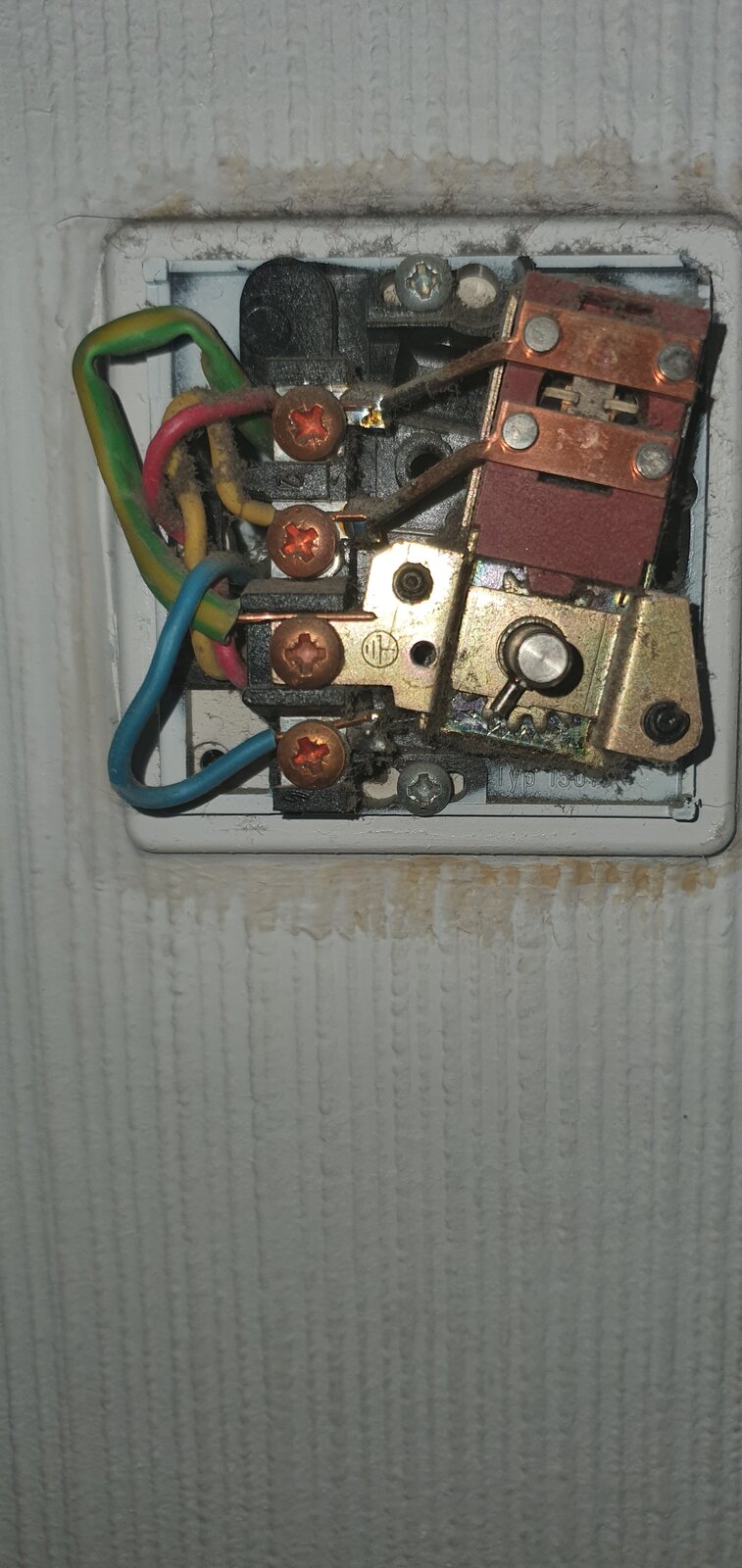

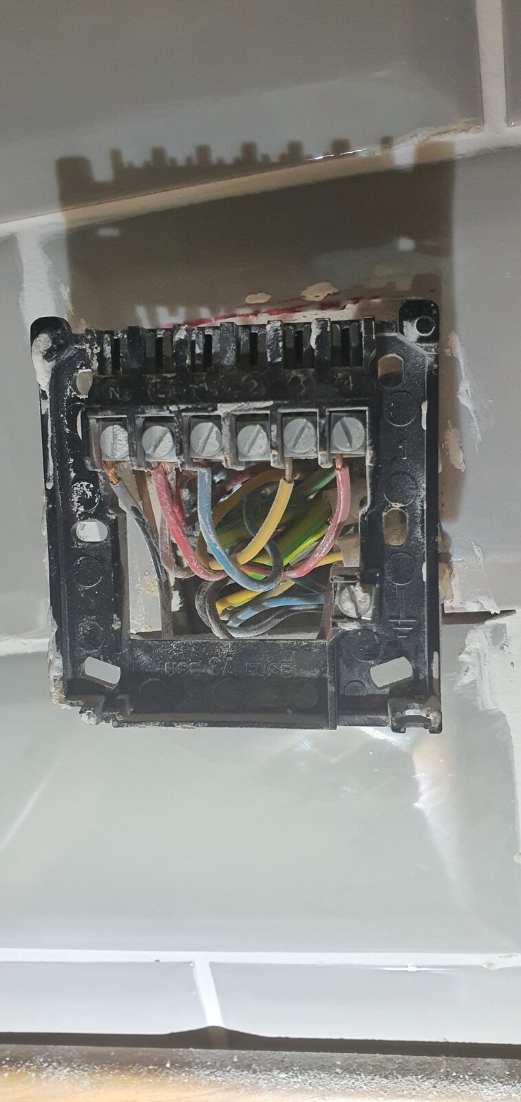

Yes to all, for future information you have a Y plan system, I would disconnect the neutral wire on the existing thermostat and isolate it, it is for a heat anticipator and uses a small amount of electricity, not a large amount but no point in heating it when it isnt doing anything
Thank you for confirming that. It is very much appreciated.
