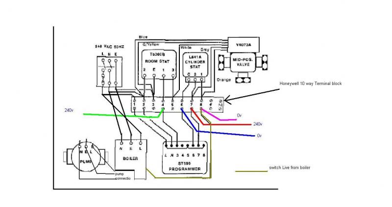

I have been following the Honeywell Y plan diagram to connect my system and it doesn’t seem to work properly. On the programmer (ST699) I slide the Hot water only button to cont. (continuous) nothing happens, boiler doesn’t fire up. Only when I turn the room thermostat the boiler will fire up and even if I slide the Hot water to off position the boiler is still working, to switch it off I need to turn the room stat to minimum position.
I have not tested Central Heating system as I found problem with the Hot water and didn’t want to cause any damage. So I need to isolate this problem before I move on :) I would really appreciate any help, and would love to know how to test with a voltmeter the cylinder stat, room stat so i can illuminate these from being faulty and what readings i should be getting across programmer terminal block and Honeywell 10 way block
Information of Hardware:
Boiler Glow-worm Ultimate 50FF
Cylinder Stat (no manufacturing marking),
Room Stat (no manufacturing marking), very old dial version, and 4 wires connection
Honeywell mid-position valve – v4073
Honeywell Programmer ST699
Honeywell 10 way terminal block
Wiring configuration:
Boiler
From the boiler L, N, E connected to 10 way Honeywell terminal block,
Boiler Live = Connects to Honeywell terminal block 8,
Boiler Neutral =Connects to Honeywell terminal block 2,
Boiler Earth= Connects to Honeywell terminal block 3.
Note: I have a one link across SL and 9 and second link across K1 and K2
Pump
From the pump the 3 wires L, N, E are connected as follow:
Pump Live = Connects to Honeywell terminal block 8{same as boiler live}
Pump Neutral = Connects to Honeywell terminal block 2 {same as boiler neutral}
Pump Earth = Connects to Honeywell terminal block 3 {same as boiler earth}
Programmer ST699
*Inside the programmer I got links across terminal 1-5-8
Programmer terminal L* is connected to Honeywell terminal block 1
Programmer terminal N is connected to Honeywell terminal block 2
Programmer terminal 3 is connected to Honeywell terminal block 4
Programmer terminal 4 not connected
Programmer terminal 5* Links to 1 and 8 inside the programmer terminal
Programmer terminal 6 is connected to Honeywell terminal block 6
Programmer terminal 7 is connected to Honeywell terminal block 7
Programmer terminal 8* Links to 1 and 5 insider the programmer terminal
Honeywell terminal block 10 Way:
Terminal 1 is connected to Live Load on FCU (Spur)
Terminal 2 is connected to Neutral on FCU (spur) + Room Stat blue wire + Mid-Position valve blue wire.
Terminal 3 is connected to Earth on FCU (spur) + Room Stat G/Yellow wire + Mid –Position valve G/yellow
Terminal 4 is connected to Programmer ST699 terminal 3 and Room stat (1) Red wire
Terminal 5 is connected to room stat (3) Yellow wire and also mid-position valve white wire.
Terminal 6 is connected to Programmer ST699 terminal 6 and Cylinder stat (Common) brown wire
Terminal 7 is connected to Programmer ST699 terminal 7 and Cylinder stat (2) G/Yellow wire and mid-position valve Grey wire
Terminal 8 is connected to Boiler Live(which goes back downstairs to the boiler terminal control box marked L) + Pump Live and Cylinder stat (1) Blue wire and mid-position valve Orange wire.
Terminal 9 is Not used
Terminal 10 is Not used
What I found conflicting and really confusing some Y-plan diagrams I read show that the pump Live goes back to the boiler marking P terminal in its control box( someting about over run was mentioned). And boiler has a permanent live feed to L. The SL is connected to mid-position valve orange wire and to cylinder stat terminal (1). Is this method correct?
off question, just for my reference, How do I find out what type of system is installed i.e. A gravity domestic hot water and pumped central heating system or a Fully pumped open vented system. How does one distinguish this. This is what i have fitted :
I have a tank in my loft and the pipes come down to my airing cupboard in the bath room where the cylinder, pump, mid-position valve, programmer ST699 and Honeywell terminal box is fitted and the boiler is fitted downstairs in the kitchen.
Thanks in advance

I apologise for the long detailed post, i wanted to describe what i have done as much as possible. Diagram i have been following is this
//www.diynot.com/network/Hunter2k/albums/1037/4098

After reading your recommendations I have now:
1.removed link from k1 and k2 from boiler control
2.wired the pump into the boiler terminal (P)
3.removed the link across SL and 9.
4.connected SL to the honeywell junction box terminal 8 which connects to orange wire of mid-position valve and Cylinder stat (1)
5.PERMANANT live,Neutral,Earth is connected to boiler now
If you are happy and confident using a multimeter, connect one lead to neutral connection having selected 250 volt ac range. Select HW on programmer. Terminal with orange wire should be live. This is the terminal that tells the boiler to run via SL connection. The valve does not move during this demand. Boiler is powered up through the cylinderstat. When HW water reaches set temperature, cylinderstat disconnects and boiler goes to standby.
When i select HW on programmer nothing happens, there no voltage across orange wire or cylinder stat (1).
Cylinder stat(2) + Grey wire mid-position valve has 240v.
Cylinder stat(C) has no voltage.
If i select programmer HW off i still get 240v across terminal 7 on the honeywell block.
* From the honeywell 10 way terminal block if i swap over wires 6 and 7 comming from the programmer then the boiler fires up and reaches it temp, then switches it off ( i guess its got its own internal thermostat) and my problem is when i select programmer HW off. The boiler will still be working after an hour.The programmer signal is not stopping the boiler to switch off. Could this mean i have a faulty programmer or a cyclinder stat ??
Please look at drawing,I have modifyed it and i have marked each contact with a colour to show what voltage value is across each terminal.
what voltages should i be getting out off the programmer ST699 and do the links look correct ?
try turning HW and CH off at prog - you should have 240v @ 1 & 7 in wiring centre. Measure from numbered terminal to neutral, and also to earth.
HW and CH off at programmer, i get 240v at 1&7 in wiring centre, which i measured from neutral and also to earth but i also get 240v at 4 in the wiring center.
are you sure you've got no wire in prog term 4 (double check it, dont just assume because you shouldnt have you wont have)
sorry m8, misunderstanding, the terminal 4 i am refering to is on the honeywell wire center (10 way block) which has a connection to prog terminal 3 and room stat terminal 1, this gives me the 240v and there is no wire in the prog terminal 4 - Not connected to anything as you rightfully stated.
disconnect the room stat wire from term 4 in wiring centre and test again, check both the wiring centre term4 and the disconnected wire.
Disconnected the room stat wire from terminal 4 in wiring centre, 240v is still present, on terminal 4 which traces back to prog terminal 3. Stat wire has 0v
Many thanx for all your help lads, the boiler is all singing an dancing now :D
