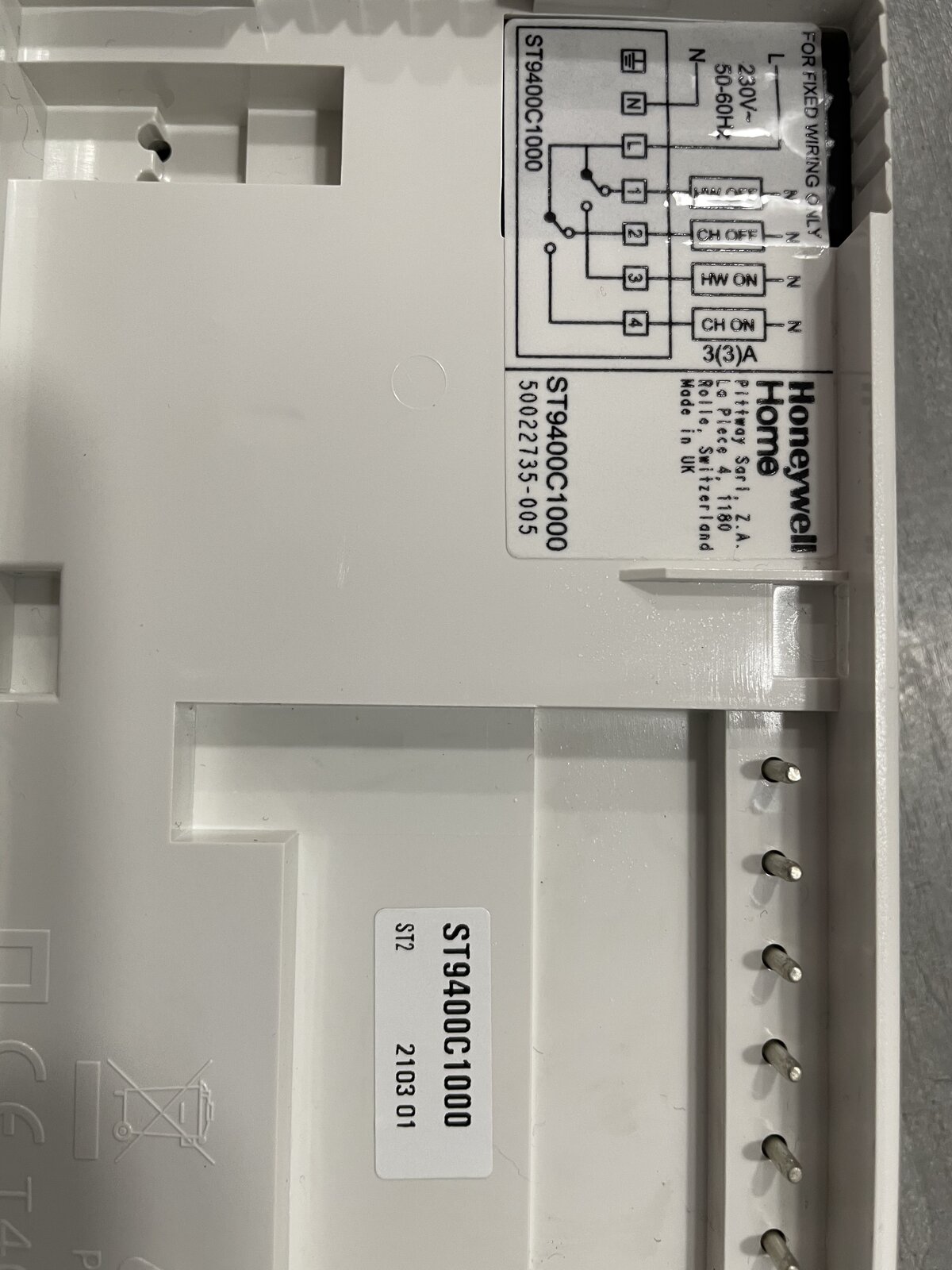

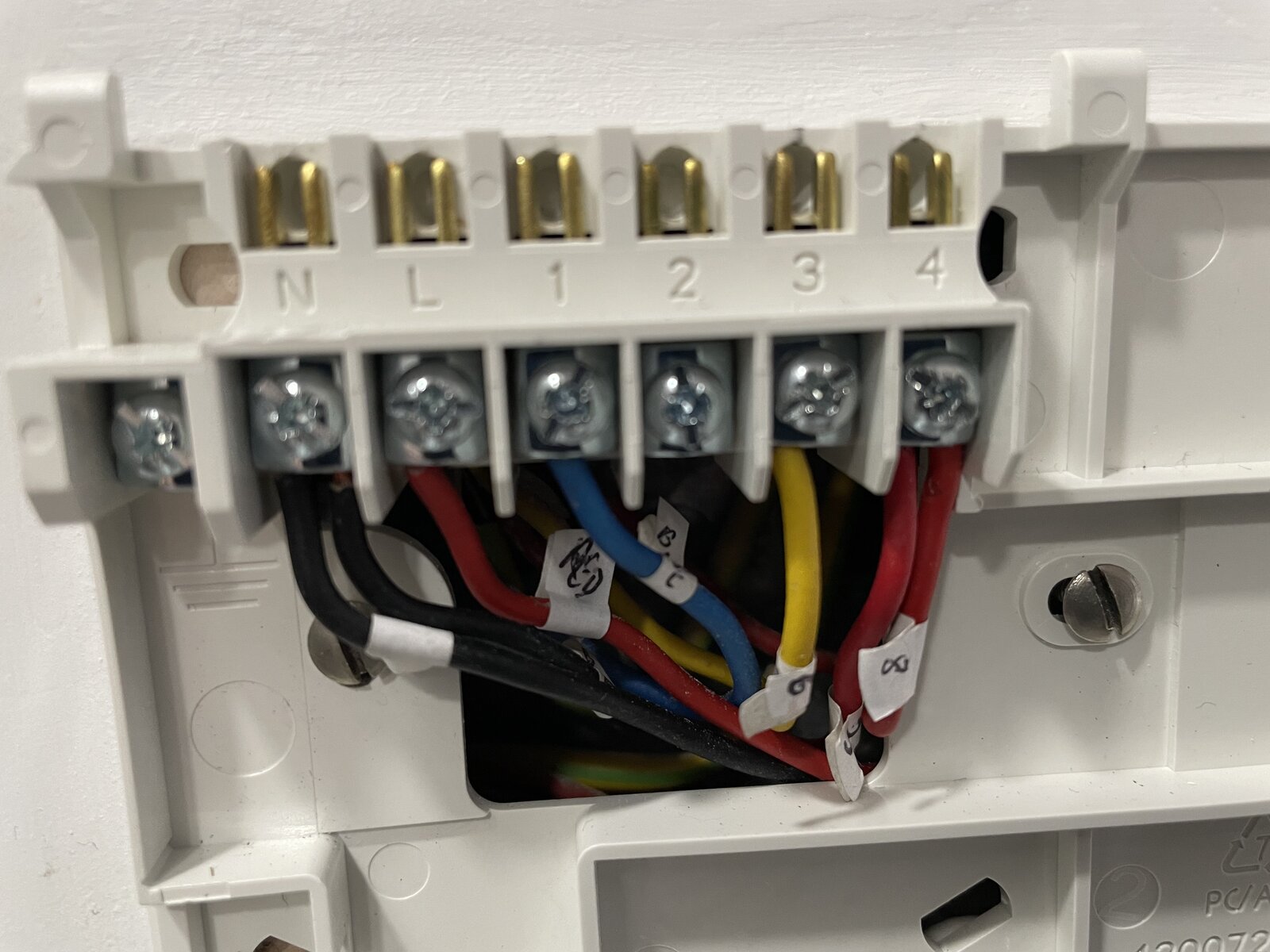

Hi, I recently replaced a 27 year old Honeywell ST699 Programmer with a new ST9400c. Whilst system delivers Heating and Hot Water, it will not deliver Hot Water when HW only is selected (despite green LED being illuminated) i.e. boiler does not fire. My wiring changes were as follows:
ST699 9400c
1 Live To L (Red)
2 N ——- N (Black)
3 ——— 4 (Red)
4 was empty
5 - 8 Link was discarded
L - 5 Link was discarded
6 ——- 3 (Yellow)
7 ——- 1 (Blue)
8 ——- 4 (Red)
I suspect that the Red wire from terminal 8 on ST699 to terminal 4 on ST9400c may be the problem, but not absolutely sure which terminal it should go to on 9400c. Can’t find on-line where to move Red wire at terminal 8 on St699. My system comprises 8 year old Bosch Worcester boiler, Drayton MA1 Mid level valve, new Honeywell DST90E room therm. Any advice would be appreciated.
Can you post a photo of the wiring? Visual is easier for me.
From one to the other,

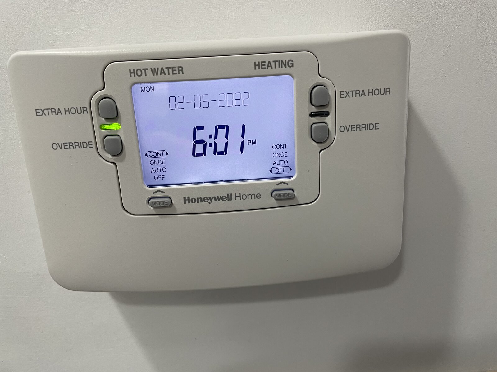

Thank you CBW for responding. Photos of existing wiring on ST94000c and display with HW on ‘constant’ selected. Apologies, I meant Drayton Mid Motorised Position valve. Note: the numbered labels are as they were connected on ST966, with T8 connected to T4 on St9400c.
Thank you denso13. I found this online, but it doesn’t tell you what to do with wire at old T8. I tried not connecting (isolating) the wire and not connecting to ST9400c, but then I couldn’t even get Central Heating (and no Hot Water)!
It seems the wire from T8 is doing something when connected to the new T4 as it allows the CH to function and I get some hot water even when HW is ‘Off’.
Thank you johnmdc. Can I confirm that this will give me two wires at Live on new programmer?
johnmdc, that’s absolutely brilliant and thank you for your help. Everything is working correctly now. I can’t believe it was that simple.
