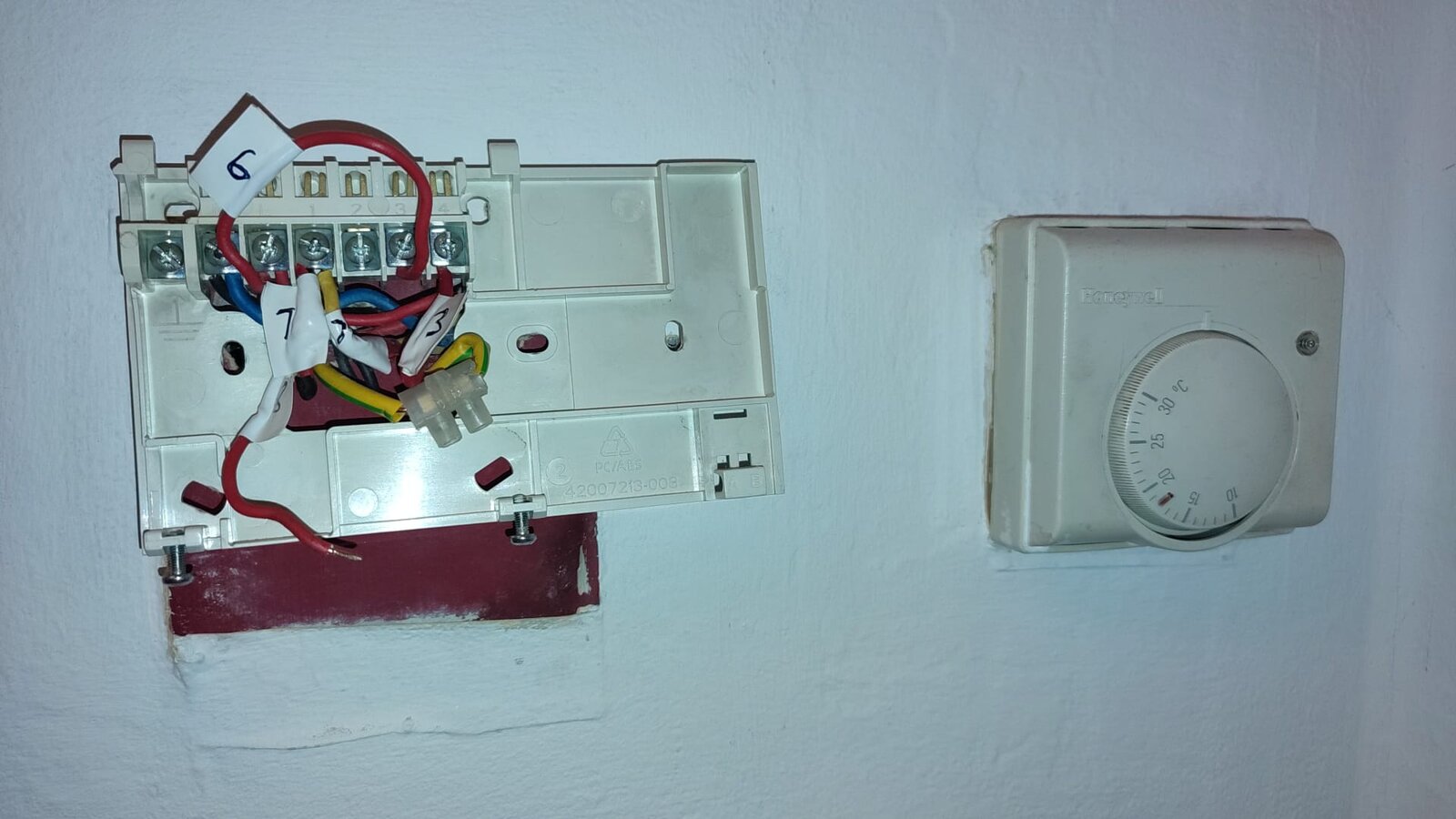

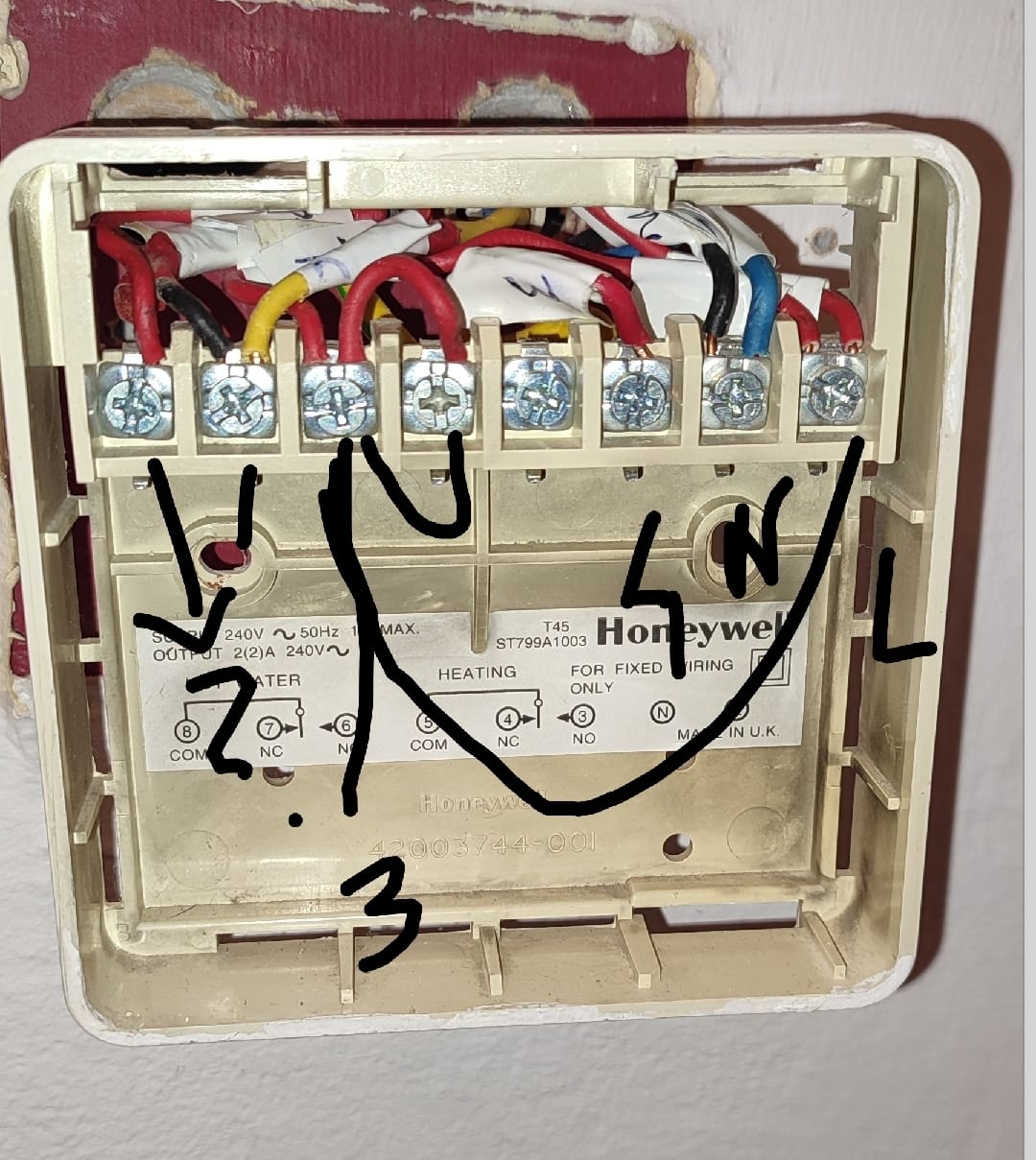

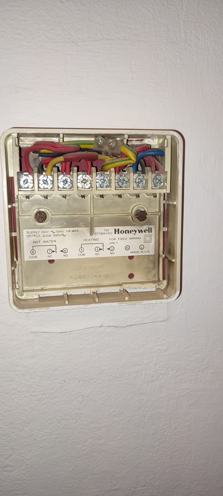

Hi, All I am replacing below ST699 (currently connected with Thermostat and Kingfisher Potterton Gravity boiler) with ST9400C . Need some help with Wiring Diagram.
Currently
There is a loop between 5 & 6 >> This need to be discarded ?
From L there is loop to 6 >> Should I use feed from L to connect to 3(in ST9400C) ?

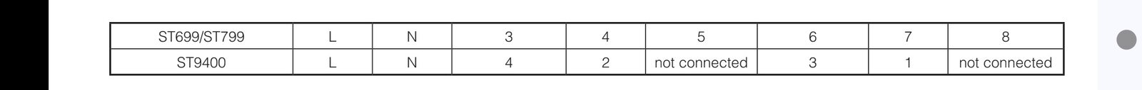

While swapping:
ST699 - ST9400C
L - L
N - N
3 - 4
6 - 3
7 - 1
8 - What should I do with this ?

In the St699 I see a black wire in with the yellow for hot water off, I can't see it in the new photo. Can you take a clearer photo? All demands calling?

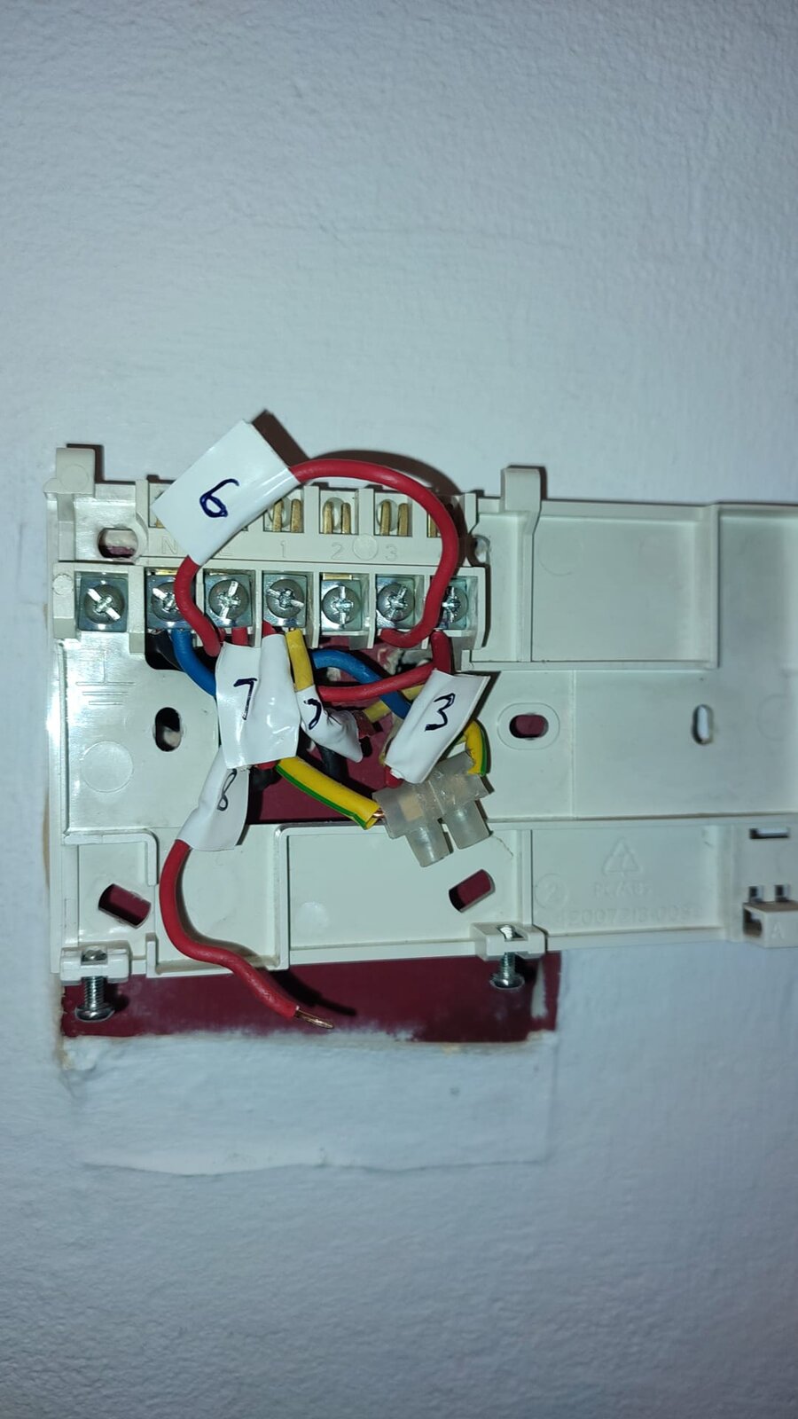

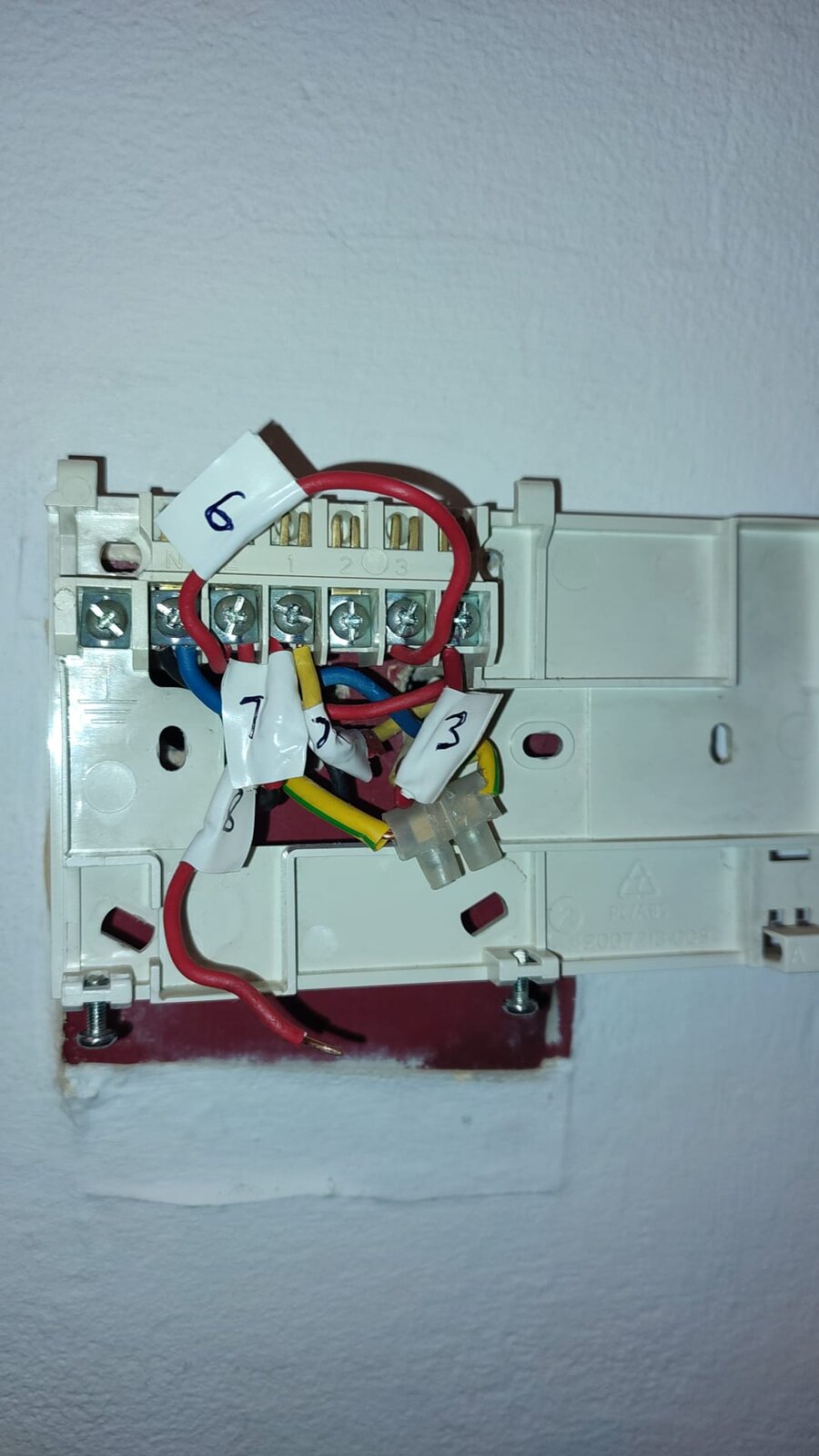

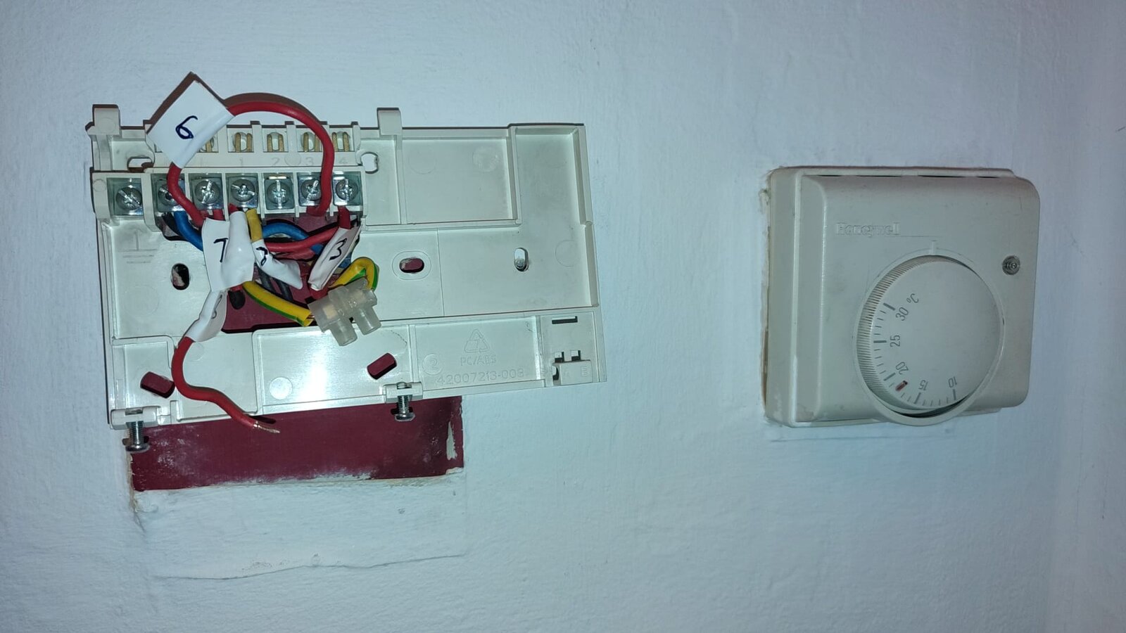

Hi, Just to make sure I have not mixed up the wires, I have connected with old unit ST699 and both heating and water works. Below is the wiring diagram with numbers corresponds to where they will go in ST9400.
- There is a loop between 5 & 6 >> This need to be discarded ?
- From loop from "L" to 6 >> Should I use feed from L to connect to 3(in ST9400C) ?
- 8 >> What should I do with this ?
Yes as the internal parts provide this
No, not required
If it's fed from L, it should be a link and disregarded

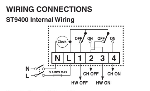

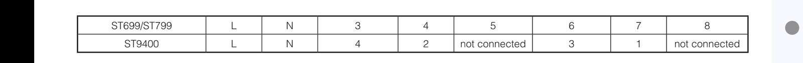

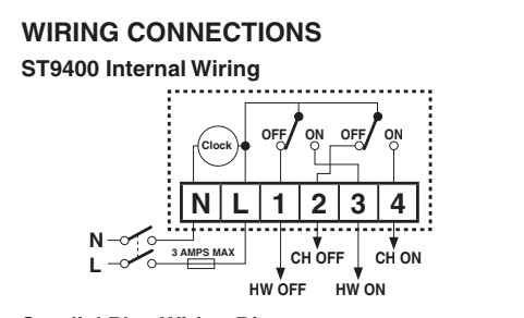

It's in the instructions that @gas112 provided. I have screenshot this and cropped to help minimise confusion and hopefully make it easier
No, not required

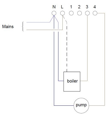

There should be 3 cables entering the programmer, but you need to confirm where they go. I have come across all sorts of bizarre wiring arrangements in the past. I would expect to see.
1. Mains Supply
2. Cable to Boiler
3. Cable to Pump
Once you have identified the cables
1. The mains supply is quite obvious N & L
2. The Live in the cable to the boiler goes to HW On (3)
3. The Live in the cable to the pump goes to CH On (4)
The earths and neutrals of all the cables are connected together respectively. (earths omitted for clarity below :) )
Some boilers require a permanent live (shown by the dashed line) if yours needs it, it will be connected already and shown in the boilers installation instructions.
I suspect the pump cable will contain a live wire that originally went to ST699 'Heating On' (Terminal 3) and the cable to the boiler will have a live wire connected to 'HW Com' (Terminal 8.) But check to make sure.

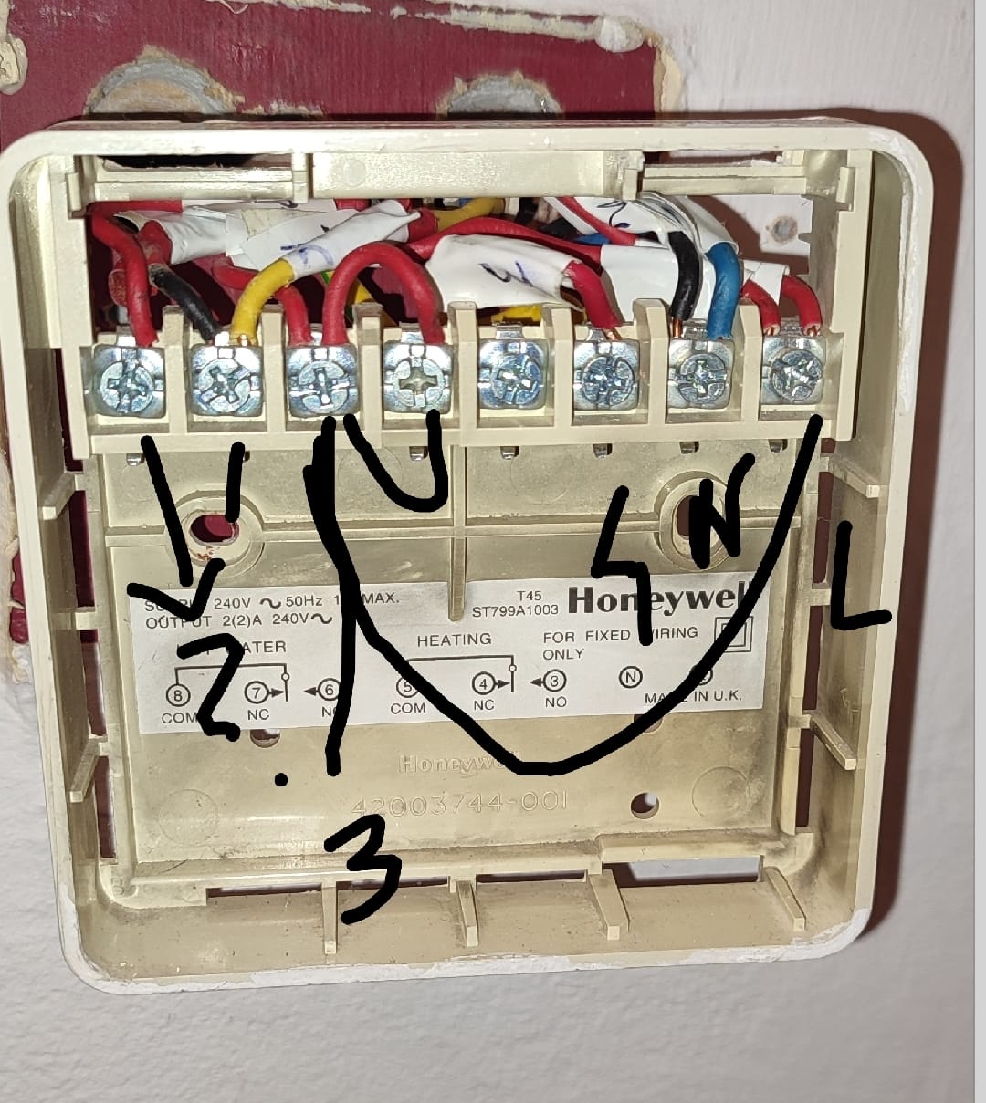

Hi, Since Last time my existing ST699 worked after cleaning terminals, now it's not working. I have attached complete wiring diagram. Can someone please confirm if it's correct.
