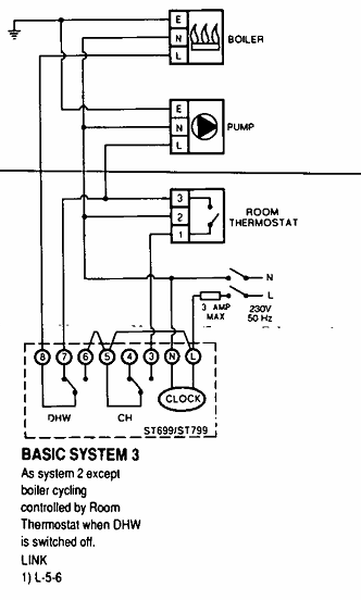

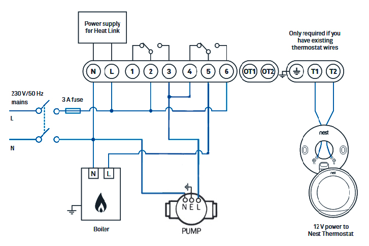

Hi DP, Is there a way where I can use ST9400C where I just need thermostat and Boiler & pump functionality as currently working OR even with limited capability. Also found diagram of my installation.Thx
Hi DP, Is there a way where I can use ST9400C where I just need thermostat and Boiler & pump functionality as currently working OR even with limited capability. Thx
As far as I can comprehend, your programmer limitations is due to the fact that C terminal connections is internal. This setup is ideal for fully pumped. For gravity you need access to C terminal. St9100 gave you access to all the terminals but that programmer is now discontinued
Gravity hot water is also old hat and prone to boiler recycling ( wasteful) needlessly. As a stop gap fit a motorised valve and thermostat on the cylinder which will give you the facility you are after or ditch the ST9400 and get the set I mentioned earlier
I suspect using a 3 pole relay and ST9400 might give you what you need. Will need to look at that option.

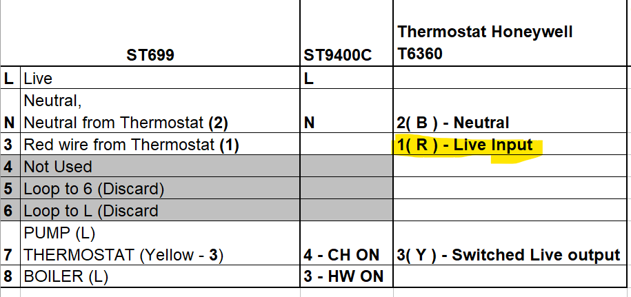

Hi DP/ @stem ,
I can do the basic plumbing & electrics but not expert enough to install motorised valve.
Please see the link below where someone is able to successfully able to configure with my setup (except Thermostat) with Mini Programmer settings.
The only thing which I need is
In ST699
7 (Yellow from Thermostat + Pump Live) - do I need to connect to Terminal 4 (in ST9400C) ?
Red wire from Thermostat (currently in 3- Where it will go ?
For the time being I don't mind if CH on then HW also on as system is working for many years (agree it's a waste of energy, which I need to probably fix later )

In that case HW NO to boiler and CH NO to pump
Switch hw zone will fire the boiler to heat water
To get heating hw will need to be on also
Thanks , Is below correct and how do I feed 1- Live input to Thermostat
