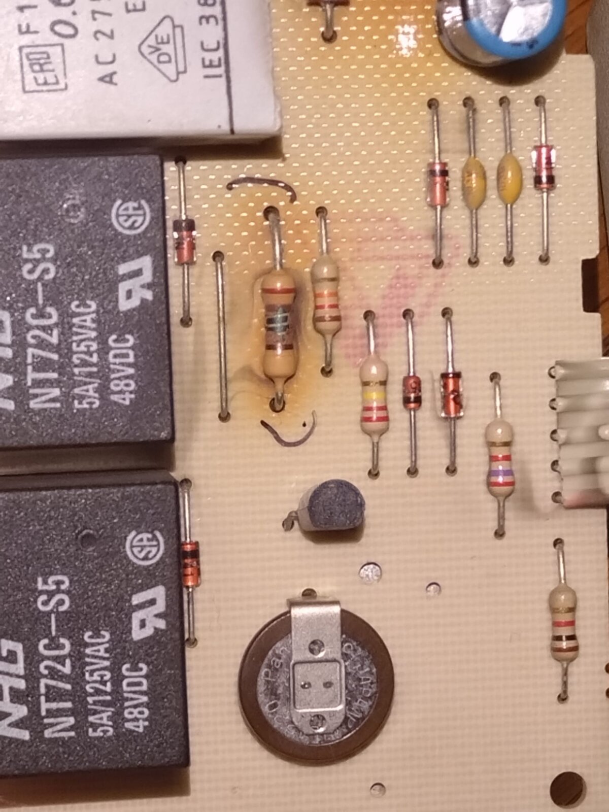

Hi All
Posting here as it's the latest post on the Honeywell ST699 Dual Zone Central Heating Timer.
Wondering if anyone knows the resistor value that sits next to the wire link on the PCBA. It's the largest resistor on the board, unfortunately mine is blown so I cannot see all the identifiers clearly. Please see attached picture, resistor indicated in black brackets.
Appreciate any help, with thanks.
